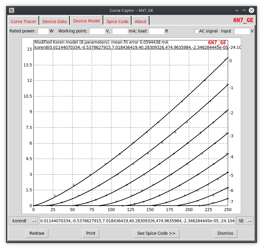

Here's one I made with Curve Captor back in 2007:
Might we talk Adrian into modelling one for us...? 😉
Code:
* 6N7_GE Twin triode power amplifier LTSpice model
* Modified Koren model (8 parameters): mean fit error 0.0594438mA
* Traced by Wayne Clay on 9/6/2007 using Curve Captor v0.9.1
* from General Electric data sheet
* Note: Positive grid region not modeled
.subckt 6N7 P G K
Bp P K I=
+ (0.01144070334m)*uramp(V(P,K)*ln(1.0+(-0.5378627915)+exp((7.018436419)+
+ (7.018436419)*((40.28309326)+(474.9635984m)*V(G,K))*V(G,K)/sqrt((-2.346284445e-05)**2+
+ (V(P,K)-(-24.10402862))**2)))/(7.018436419))**(1.29012841)
Cgk G K 3.0p
Cpk P K 2.5p
Cgp G P 4.5p
Rpk P K 1G ; to avoid floating nodes
d3 G K dx1
.model dx1 d(is=1n rs=2k cjo=1pf N=1.5 tt=1n)
.ends 6N7_GE

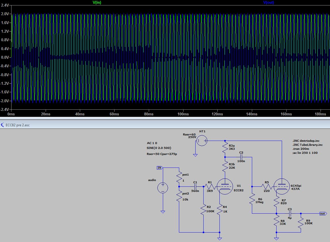

Thanks Ron, appreciated. They take some time to settle when used for the first time, a couple of hours should do it. I'll pick the model with the nearest gm.This is everything I've collected for 6C45P (6S45P). I understand the tubes themselves have quite variable characteristics, which would make it difficult to create a one-size-fits-most model. Hopefully one of these models will work well enough for you.
Something to worry about? And, is there a model around for 6C45pi?
33k cathode resistor for 6S45P is just wasting it's potential. It is best at anode current 20 mA and more.
Yup, just replaced it with 1K. How about the graphic, the dark figure resembles an audiofile. Some sort of oscillation?33k cathode resistor for 6S45P is just wasting it's potential. It is best at anode current 20 mA and more.
