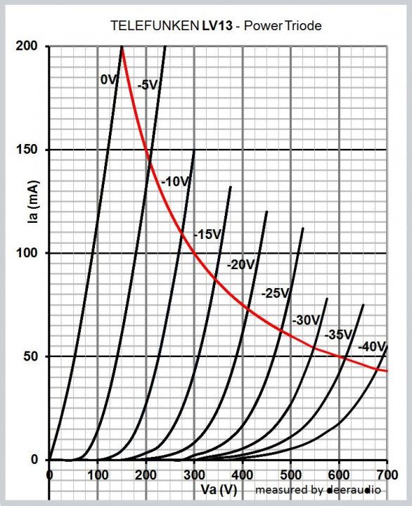

I'm looking for the LV-13 spice model.
Deutsche Militärröhren und Fassungen - LV13
http://www.jogis-roehrenbude.de/Roehren-Geschichtliches/Mil-Roeh_Fassg/LV13/LV13.pdf

I have a just born LV13 LTspice model for you! 😀
The problem is: There are no traces for negative Vg available in the web. So the parameter kp, which mimics the important island effect, has to be guessed.😕
If you perhaps own this tube: Would it be possible to measure at which Grid voltage the plate current reaches 60mA @ Vp=500V?
That would help a lot to set a suitable value for kp.

Hi euro21,
wow, a hole bundle of curves - thats much better than just one measured point! 🙄
The measured sample of your friend seems to have burned quite a long time, because its plate resistance has already increased to 166% of its starting value (assumed that it was first according to the datasheet)
Furthermore, the Mu of the sample is 25% higher than the datasheet, but that is in the normal tolerance range.
So, I have now pos.Vg traces from a datasheet and neg.Vg traces from a measured sample with quite different mu and plate resistance - how to merge this two worlds ?? 😕

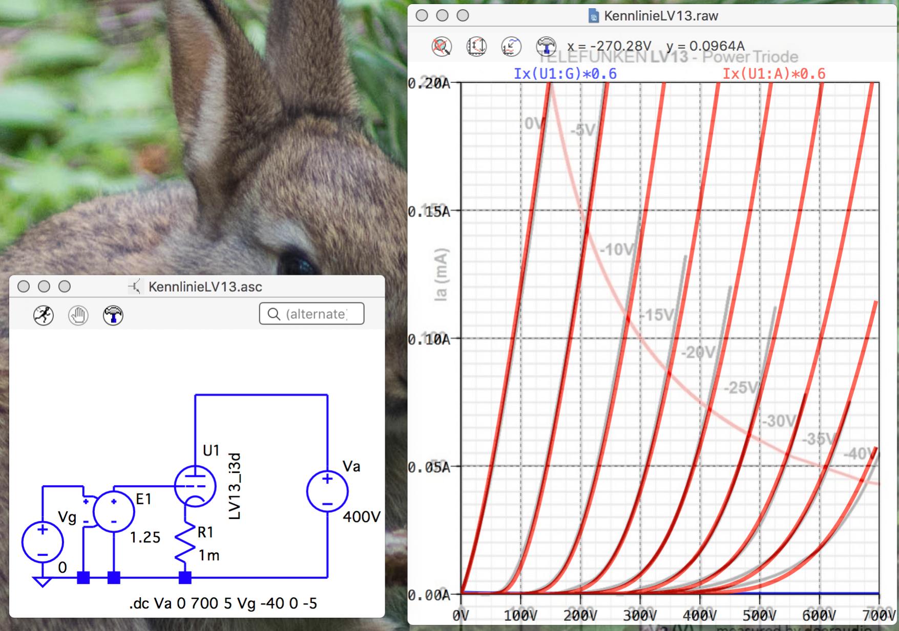

I decided to take the model gained from the data sheet, adjust the plate resistance manually by a adjustment factor in the LTspice graph window (and a similar way for mu adjustments) and then did the island effect fine-tuning. See attached graph.

The reason for the E1 is to adjust the both Mu factors, from my datasheet based model and from euro21's LV13 sample. That opens a way to determine the parameter kp (which describes the island effect at high negative Vg), because kp cannot be determined from the positive Vg datasheet traces.
I've never seen that symbol in ltspice, so I was curious about it. How di you underlay datasheet graph under your spice graph window? Is it ltspice you're using, or some other software?
Yes I use LTspice. There are several possibilities to overlay data sheet traces. I use LayerX on my Mac, and Chaos Crystal on my windows laptop.

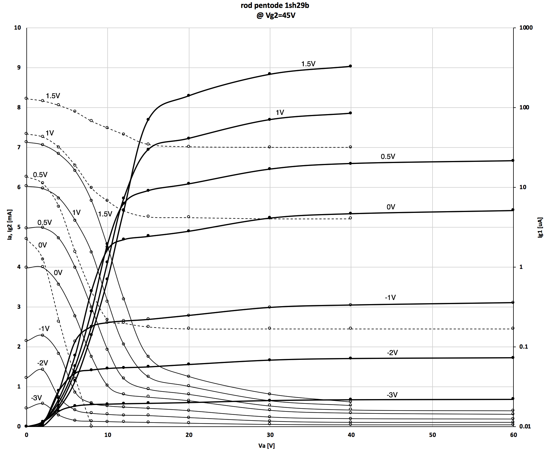

Hi all
As the data sheet of the 1sh29b has a bit weak data in its diagram, here some measured curves from a sample of mine. I took the best of several tubes that is closest to the data sheet.
So, tube spice modeling may start on better data...
all the best, Adrian
