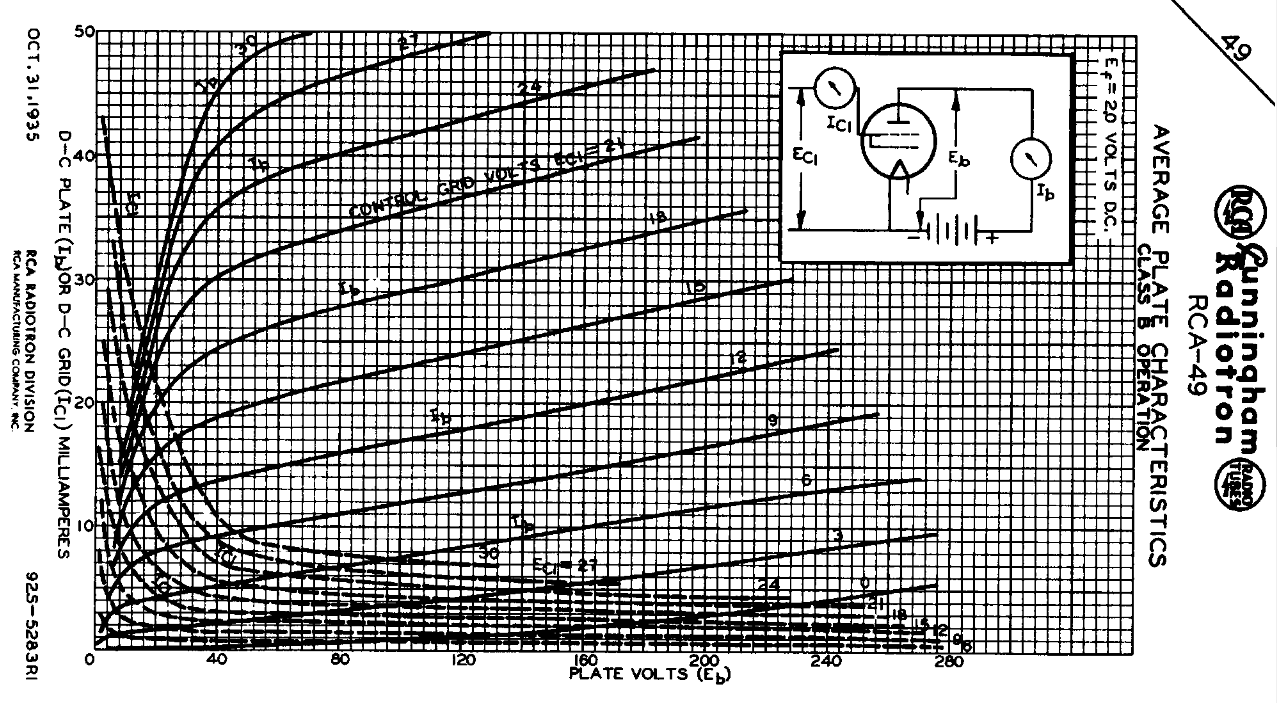

I've attached tetrode and triode curves as well.
The 1st curve above is not a true tetrode plot as it has g1 and g2 connected together as one input and tube is biased or driven up to +30v. The correct way I think is to generate a true tetrode wi model from the triode curve (2nd curve) with bias start from 0 volt and then connect g1 and g2 and plot the curve to see it matched 1st curve. And also the screen current in true terode model can be re-adjusted so it matched with screen current of the 1st curve. Ayumi tool could be easier then paint tool. The other curve shown is type 47 not type 49 not sure what the screen g2 voltage reference is in use.

I made a mistaken assumption. Type 49 is not a tetrode at all, it's a low power 'Dual-Grid Power Amplifier' designed for either Class B use with g1 and g2 tied together (held at 0V, I think) or Class A triode use with g2 tied to the plate and g1 used as the control grid.
I think the 49 looks most interesting as a standard class A triode (second curve, g2 tied to plate). Low mu of only 4.7 could be used as a line stage, and the triode curves look quite linear. Gm is pretty low, but maybe with a source follower on the output? Internal rp of about 4.2k ohms isn't so bad.

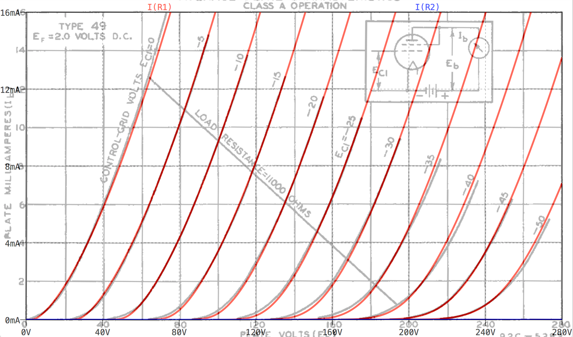

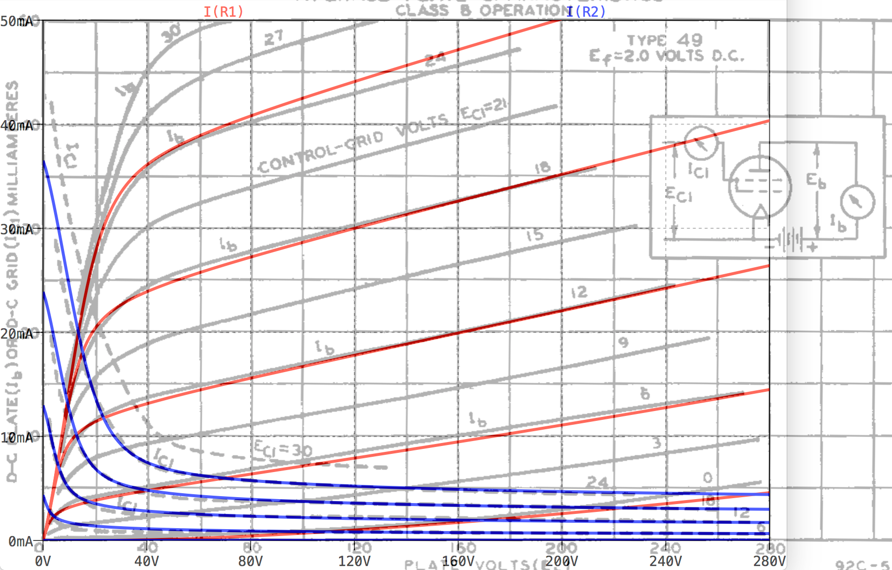

I have a freshly baked 49_i2 tetrode model for you! 😀
It is by the way the premiere for my generic tetrode model, and I'm quite happy how god it fits. 🙄
As my model consist of 94 lines of code, it seems to me better not to insert it on this forum... So, please download it here:
http://adrianimmler.simplesite.com/440956786
all the best, Adrian
