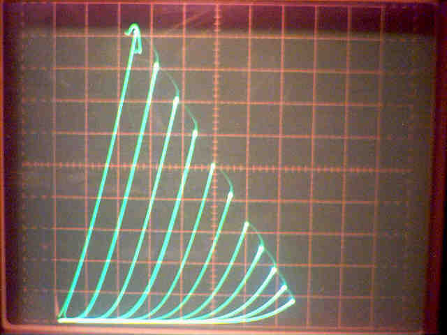

6HB6, anyone?
It's not in Ayumi's pctube collection. I googled for it, nothing came up. So... Anybody here ever played with this one?
http://www.nj7p.org/Tubes/PDFs/Frank/135-GE/6HB6.pdf
And... Triode curves! I hope these are good enough.
10 mA/div vert., 50V/div horiz., g2 100V, 1.4V steps on g1, g3 0V
http://www.diyaudio.com/forums/atta...-suppresor-grid-used-feedback-6hb6_triode.jpg
