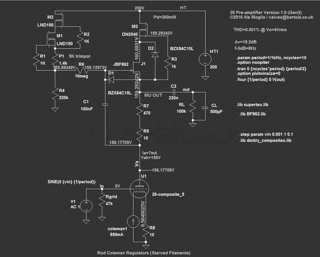

Try reverse the direction of R66. I found that long ago, not sure why the current phase is reversed.
Edit: in other sim, it shows the direction when you bring the cursor over the components, so please note.
You are right.just reverse the direction of R66.the current phase change to correct.thank you.
has fixed this issue.you are right.my fault.You may want to check the LTSpice manual wrt the current flow convention.

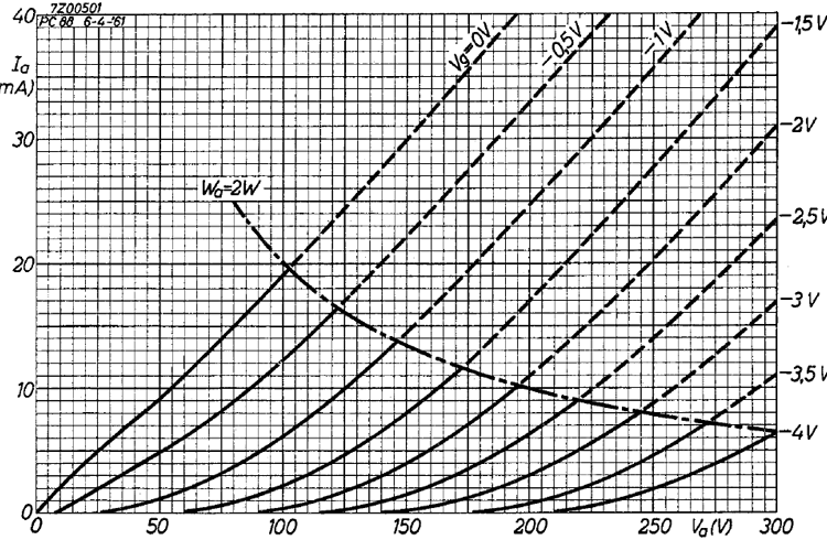

here is the datasheet file.
http://www.tubebbs.com/tubedata/sheets/030/e/EC88.pdf
http://www.tubebbs.com/tubedata/sheets/030/e/EC86.pdf

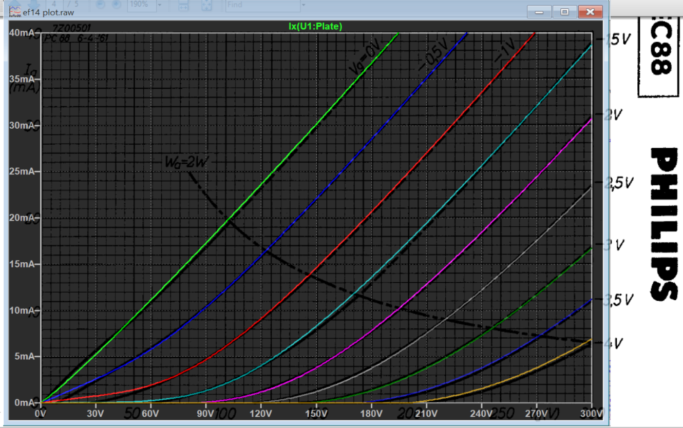

This model is traced by me using CurveCaptor, Koren8 model, pretty close, maybe you like to use it, there is more than one way to get the model, included also the marker and data file for reference.
* ec88 LTSpice model
.subckt ec88 P G K
Bp P K I=(0.1271584816m)*uramp(V(P,K)*ln(1.0+(-0.08785188791)+exp((2.922603012)+(2.922603012)*((70.68877455)+(-2844.697934m)*V(G,K))*V(G,K)/sqrt((66.12972009)**2+(V(P,K)-(34.81182848))**2)))/(2.922603012))**(1.087629465)
Cgk G K 3.8p ; added
Cpk P K 0.055p ; added
Cgp G P 1.7p ; added
Rpk P K 1G ; to avoid floating nodes
d3 G K dx1
.model dx1 d(is=1n rs=2k cjo=1pf N=1.5 tt=1n)
.ends ec88

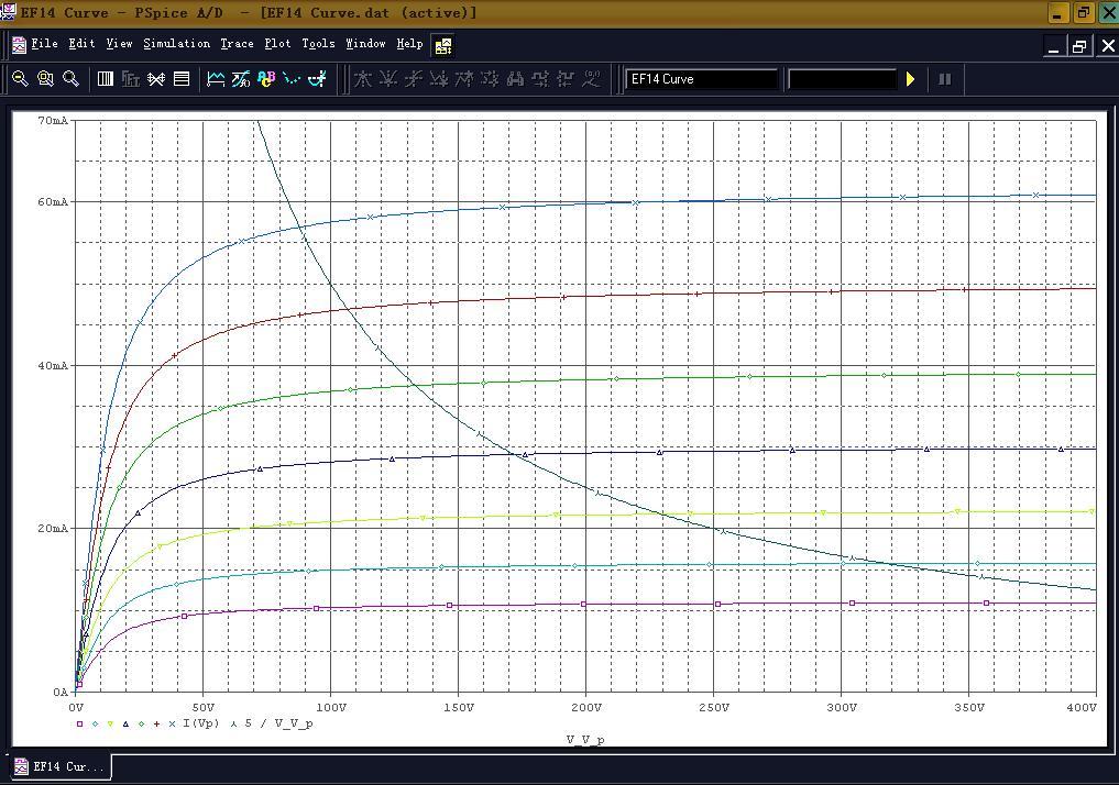

Here is the EF14. it worked well in PSpice

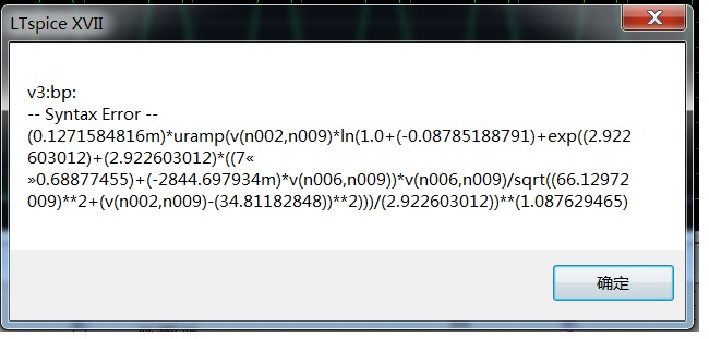

I tried to use this model,but got an error.please refer to attached screen short.
May be some formatting issue, try this one: LTSpice tube models
Yes,thanks jazbo8,this model no error fond.it work fine.
I paste the wrong one, this one is working on pc, saved to a file.I tried to use this model,but got an error.please refer to attached screen short.
