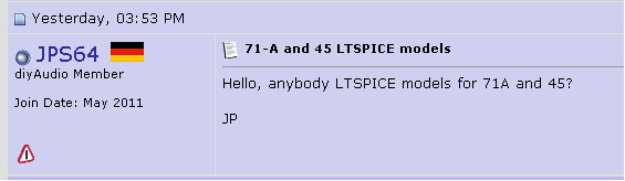

For colleague <JPS64> maybe it's helpful:

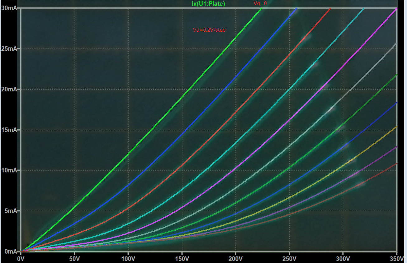

CX-301-A's are the same as RCA UX-201-A's or any other tube with an 01A suffix.

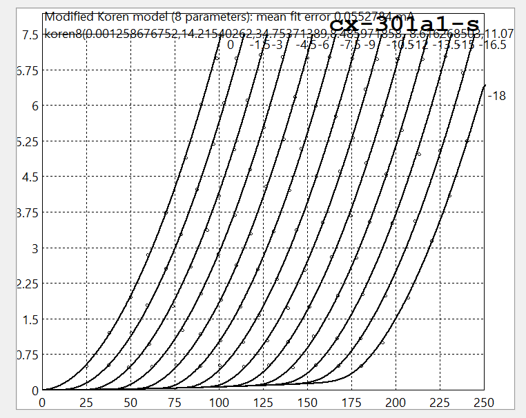

* cx-301a LTSpice model
.subckt cx-301a P G K
+ params: ccg=3.1p cgp=8.1p ccp=2.2p rgi=1000
Bp P K I=(0.001258676752m)*uramp(V(P,K)*ln(1.0+(14.21540262)+exp((34.75371389)+(34.75371389)*((8.485971858)+(-8.616268503m)*V(G,K))*V(G,K)/sqrt((11.07009574)**2+(V(P,K)-(2.05875447))**2)))/(34.75371389))**(1.88212582)
rcp 1 3 1g
c1 2 3 {ccg}
c2 1 2 {cgp}
c3 1 3 {ccp}
r1 2 5 {rgi}
d3 6 3 dx
.model dx d(is=1n rs=1 cjo=1pf tt=1n)
.ends cx-301a

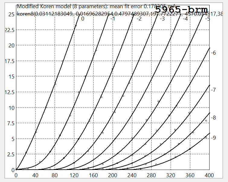

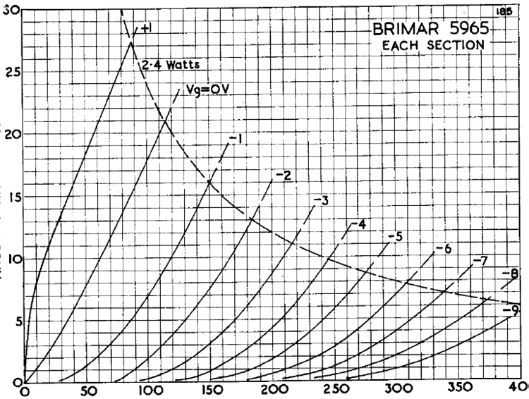

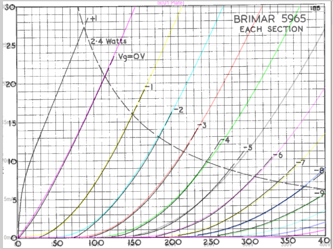

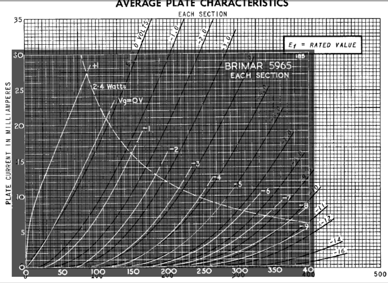

5965 is similar, but is supposed to 'sound better', which implies that it is different.
Attached 12av7-ge vs 5965 Brimar, only one is close i.e. Vg=0, so here is the model.
* 5965-brm LTSpice model
.subckt 5965-brm P G K
+ params: ccg=3.8p cgp=3p ccp=0.5p rgi=1000
Bp P K I=(0.03112183049m)*uramp(V(P,K)*ln(1.0+(-0.01696282954)+exp((0.4797489307)+(0.4797489307)*((191.7722271)+(-4570.034317m)*V(G,K))*V(G,K)/sqrt((38.68534305)**2+(V(P,K)-(20.90183057))**2)))/(0.4797489307))**(1.20117455)
rcp 1 3 1g
c1 2 3 {ccg}
c2 1 2 {cgp}
c3 1 3 {ccp}
r1 2 5 {rgi}
d3 6 3 dx
.ends 5965-brm

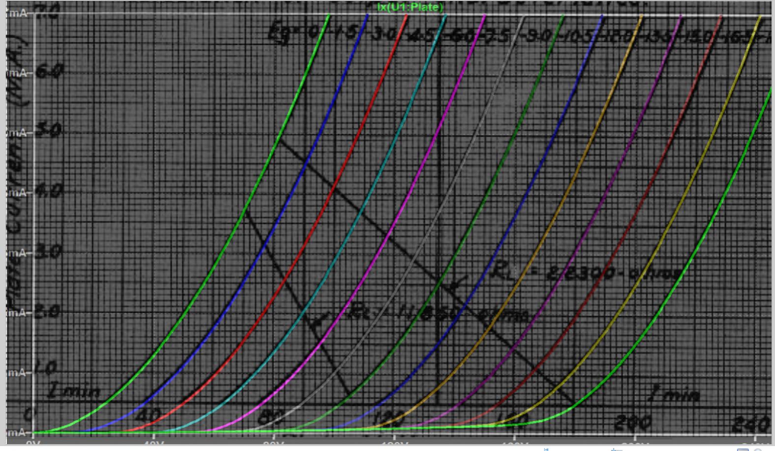

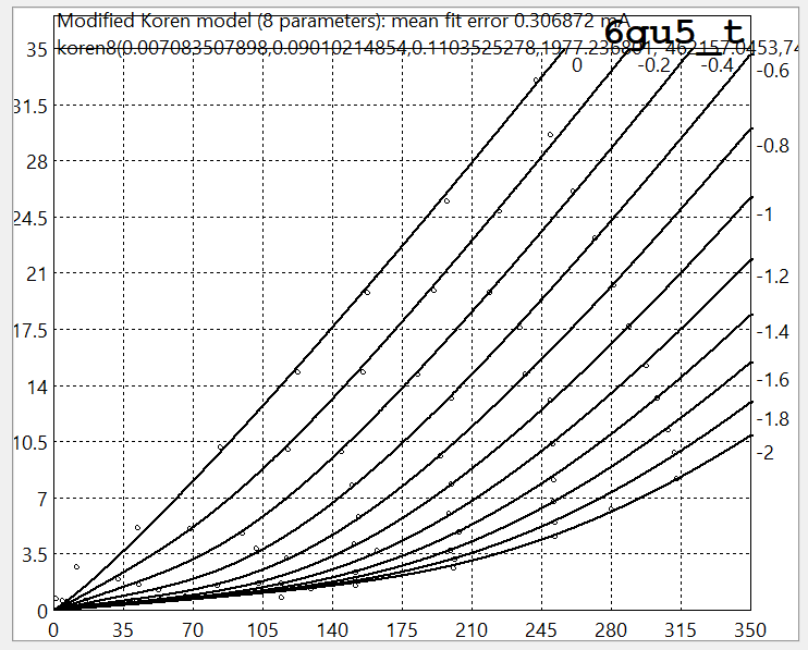

Based on the above 6gu5 triode trace I'am able to trace triode model:
* 6gu5_t LTSpice model
.subckt 6gu5_t P G K
+ params: ccg=7p cgp=0.018p ccp=3.2p rgi=1000
Bp P K I=(0.007083507898m)*uramp(V(P,K)*ln(1.0+(0.09010214854)+exp((0.1103525278)+(0.1103525278)*((1977.236801)+(-462157.0453m)*V(G,K))*V(G,K)/sqrt((74.8365736)**2+(V(P,K)-(51.3568144))**2)))/(0.1103525278))**(1.1312325)
rcp 1 3 1g
c1 2 3 {ccg}
c2 1 2 {cgp}
c3 1 3 {ccp}
r1 2 5 {rgi}
d3 6 3 dx
.ends 6gu5_t
