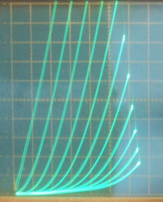

Even though Eg = 0V lines up well, the spacing for the rest of the grid steps are all over the place, what might account for such behavior? Could it just be the WIDE manufacturing tolerance?!
Second tube (Eg2 = 120V):

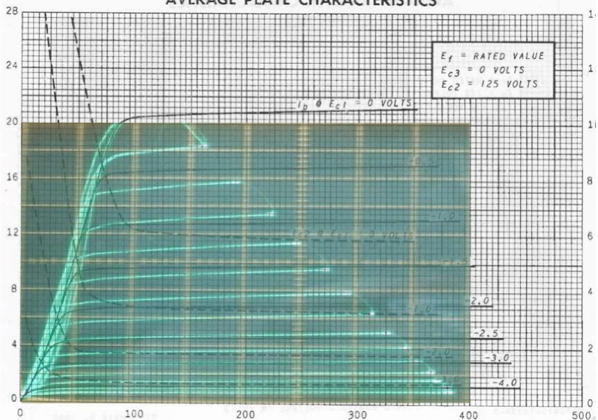

If I put a ruler across the tube 1 plate curves above (post 1482 pic 1) at about 150V and 10 mA I get 1 mA variation across 5 horiz. divisions (5 x 50V), giving 250K Rp. If I do the same with the GE datasheet curves, I get 1 tiny division (0.4 mA) per 300V, giving 750K Rp! About 3X what the datasheet states (280K). I'd say that datasheet has some kind of problem. Probably someone used a ruler to draw the curves.
Take a look at the 6HJ5 datasheet curves below, obviously fake too.
The real 6HJ5 curves on the right:
Someone couldn't be bothered with taking all the real datapoints, they just put a ruler across.

Usually the data sheets are "prettied up" somewhat if not accurate. Leaving out screen grid current dips for example.

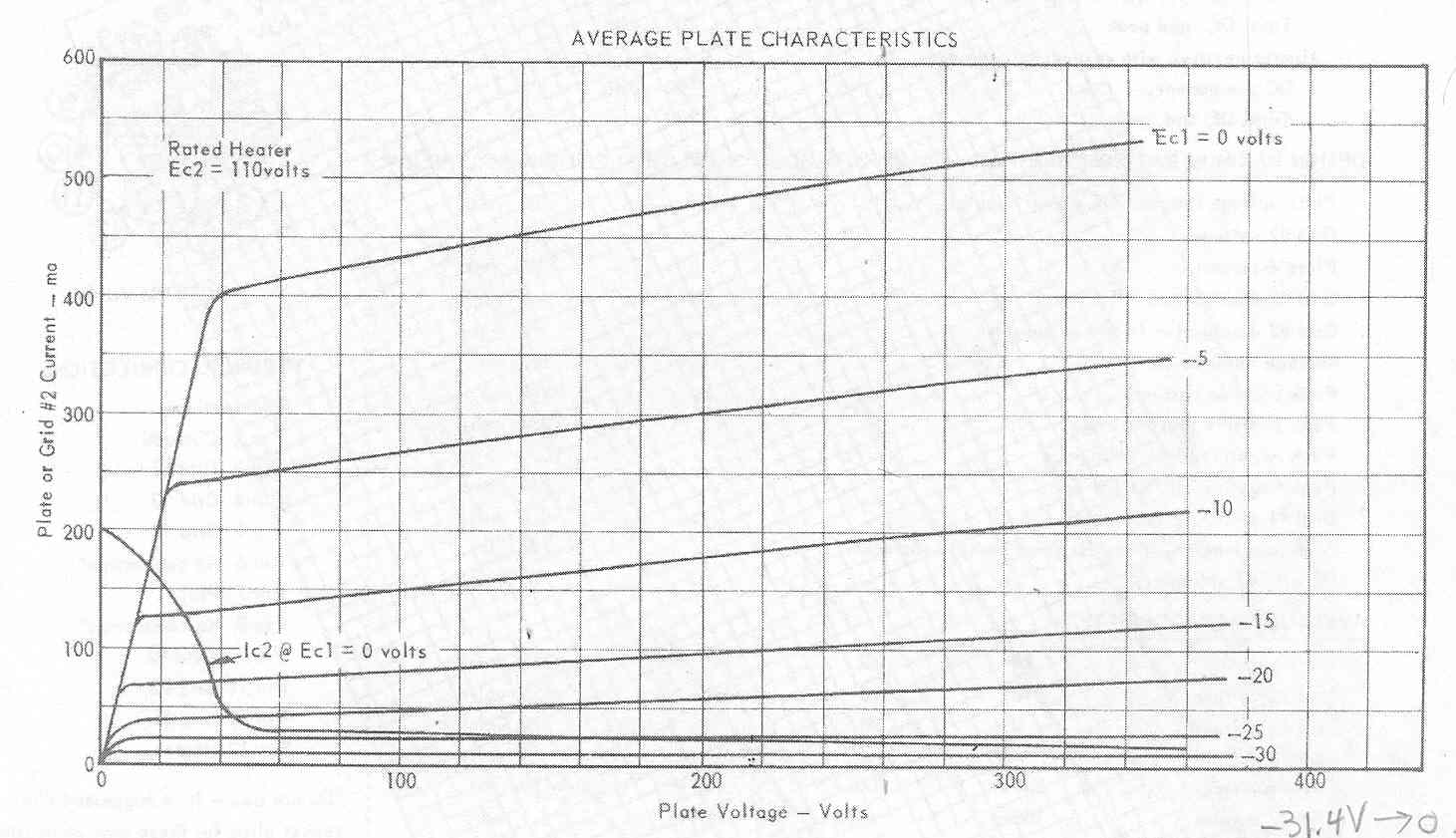

RCA data sheets (and anyone's sheets who copied them, like GE's 6CB6A) seem to often have poor quality curves. Some of them are even worse than the tube though! Like the 6LZ6 below for Vg2 curves. (too big a gap between 75 Vg2 and 100 Vg2, some of the knees look fake too)
Or Sylvania's 6LR6 datasheet. That one has got a 160 Vg2 curve, instead of the 150 Vg2 that should be there (but still labeled 150 Vg2).
Many others around with ruler flat curves. You can even see the mis-aligned joint between the ruler section and the French-Curved section on some.
http://tubedata.milbert.com/sheets/049/6/6LZ6.pdf
Trust but Verify. I'll believe the curve tracer of course.
Of course there is considerable production variation across tubes of a given type. And across manufacturers. Especially grid alignment accuracy affecting screen grid current dips in the plate curves.

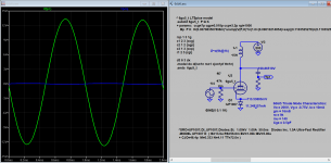

The following is copy from Steve schematic, but since it has unbpassed Rk, the stage gain is then never equal to 140. Not sure what actual plate and cathode current as it's not leveled.
Mu 140 refers the following data which is operating points we want to verify against, not his schematic Vg=0.92V.
In my schematic it's probable that Mu is very close to stage gain since SIM value is quite close.
6GU5 Triode Mode Characteristics:
Va = 200V, Vg = -0.75V, Ia = 10mA
gm = 16mS
ra = 9k
mu = 140
Cga = 0.5pF
Ex-Moderator
Joined 2011
That's the whole point, Bench's triode model is quite different from yours... In his sim, the stage's gain is "slightly over 100" - so a 40% difference from yours. No matter how you look at it, the two SPICE models as well as the triode curves that were used to generate them are not in agreement. All this is made worse because there isn't really that much data given for the 6GU5.

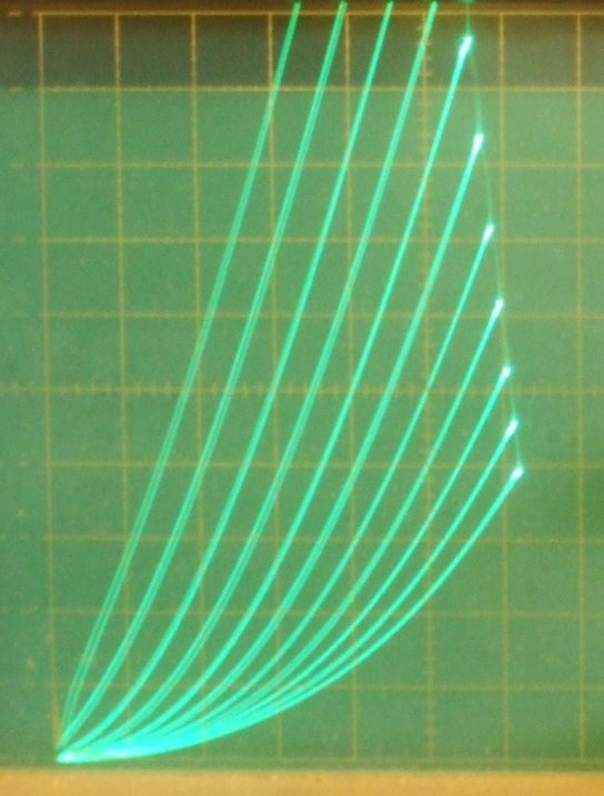

The 6GU5 tube is a remote-cutoff grid1. The triode Mu will be all over the place depending on the operating point chosen.
1st Pic. 6GU5 in triode:
(50 V/div Horiz., 2 mA/div Vert., -0.2V grid1 steps)
Going across the 6 mA horiz. line, looks like Mu from 150 to 100 range. A sloped load line might drop down into 150 to 75 Mu range.

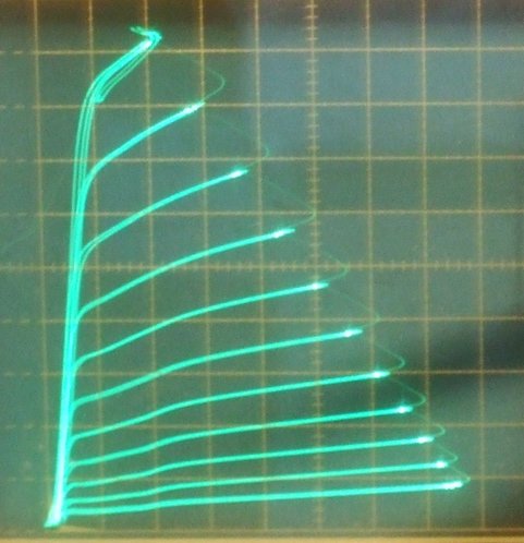

2nd Pic. 6EW6 in triode
(50V/div Horiz., 2 mA/div Vert., -0.4V grid1 steps) Mu around 100 to75
