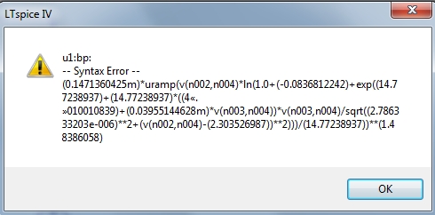

And thespice model.
Hmmm...
The text is copied directly from my LT spice INC file , and it works for me, Strange..Hmmm...
This is why it's always a good idea to use the code box for models, subckts etc. Click advanced on your reply/post and you'll see the "#" button.The text is copied directly from my LT spice INC file , and it works for me, Strange..
Like this:
Code:
* TML300b LTSpice model corrected by 1/2 heater volt
* Modified Koren model (8 parameters): mean fit error 0,8mA
* Traced by erik 25/12/2013 using Curve Captor v0.9.1
* pentaTJ300B LTSpice model
* pentaEML300b LTSpice model
.subckt pentaEML300b P G K
Bp P K I=(0.1471360425m)*uramp(V(P,K)*ln(1.0+(-0.0836812242)+exp((14.77238937)+(14.77238937)*((4. 010010839)+(0.03955144628m)*V(G,K))*V(G,K)/sqrt((2.786333203e-006)**2+(V(P,K)-(2.303526987))**2)))/(14.77238937))**(1.48386058)
Cgk G K 8.5p ; 0.2p added
Cpk P K 4.6p ; 0.5p added
Cgp G P 15.5p ; 0.5p added
Rpk P K 1G ; to avoid floating nodes
d3 G K dx1
.model dx1 d(is=1n rs=2k cjo=1pf N=1.5 tt=1n)
.ends pentaEML300b

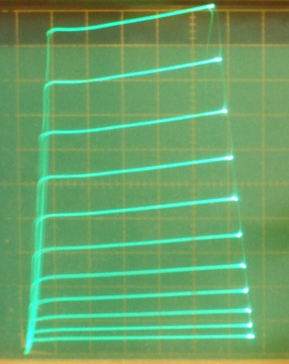

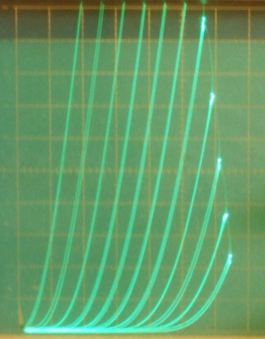

I'm wondering if there is a 6JC6 pentode model out there anywhere. I can't seem to find one. smoking_amp did post a set of triode curves in another thread:
2 mA/div Vert., 50 V/div. Horiz.
6JC6 triode curves, 0.5 V steps:
6JC6 pentode curves 0.15V steps, 92 Vg2
Here's the best data sheet I could find for 6JC6:
http://rtellason.com/tubedata/6JC6.PDF
https://frank.pocnet.net/sheets/049/6/6JC6.pdf
I can't find much data on this tube type. I'm hoping a model can be put together from these scraps. Thanks in advance.
