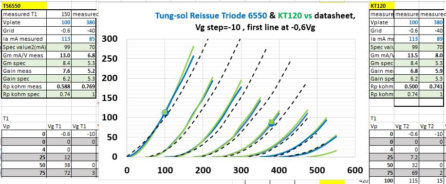

I got myself a tube tester where I can get data to plot plate curves.
Here is a comparison between Tung-sol reissue 6550, TS reissue KT120 and the Ge 6550A datasheet curves. http://www.mif.pg.gda.pl/homepages/frank/sheets/135/6/6550A.pdf

Wow, it looks like the reissue 6550 and the KT120 have lower rp in triode than the original GE 6550. That might be a good thing. Thanks for this.
