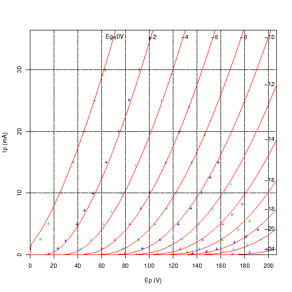

For those who prefer/want an Ayumi 6AF4A model.
Traced from General Electric 6AF4A datasheet.
Code:
* Generic triode model: 6AF4A
* Copyright 2003--2008 by Ayumi Nakabayashi, All rights reserved.
* Version 3.10, Generated on Mon Oct 30 15:55:01 2017
* Plate
* | Grid
* | | Cathode
.SUBCKT 6AF4A_AN A G K
BGG GG 0 V=V(G,K)+0.57582328
BM1 M1 0 V=(0.092328554*(URAMP(V(A,K))+1e-10))**-2.2616446
BM2 M2 0 V=(0.39876175*(URAMP(V(GG)+URAMP(V(A,K))/6.5119426)+1e-10))**3.7616446
BP P 0 V=0.0032769425*(URAMP(V(GG)+URAMP(V(A,K))/16.330409)+1e-10)**1.5
BIK IK 0 V=U(V(GG))*V(P)+(1-U(V(GG)))*0.0082945898*V(M1)*V(M2)
BIG IG 0 V=0.0016384713*URAMP(V(G,K))**1.5*(URAMP(V(G,K))/(URAMP(V(A,K))+URAMP(V(G,K)))*1.2+0.4)
BIAK A K I=URAMP(V(IK,IG)-URAMP(V(IK,IG)-(0.0019440308*URAMP(V(A,K))**1.5)))+1e-10*V(A,K)
BIGK G K I=V(IG)
* CAPS
CGA G A 1.9p
CGK G K 2.2p
CAK A K 1.4p
.ENDS
