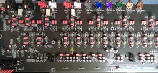

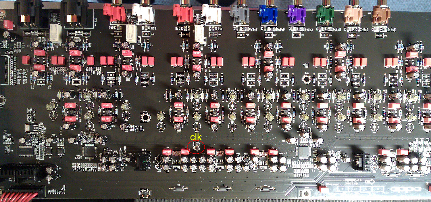

What you saw in the beginning of this thread it refer to the main processor clock. This is another story...
The (stereo) DAC clock mod it was not treated very well here I suppose... So, I think to renew the subject here and now.

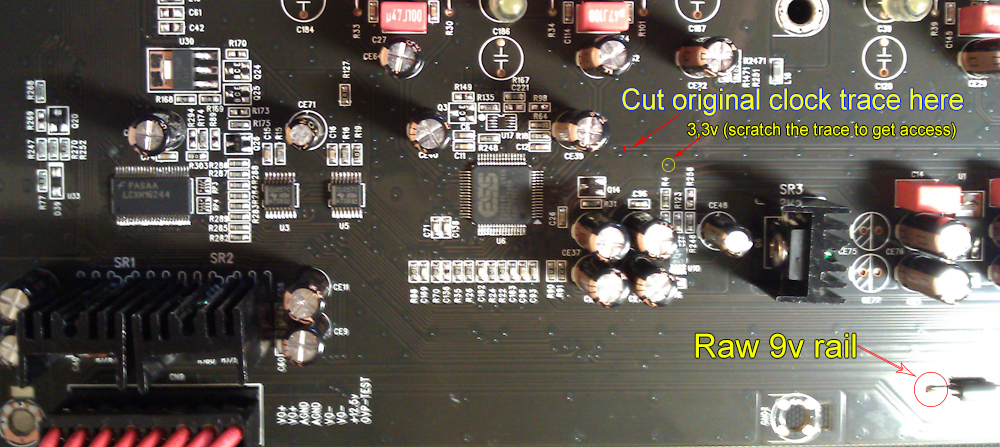

You see in the picture of the analogue board hereby, the placement of the original 54Mhz oscillator, which is common for both DACs. On the C100 near to the oscillator chip one can found the 3,3v line for oscillator power. This power it can be used to power the new oscillator. If one may use a dedicated regulator for the new clock, then a higher voltage power line should be used (regulated to 3,3v). The raw 9v rail is indicated on picture hereby.

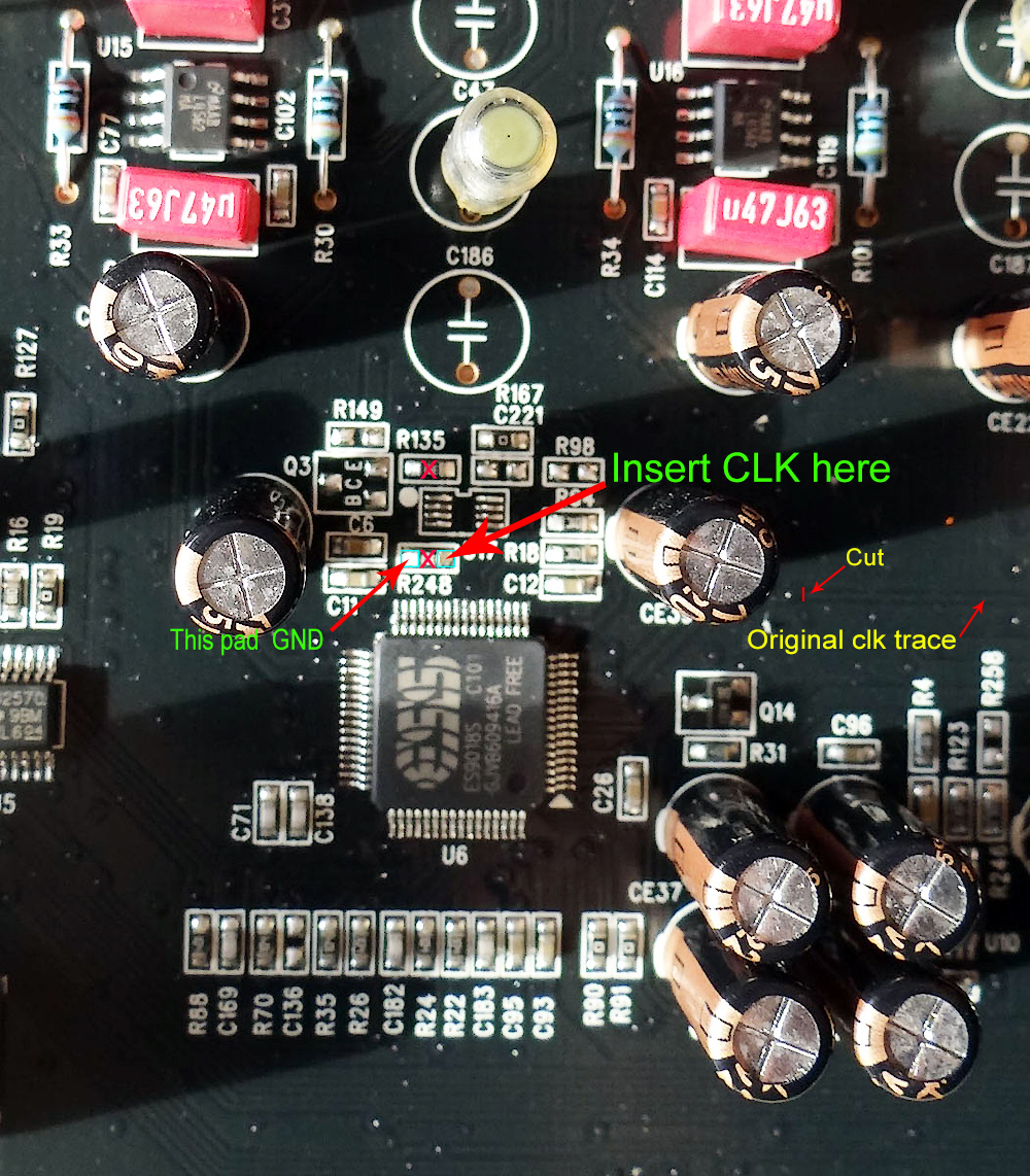

I will suggest to not remove the original oscillator, but cut only the traces, and remove the indicated resistors. In case of malfunction, then the original approach it could be easy reestablish (reversing operations). The original oscillator may be let it work for the multi-channel DAC, or it can be dismissed if only the stereo DAC is used... Also the same clock mod it can be applied to the multi-channel DAC if need it (a second dedicated oscillator should be used).

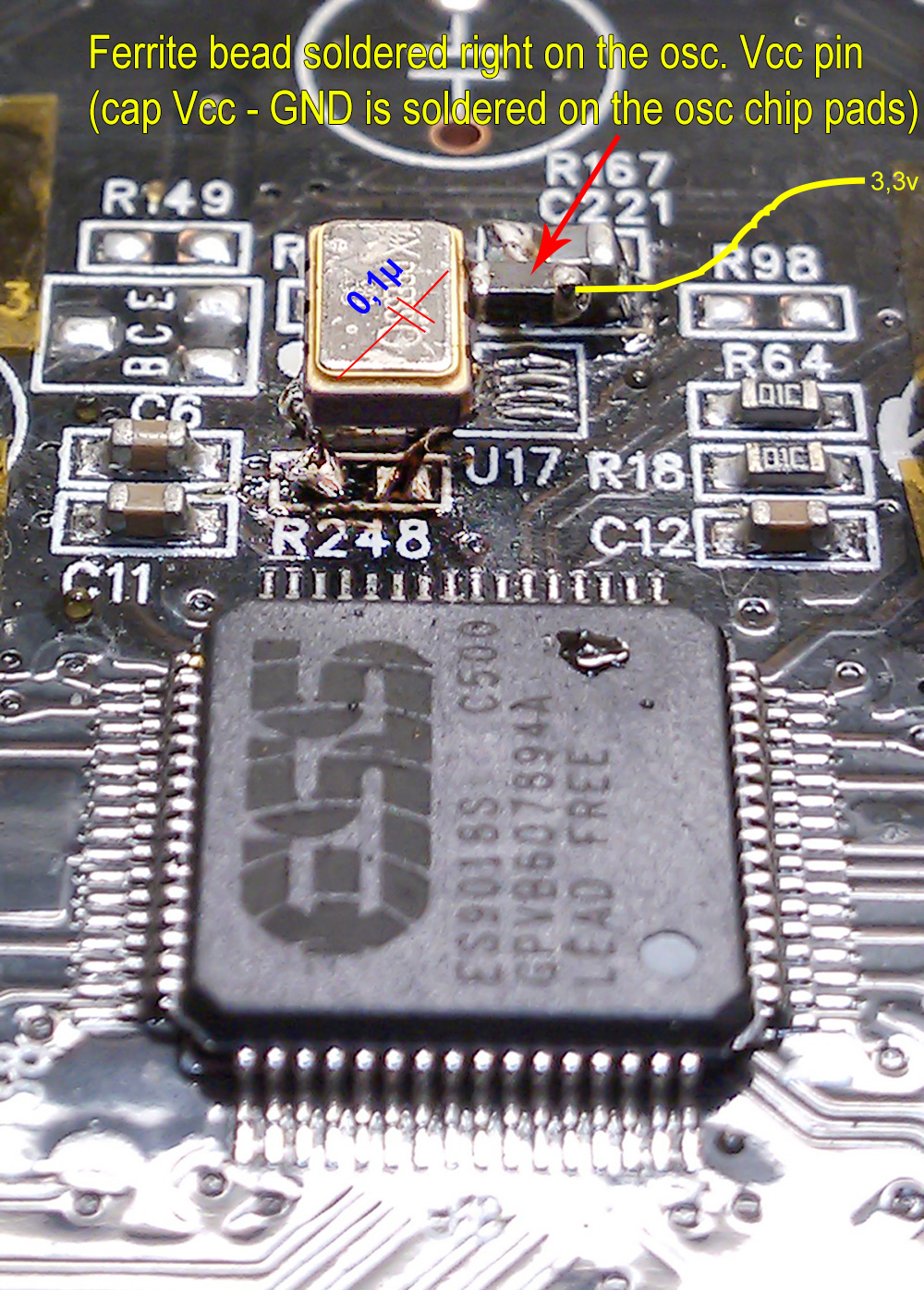

To isolate the stereo DAC clock inserting point, one should cut first the original clock trace (see picture). Then remove the resistors R248, R135 (marked x on picture). Insert the clock as shown on pictures. Coaxial cable should be used if the oscillator is placed somehow far from inserting point.
For best result, I will also suggest to solder the new oscillator directly on GND and F-out pads (to the former R248 pads), then connect the oscillator to power (eventually own regulator) by a thin (as short as possible) wire, and/or using the available power points indicated. The new oscillator chip it can be soldered in a vertical position in such case. An 0,1µ SMD cap should be soldered directly between Vcc and GND pads of the new oscillator chip. Special care should be taken while soldering operations, as the pads on board are fragile and it can be disclosed very easy. It is important to keep these pads in place, as it are very handy for the mod procedure.

As I said/suggested in my previous post, if one only use the oscillator as it is, powering it from the existing power system, then the best result it could be to solder the new oscillator chip right on the available pads on PCB, without any board in between. Placing the oscillator right over the DAC chip (your approach), without any shielding/grounding in between, it may not be the very right solution... Oscillators at such high frequency have to be installed very carefully to avoid degrading the clock signal. Also the power for the oscillator it have a crucial impact over the clock signal quality. Much precautions have to be taken to avoid clock signal propagating into the power system.
As a general advise, I will recommend first a carefully analyse of the eventual modification, then choosing a final best solution as possible.
First, about the new oscillator, I will suggest you to mount it as described previously, right on the pads of the former R248 in a vertical position. Thant perforated PCB you have used to support the oscillator over the DAC chip is far from the right device in this approach, and it may worse more than improve something. Also the tantal cap for oscillator decoupling it may not be the right component in this case. Better to find a small SMD ceramic cap to solder it right on the oscillator pads.

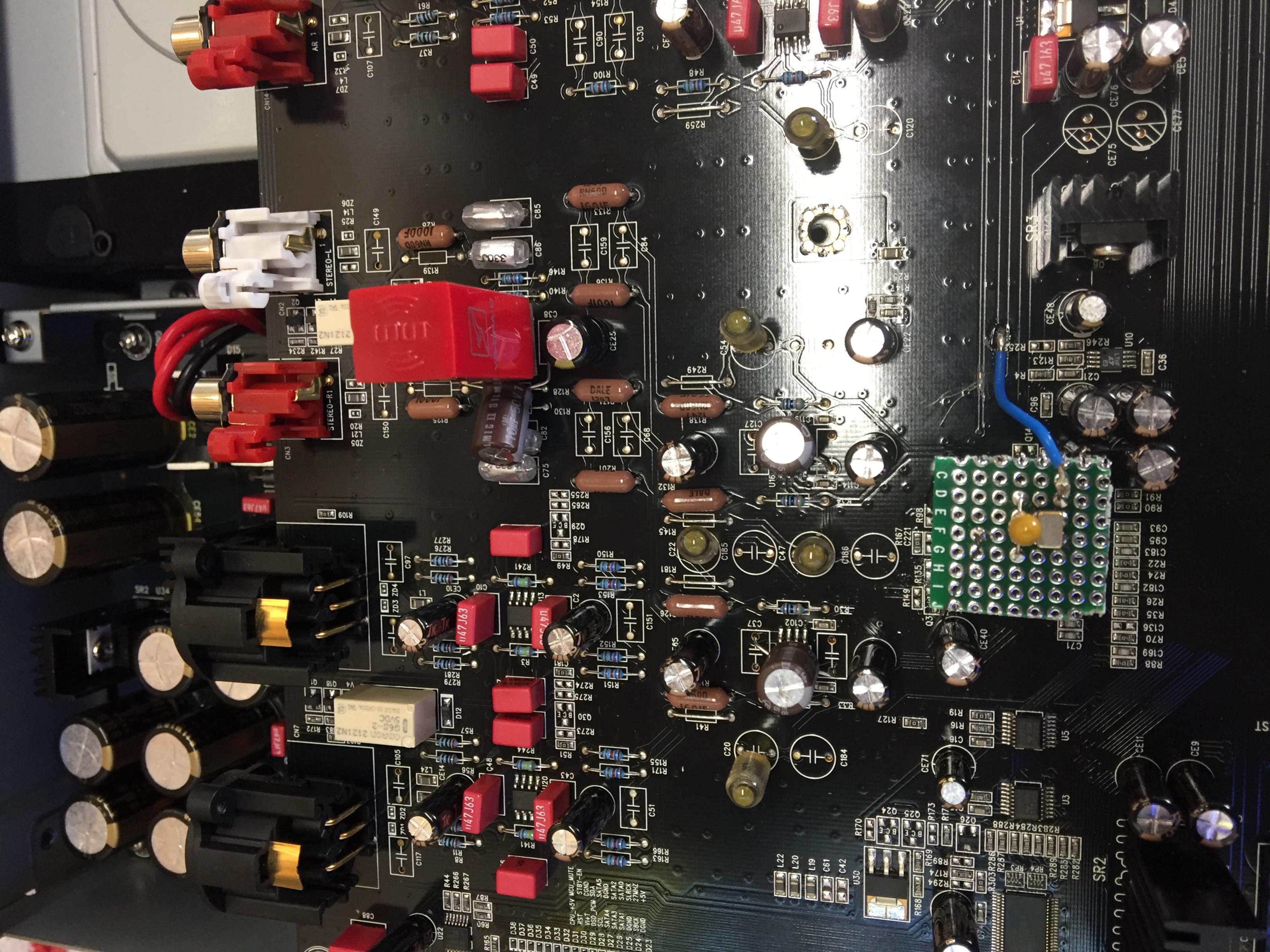

I found a picture of my old mod in this area, to illustrate my suggested approach. I have used there some very short solid wires to adapt the new oscillator footprint to the pads on the PCB. One can solder the oscillator chip in a vertical position directly to the pads on board. It will result a very solid "construction" which is much better than using a such perforated small board... A very thin and flexible wire (to not mechanically stress the oscillator chip soldered on the board pads) it will then connect the Vcc of the oscillator to the power point. A ferrite bead in between it will minimise a lot the residual frequencies to propagate into the power system. A decoupling SMD 0,1µ cap it is also recommended right on the connection point of the Vcc wire to the 3,3v trace. Such precaution and filtering are a must when handling with oscillators at these high frequencies...
Doing the clock mod in this way, one can then appreciate as finished, focusing further to the another areas of the system for improvements...

Wow. Those are some serious skills. I has super happy just to mount the clock to that board. I think we're on different levels. I'll try the decoupling cap on the clock. As far as the ferrite bead: I've seen you recommend at least a 1k in the past. I don't think I could manage a smd type though. What could I use instead?
