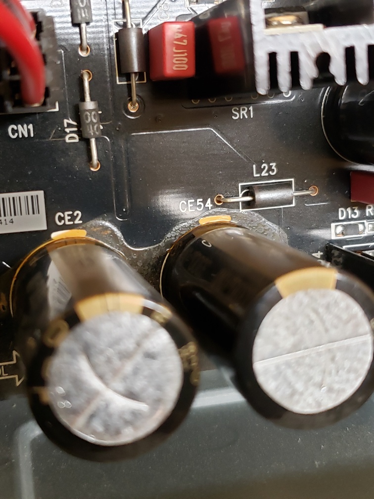

Are these leaky caps

hello everyone,
I got this BDP 95 used recently. The fan seemed to run a lot, so I opened up the case.
I noticed the following brown residue under a couple of caps in part of the power supply. Are these a sign of caps on the way out ? There doesn't seem to be bulging or visual distortion in the caps.
Thanks for any suggestions
The fan continuous spinning it may be caused by failure of the thermal circuit, which it control this fan (inside the main processor), or of the fact that main processor it always work hot. In this last case, the fan should not run just at power on, but somehow later.
Another possibility is that the fan it was wired so (not original approach) to spin always, for an supposed improved ventilation.
The substance seen at the base of some caps on original PSU it may not be a residue coming from the caps, but a glue used in board manufacturing process. Oppo used a such glue approach in all its player models, to immobilise some caps to the board.
If that substance it can easily be removed (cleaned out), then it mean it come from the caps. As normal, when a cap it leak its electrolyte, this is because a internal pressure. Such pressure it may also inflate the cap (not the case in your picture).

Thank you.
From a overnight rest, fan is initially off. Fan starts a few minutes into a song. It does not turn on much if the cover is open.
The substance is thin and a little sticky. I cannot easily remove it. I did not try any solvents.

All right. About the fan: the fan behaviour is not just unusual. It start up running when the processor temperature reach a quite high level (stupid design of that Oppo model). The fan it will however not contribute to much to cool the processor. The problem is that the processor it reach too fast a high temperature. An audio playback should not cause an important heat dissipation on that processor. This is more normal when playing back video or BD discs. The processor high working temperature it can be caused by the degradation of the thermal paste capabilities to transfer the heat to the enough insufficient, heatsink. The processor get better cooling when the cover is removed...
It is not very difficult to remove the metal plate mounted over the processor and then replace the old thermal paste (or maybe the thermal pad) with a new one. If it is placed a thin pad there, then it is better using thermal paste. Also that processor it have a thermal pad placed under the board, to improve the heat dissipation to the chassis. That pad it could be degraded as well. However, try first improving the thermal transfer to the heatsink placed on the top of the processor...
About the substance under the caps: that is not a leak from the caps, but a glue used to fix the caps to the board, or even it may be meant preventing an accidental corrosion on board, in case that caps should leak for one or another reason.
Well, we cannot know exactly what it was in the mind of the designers who decided to apply that glue under some caps on boards of Oppo devices... There is not necessary to remove that substance.
