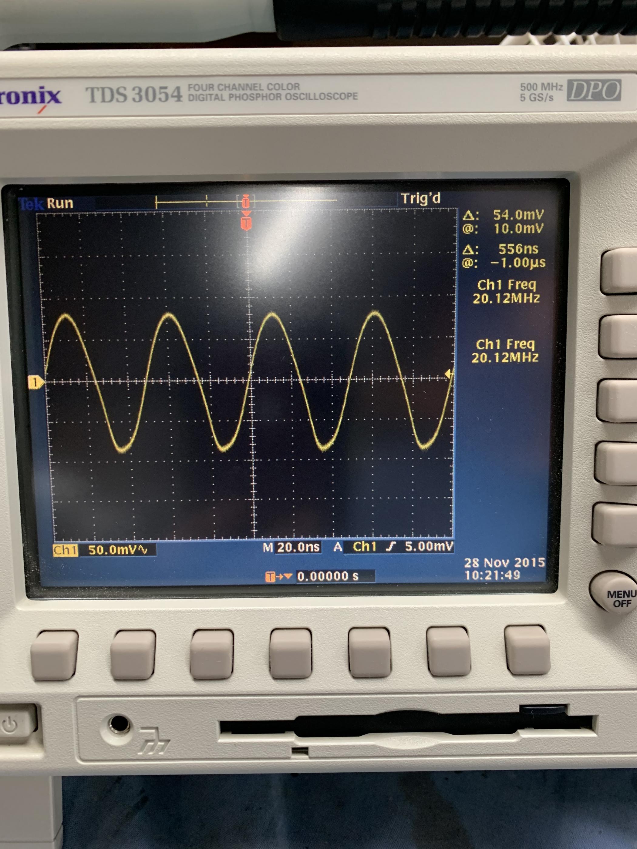

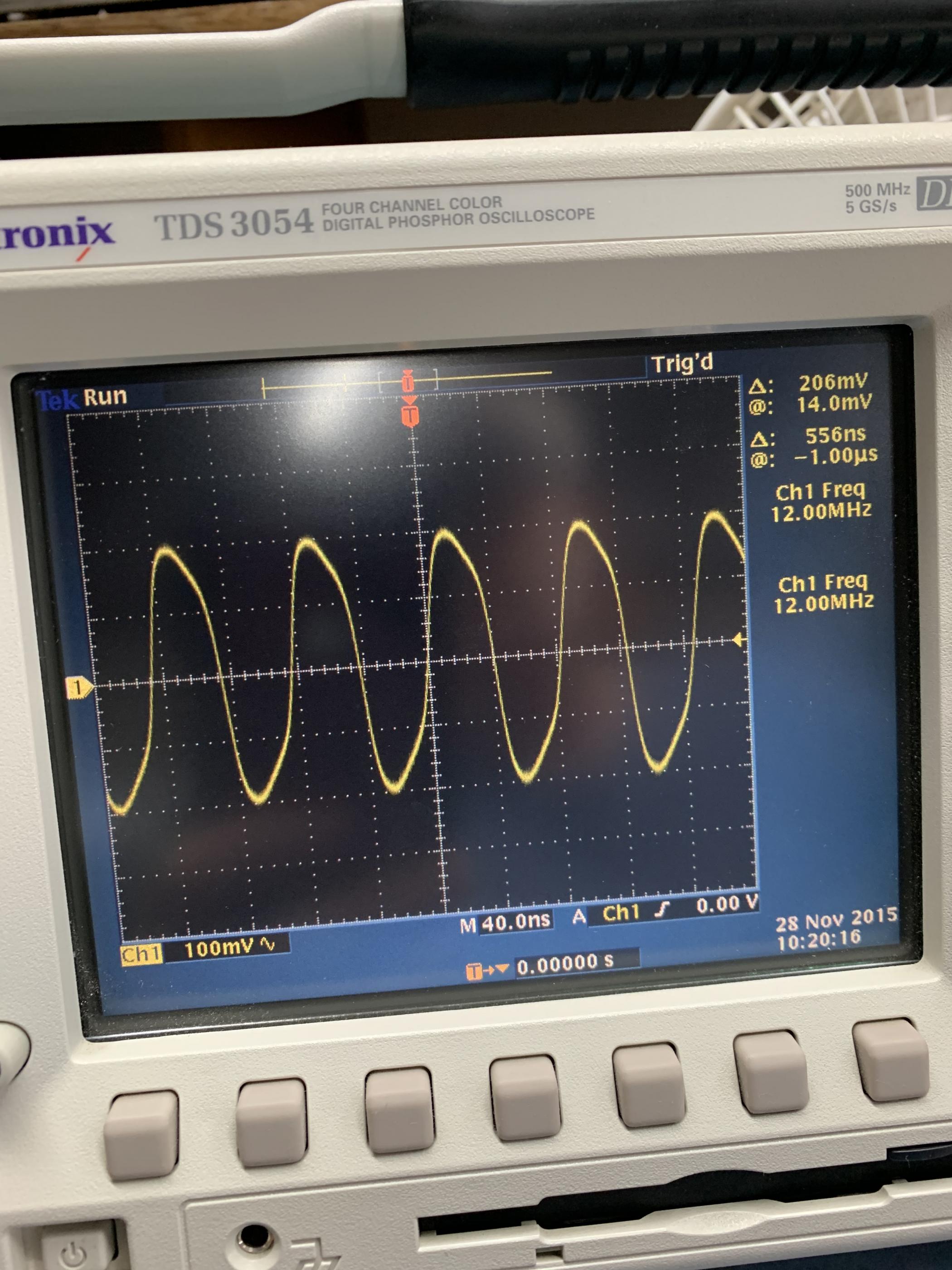

Well, the clock signals itself it may be all right, I suppose. In fact it is about resonators there, so the clock circuits are inside the chips. Measuring at the resonators pins it may induce some spikes on clock signals (when touching it with probes). This it may have impact over the system fault itself. This measurement it may not be conclusive in a first instance. More important it may be verifying the processor power system, and knowing the SMPS it not output high levels HF noises.
OK clocks
X6
X7

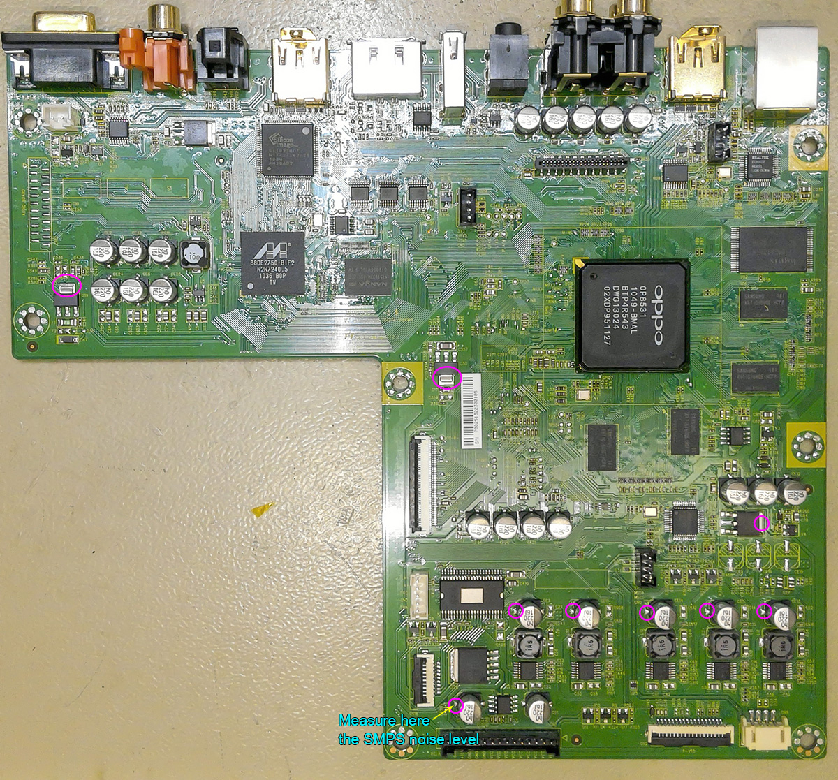

Please measure all the marked points on the picture bellow.
Put the scope on AC coupling, 5-10ms, 100mV/div, and place the probe where indicated to visualise the eventual HF noise from SMPS (chose the GND nearest as well).
Let`s see then what`s more...

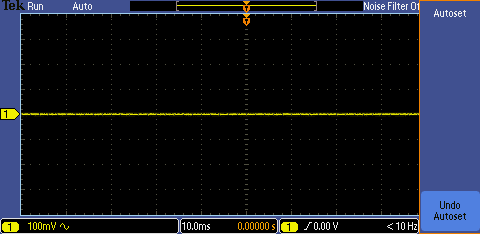

OK I have measured at the those points for noise with the settings you gave me
and just a narrow flat line on the scope - see photo

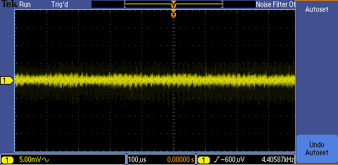

Then with auto acquire on bottom LH cap nearest SMPS 5v in there is some noise.
With the same scope settings the noise is much lower as you move further into the board.
