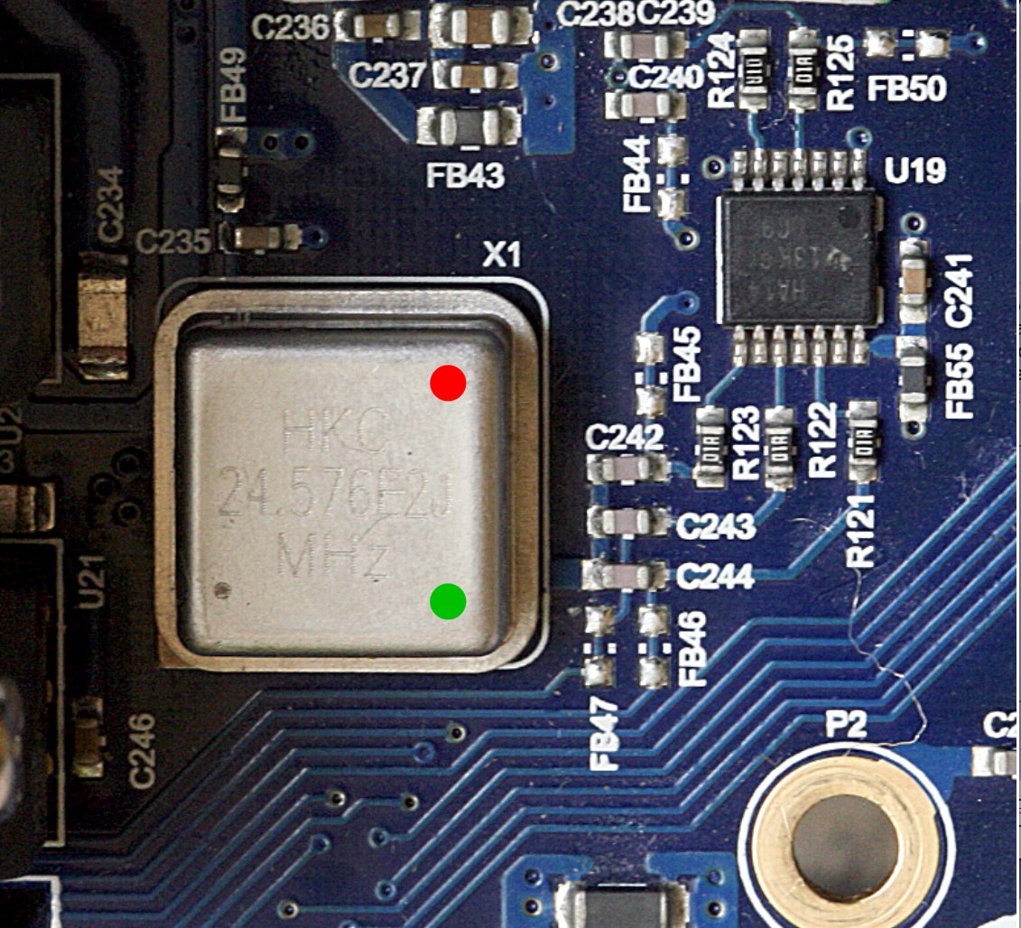

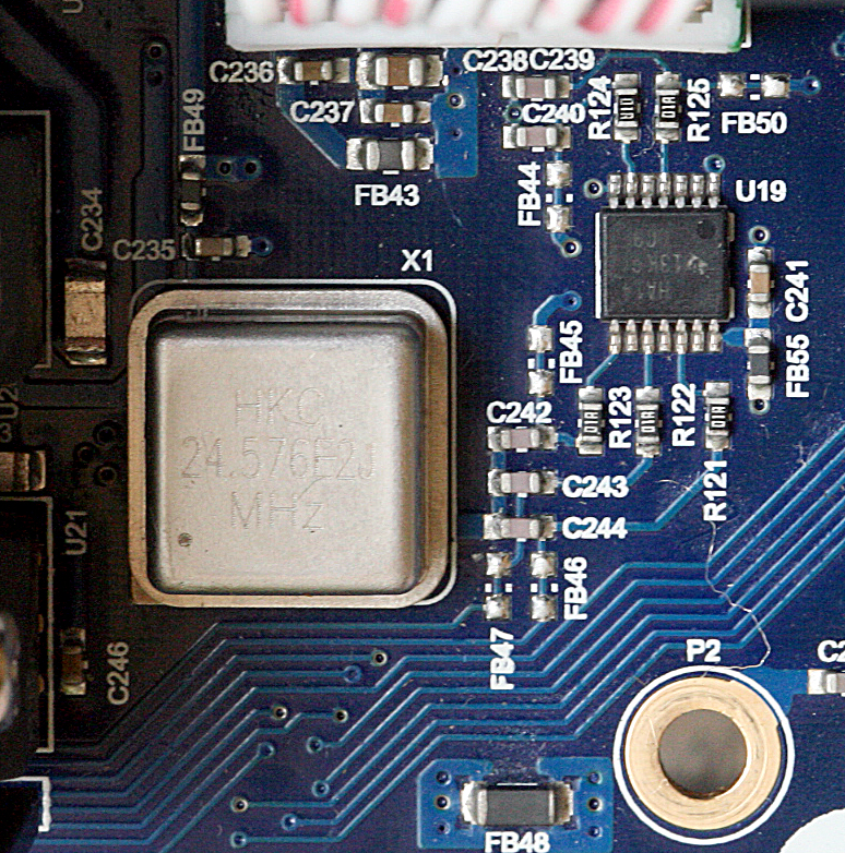

I too am interested in replacing my stock clock in my Cambridge Azur 851c to a NewClass D Neutrino Super clock and while the instructions from the manufacturer are simple to follow, I don't have a schematic for the player (it is still in production). I didn't have any problem finding the power for the clock, but I am having a problem finding the two caps that I need to remove in order to install the clock. I have attached photo of the board below with the hope that someone can help me identify the right caps to remove. Since they are surface mount devices, I don't want to make a mistake-- replacing them would be difficult. Thanks in advance to anyone who can help.
There are no caps to remove, remove existing oscillator and identify which of the four pins are the output of thr oscillator and that becomes your input.
See where it says "X1" near the corner of the oscillator, it is printed on the PCB. That corner should be it. See "Red" below. The "Green" is your Ground.

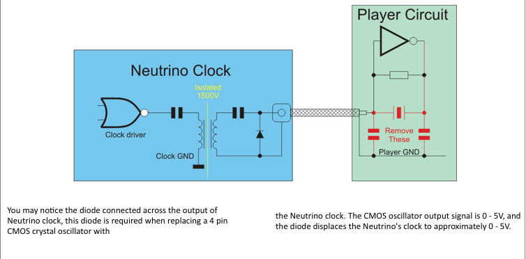

Thank your of your suggestion. Have you worked on this machine before? Is it that this design doesn't have the caps to remove?

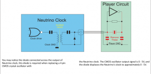

Please excuse my skepticism. It is curious to me that the manufacturer of the replacement clock would put a diagram on his site-- as a part of the instructions how to install his clock-- that the two caps coming out of the original clock have to be removed. Please advise.

They should have included two sets of instructions, you have only been given one, replacing a resonator with a clock, not replacing an oscillator, which is what you have got.
There are no caps to remove in your case. What you are removing is a powered oscillator (it should be 3.3V) and not a crystal, which is basically as resonator that needs those caps. The new clock is also a powered oscillator (it should also have its own 3.3V). So in a sense you are replacing like for like. Probably done a thousand of clocks by now. If Coris is around (he is likely sleeping now), he will tell you the same thing.

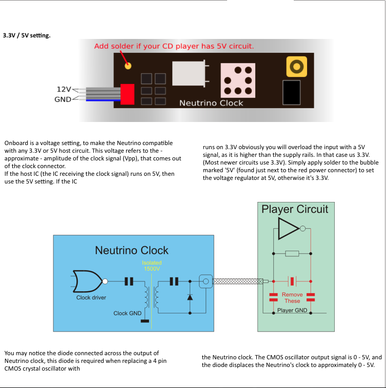

Thanks again for the clarification. In terms of the power supply for the new clock, it says that it needs 12v going in but the clock runs on 3v. Does that mean that I have to find a 12v source for it in the player and then before it gets to the clock, it steps it down to run the clock 3v? Or do I find 3v in the player and use that directly? I have attached the instructions from the manufacturer's site. Thanks for you help so far.
