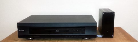

There was for a while a discussion about a possible project to adapt an external linear power supply to an Oppo 95 model, as this device do not allow placement of a such heat dissipating PSU inside its enclosure.

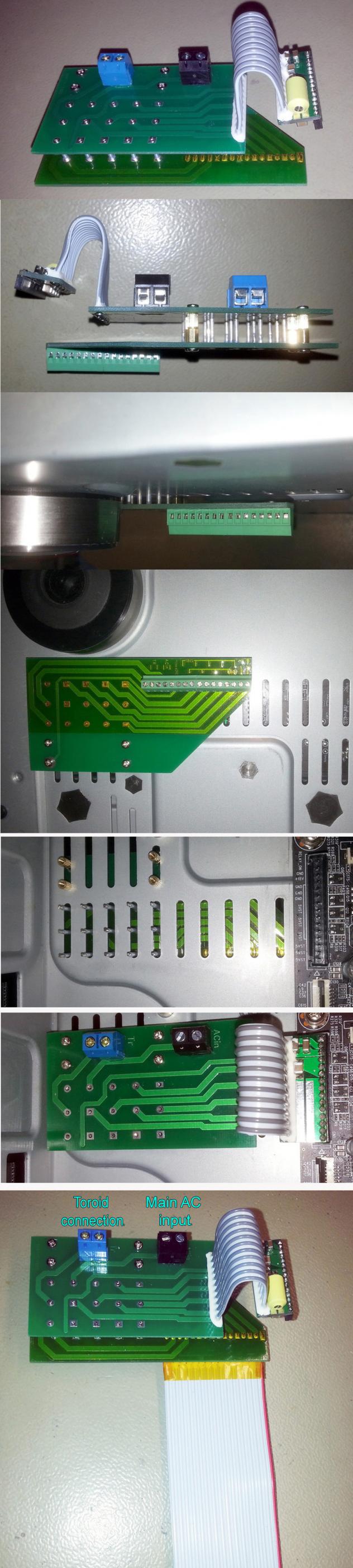

Recently I decided to finish my idea about an adaptor to make possible the connection of an external LPM to the 95 model main board (dismissing/replacing so its original SMPS).
This adaptor is now designed and I will send it soon to production. The interconnection, main board in 95 model to the external LPM, it will be made through the bottom side of the chassis, very near to the main board connector, and it will be the shortest possible one. The external LPM it should so be placed beside the player on its right side. No any mechanical intervention on the chassis bottom side (cutting) it will be necessary to realize this connection.
I may come back with more informations, as soon as the adaptor it will be manufactured. Then it rest only some experiments to appreciate more accurate how the LPM it will be able to power the 95 model, about the heat dissipation, and maybe about eventual adjustments.
By the way, I found also a right and quite nice enclosure for the external LPM too...
It looks to me like this project it will come soon to an (happy) end...🙂

It take a little bit longer time, as I did something wrong, and I had to redesign the power cable adaptor. However, everything it goes straight forward... Both silver and black enclosures.
I do hope to come out with some pictures one day on March...

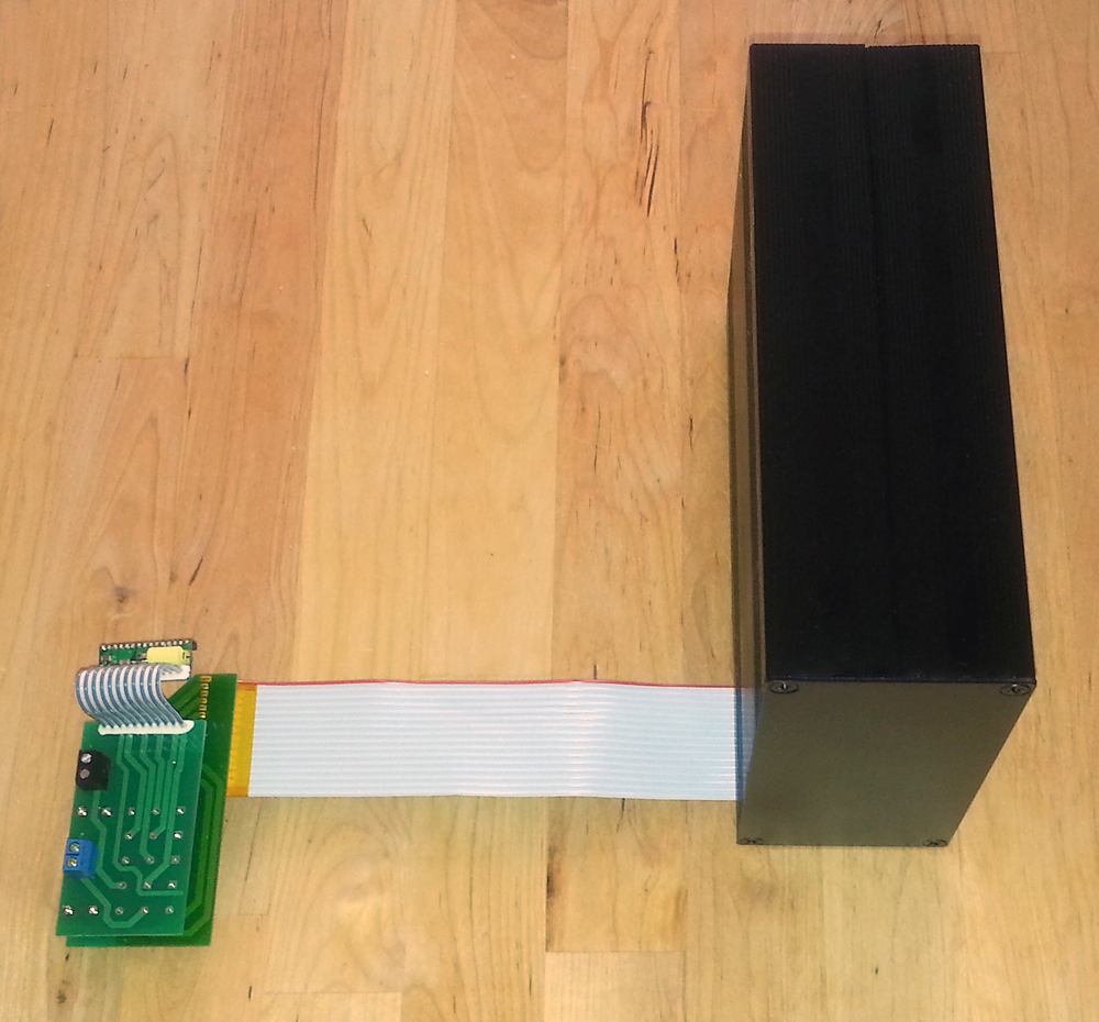

My approach for an external PSU/LPM for 95 models. I have not yet tested my LPM with a 95 model, but I will do it soon.

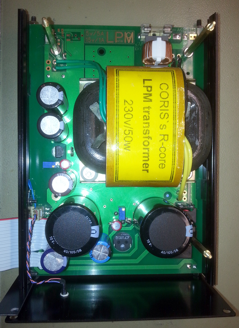

Back (in time) to 95 model...
Well, well, there is quite a time, since this Oppo model was on the operation table, moded and improved.
I was inspired by some guys here to find a solution for a linear power supply for this model. As this model is not so tall as 105, the ventilation inside is difficult, especially when to exhaust the heat of a linear power supply. The main processor, (first generation) it dissipate enough heat, so more from a LPM is not just one may want inside the enclosure.
A external linear PSU is in my opinion the solution for this model. Now this is designed, the approach is finalized, and the LPM is working very well (on bench).

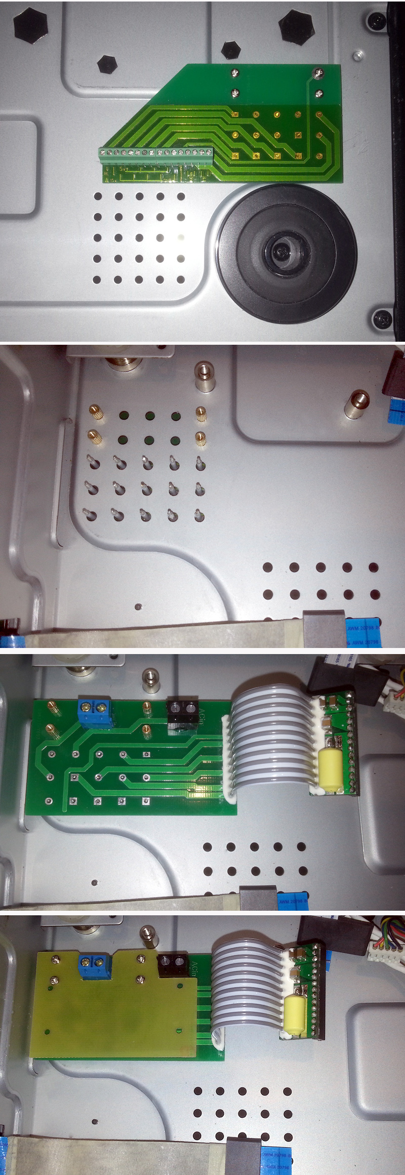

I thought myself to implement a such external LPM for my own device. Opening it my player, to examine the ways to do it, I was surprised myself about the mess I found inside my own device, as a finalized improvement, for few years ago. Lot of wires all over, quite many improvisations, and enough primitive approaches. I just took the decision to update the whole device, using much more professional approaches, solutions and improvements.
So, back in time to the 95 model, for a brand new mods session, based om my experience gained with the 105 model. I appreciate that this 95 model it deserve a lift up, and a professional way to be modded.
It have the main advantage of a very good DAC chip, which is configured by design (and firmware) much better than in 105 model, even though the video part is not just as high quality as in the last Oppo BD model. I presume, with the updated mods in the right places, this model too it will be on top for both sound and picture.

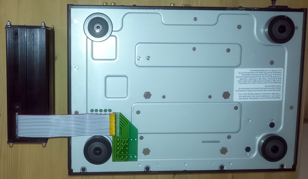

I decided to begin already with the installing of external LPM. I removed the original SMPS, and the free space inside I intend to use it to place in a linear PSU for the audio board. Then it will be the clock system improved (my battery powered clocks approach), then the power system for DAC chip, and finally the post DAC analogue signal processing circuits, it may be the main goals for this 95 model.
You can see here the installation of the adaptor for external LPM.
So far, so good...

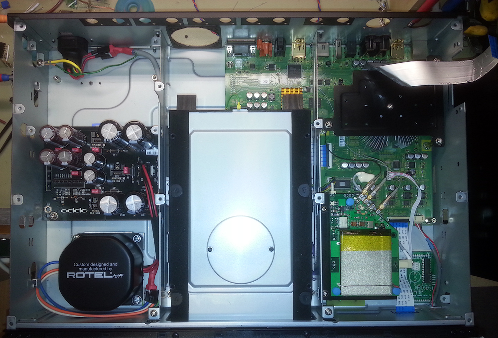

Improving ventilation in 95 model

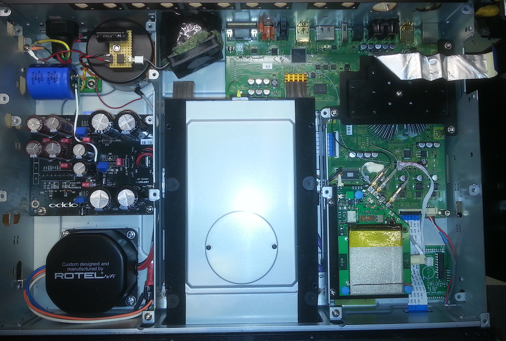

Recently I fully modded a 95 model (including installing of my external LPM, as improved analogue power system). Here is a picture of the first stage of the modification. The analogue PSU it dissipate through chassis.
I thought to give it a try, assuming there may not be necessary the fan. Well I was very wrong...
The +/- 15v regulators on the analogue PSU it dissipated quite resonnable heat, while the 9v regulator was running at 70deg. C, so well thermally connected to chassis. The toroid it was running at around 45 deg. C, and the processor itself dissipated also much enough heat. As known, the fan control in this model is made by the processor inside thermal circuit, and this it start the fan only when the processor it reach a so high temperature as 70 or more deg. C. Another stupidity of the original design in this model....
Well, just not possible to have the player running in such conditions, as the high heat inside it disturbed my clock board functionality.
Solution: unloading the so called "custom made Rotel" toroid for the 9v rail of the analogue PSU. I have mounted a second smaller toroid, and lowered the 9v rail to 6v (this rail it provide raw power for 5v, 3,3v and 1,2v regulators for DAC, digital power on analogue board, and relays). Just stupid at Oppo used 9v to regulate it to so low voltages...
As my second toroid it delivered 2 x6v AC, I used its second coil to power the fan. Everything fine about the improvement approach, but it still a problem: the enclosure of 95 model it was not designed with ventilation in mind, and the admission of the fresh air is extremely poor and totally inefficient for a decent inside ventilation, even thought the fan it is always running inside.
The solution for improving the ventilation for 95 model I intend to present it here.

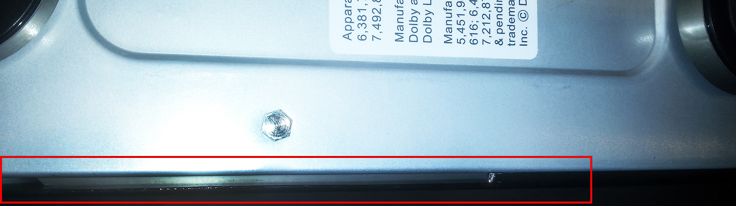

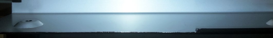

Mainly there is about to create in the original enclosure, windows for fresh air admission, in a elegant and easy as possible way.
I noticed that the cover of the chassis is designed so to have the lateral sides at 5mm distance from the chassis. Maybe a clever designer had a good idea in his mind doing so, but then it came another not so clever second designer, who decided not to use the first ones clever idea, and bend it the edges of the cover, so to close up the air admission inside...
This available 5mm space on a large area in between the chassis and the upper cover (lateral sides), it can very well be used for air admission inside the enclosure, without altering in any way the original shape and design of the chassis and its upper cover.

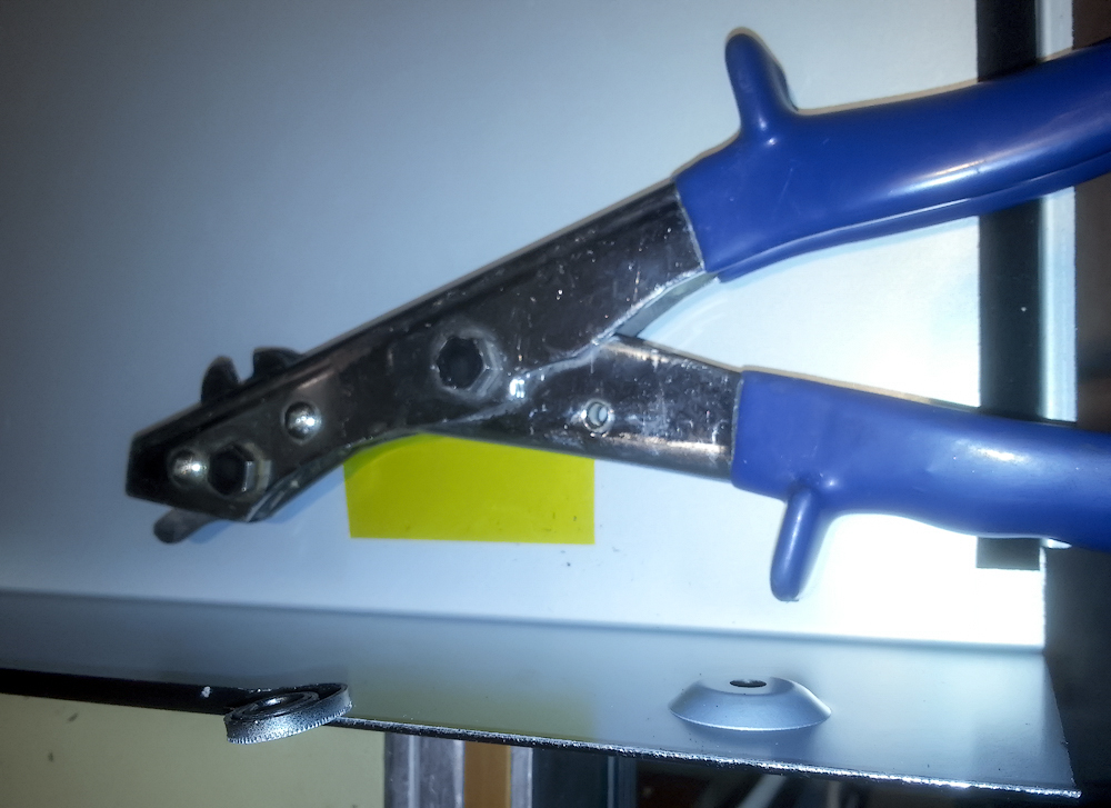

The attached pictures here it shows well enough what is all about. Cutting out that 2mm edges on the both lateral sides of the upper cover, on a 10 or 15 cm length, is more than enough to provide a very efficient air admission and finally a excellent ventilation (with the fan running continuously, and completely silent, powered at 7v instead of 12v). The whole device is so running just at the room temperature, and this is really a performance for a Oppo 95 model. Well, when a external LPM is used to power the digital stage... To not say more that nothing is to be noticed from outside: the enclosure it looks the same as original...
BTW, if someone may think to try this mod, then it have to be used only the cutting tool pictured here, which it cut without distorting in any way the cutted edges or the rest of the surrounding surfaces (the cutted edges it have to be finally a little bit processed to be smooth with a nice finished look). Doing the operation carefully, even the original black paint is not altered at the cutted edges...
P.S. For my next mods of this model, I will use a R core transformer instead of this Rotel which it fit very bad in this device. My custom made R core transformer it will deliver the right power for the analogue stage of the player, so to minimise the heat dissipation on regulators.
