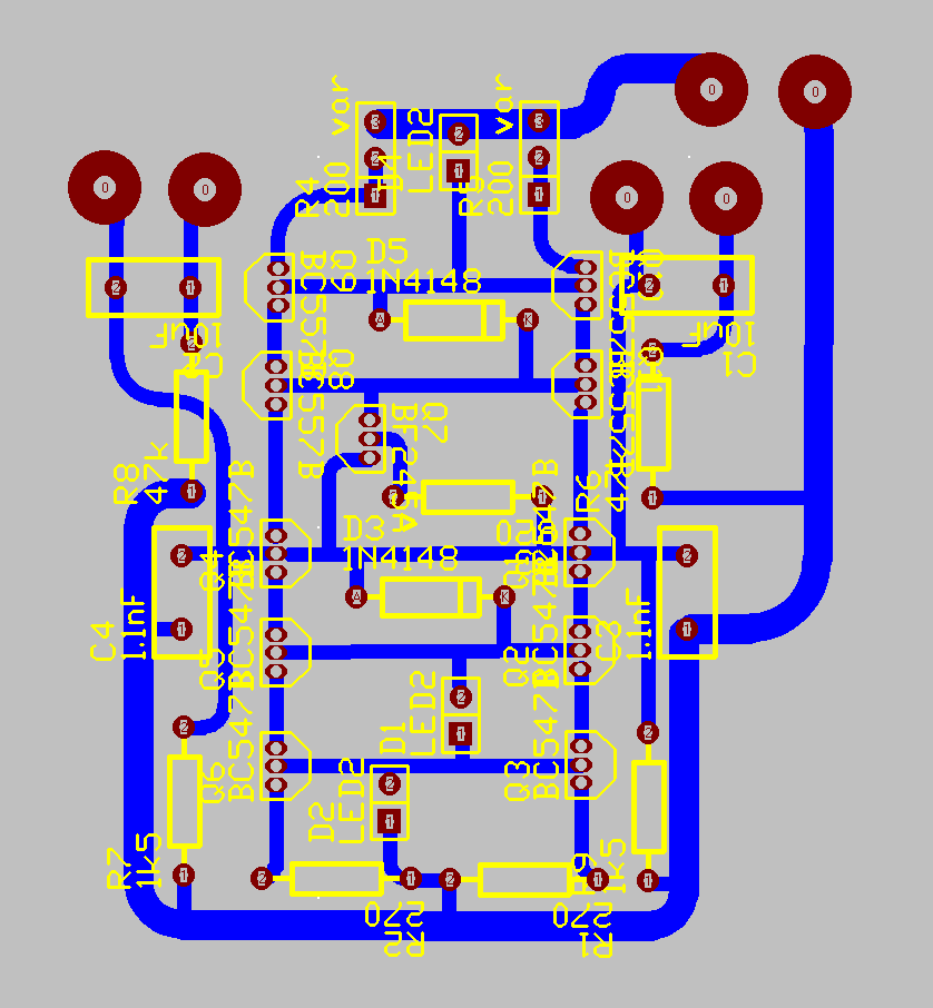

Also trying to design the final pcb, how is this for a start....haven´t done one in many many years ?
Of course this will only have a final form when we settle on final values and cap type after testing.
Coupling caps can be in or outboard, for example the sonicrafts and the Obligatos i have are too big for inboard.

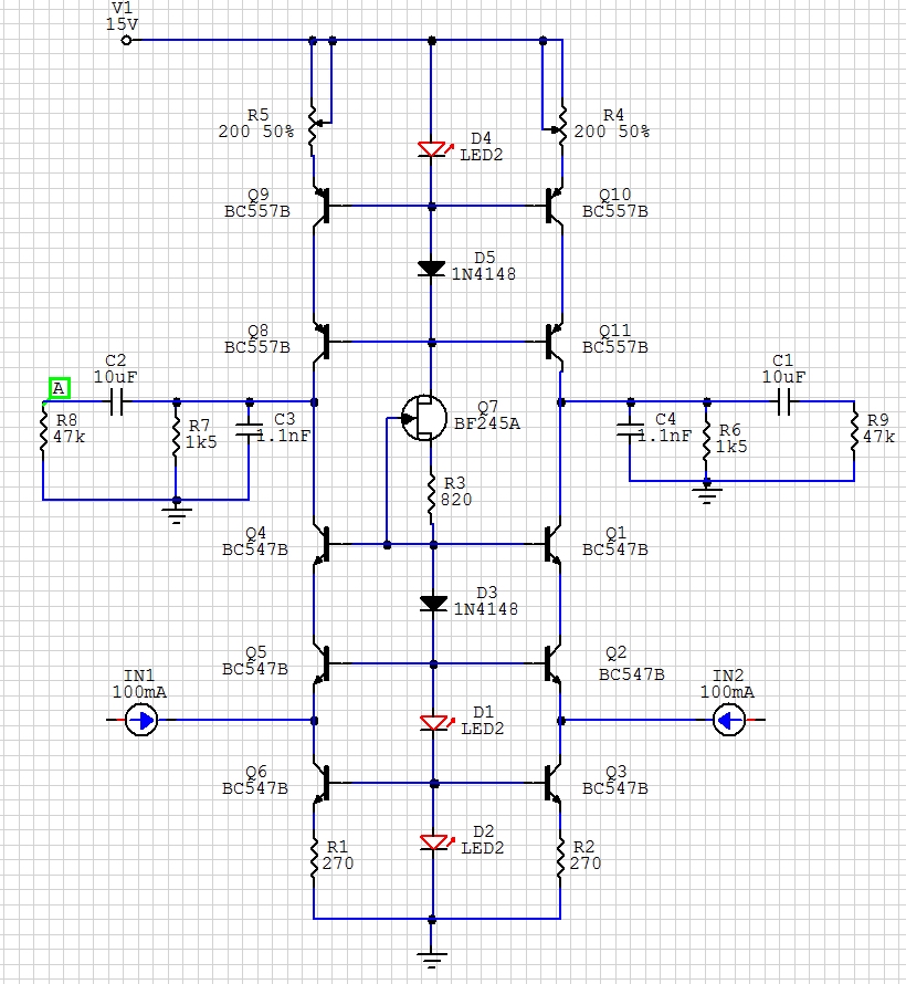

I'm using values in the last schematic i posted here, except for output resistor value, i'm using 3k3....but that gives me too much gain, i'll go back to 1k5.
Should i lower the 10u cap to say 4u7....if i can get bass then sound will be gorgeous.😀

give me voltage potential on DAC outputs WITHOUT I/V stage connected , and same potential with I/V connected .
tell me one more time ( sorry if you did that already ) - what's input impedance of your dreky UGS ?

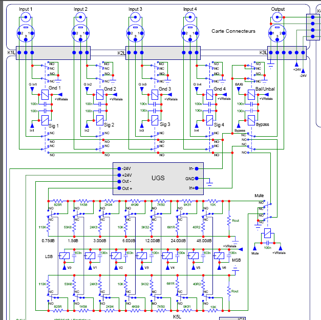

CeeVee said:I'll do those measurements...meanwhile here is my UGS schematic, exact values i'm using:
Some guys who built it used higher RIN....those are Flat's standard values.
and pot value is ?
pot is 200R adjusted to give mid offset.
Just a detail, i used a 220u/25v Panasonic FM on each board on supply inputs, should i take it out ? might be messing up power supply output impedance?

sorry I meant on volume pot on input of UGS
I need to figure out what is exact input impedance of your UGS thingie
anyway - just for test - increase these 10uF caps on output of I/V stage ; maybe input impedance of UGS is too low ......
you can use even lousy elkos for test ; 20uF is adequate ; so - C1 and C2 , each 20uF
let me know what's happening 😉
OK,
It seems input impedance of UGS is in the order of 10K, out put 300R, as Flat says.
I can make it higher by increasing Rin.....but i think that is working at the wrong end no ?
So i should have a lower cut-of off....
Cf = 1/(2*pi*R*C)
Cf= 1/ (2*pi*10OOO*0.00001)
Cf= 1,59Hz
using the 10u on the I/V.
