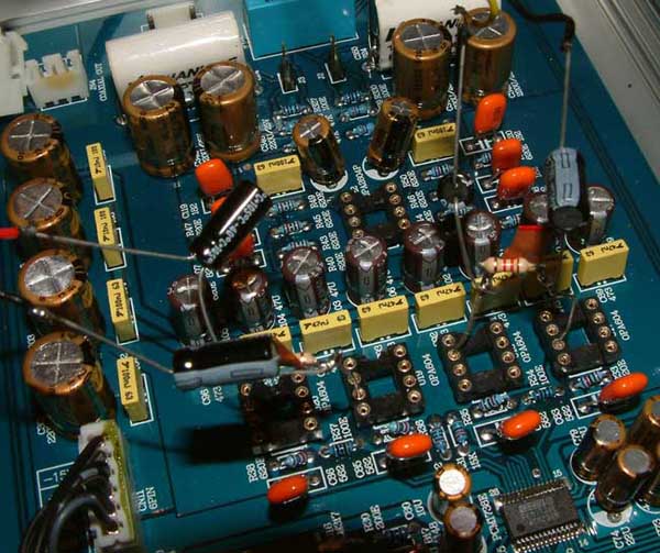

just for my pleasure - give me few pics of rat's nest ........ 😉
Of course ZM,
I'll post today's rat's nest in awhile but more tests only for tomorrow.
I'm preparing for a conference next week....I'll be all week in Oostende ( north Belgium ) but i'll be able to do a few more tests until Thursday...after that it's a whole week for your fertile mind to think on the issue...along with all others here of course.😉

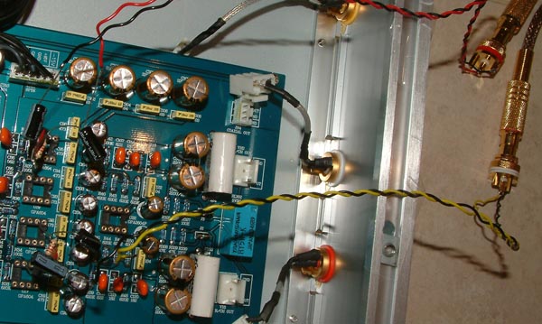

A closer look.
Just a thought; i did not lift the caps in parallel with the resistors,
Guess i need to do this and test again.
Also maintained the 100n caps to ground.
I didn't saw that post of yours , while typing previous .....
be sure that output pins at DAC are completely free of any load ( form original circuit ), be it cap or resistor
you remember that I don't know exactly how that output configuration looks in Drekling .......
100n to ground ?
where ?

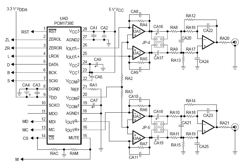

...100n on board are the C11, C12 and C21, C22 on schematic you posted from data sheet.
They are still in, should i lift them as well to have a clean output from the DAC ?
What i'll do before i go is post an exact schematic, ill get it from the PCB by tomorrow, np.
desolder them promptly ; they're choking output in our raw topology.
