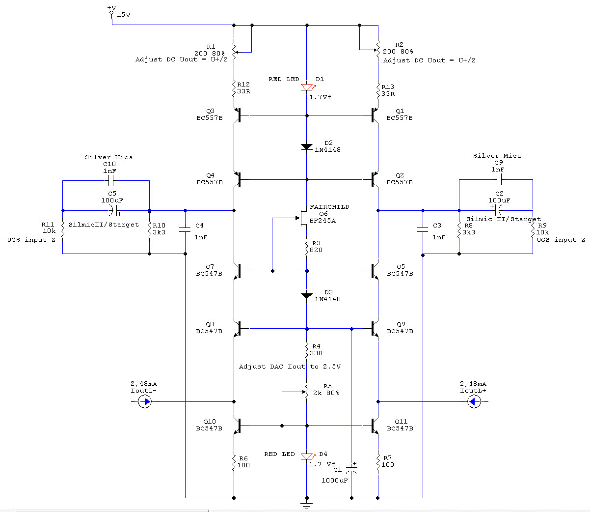

Final schematic

Anyway Got some pictures for you guys, the boards are ready to be sent to my local shop but before that i would appreciate a review by you guys.
Here they are as is.

I've been comparing the pcb layout images with the final schematic in post #221 and have questions/possible discrepancies. Note I cannot view the LAY files in #220 on my mac.
1) Pcb shows large C8 while the schematic has no C8. I think C8 is C1 on the schematic.
2) C8 positive terminal connects to Q7/Q5 base on the pcb but Q8/Q9 base on the schematic. Not sure which is correct.
3) Pcb shows 2 components called IVR but can't find them on the schematic.
4) Adjust R1 and R2 to U+/2. Where is U+/2 measured.
5) Can't find R9/R11 on the pcb.
6) R8/R10 in parallel with C3/C4 not labeled on pcb.
7) Dumb question but where is the connection to RCA out.
