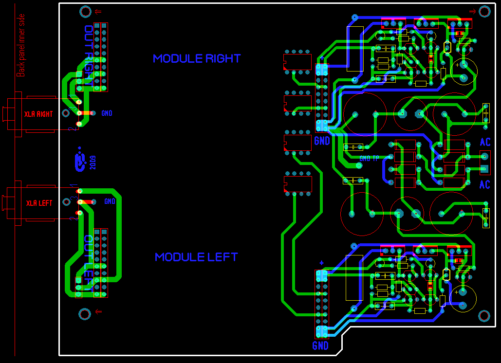

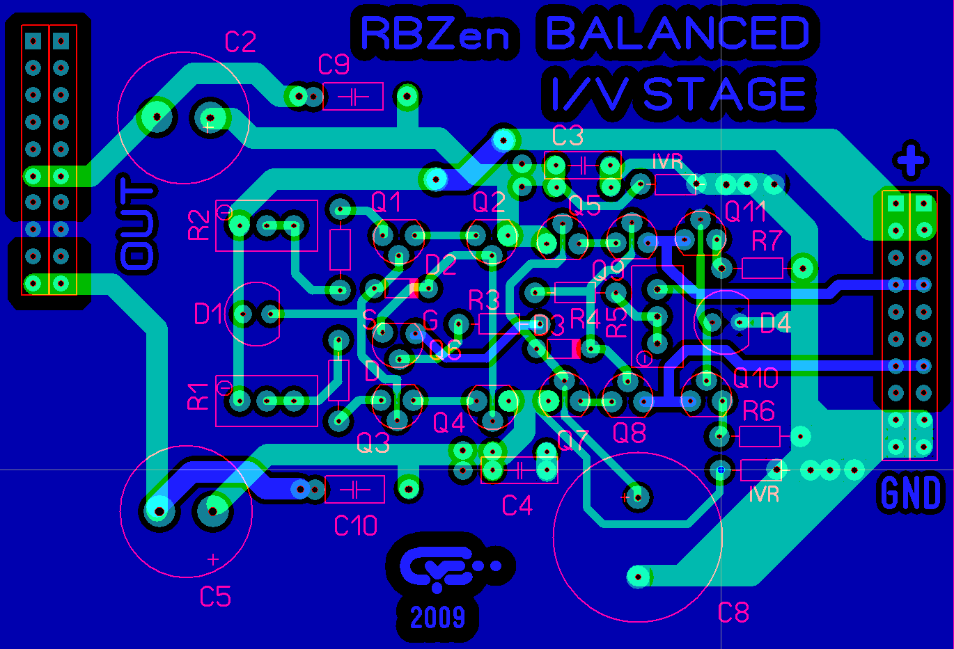

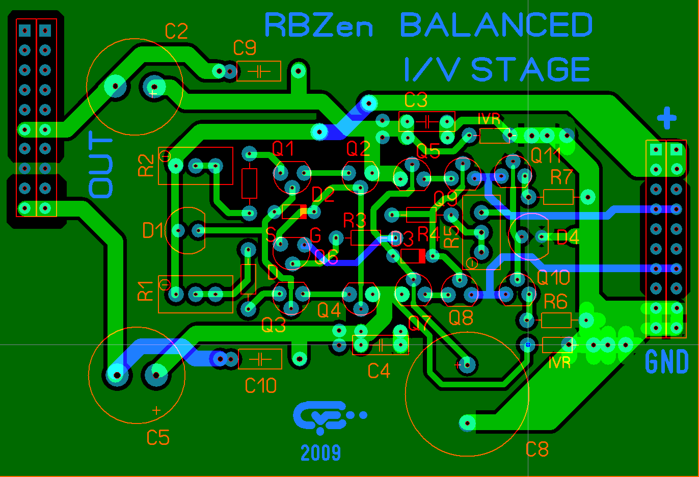

Anyway Got some pictures for you guys, the boards are ready to be sent to my local shop but before that i would appreciate a review by you guys.
Here they are as is.

joy is what's count;
joy of creation and joy of listening ;
nothing else really matters ;
if your ears are so sensitive to little changes in parts , you must find your own poison ;
in any case - polycarbonats are much more forgiving than Mica's ; for some ppl Mica is Mana from Heaven , for some other is Curse .
luckily , I'm not so picky in later years .... usually if I miss something , I just put another xformer in line with signal ........ :devily:
(while you're searching for few carbonats , try smaller Mica in parallel with Elna ; 10n Mica is dangerous creature , in every meaning 🙂 )

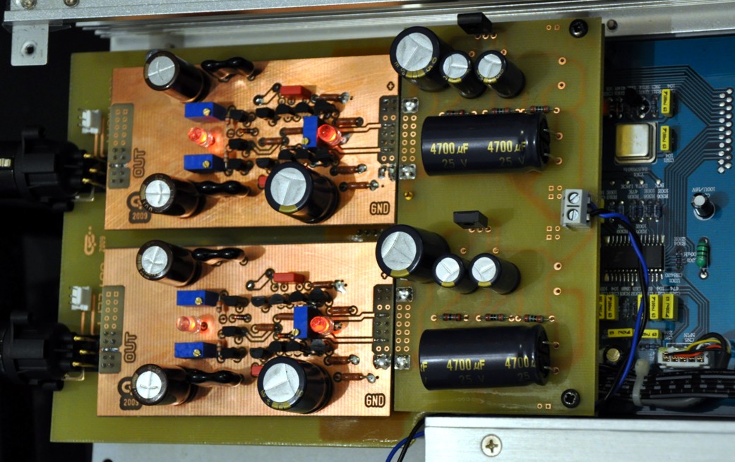

Ok it's final.
yesterday got round to calibrating both IVs, and pluging in the PSU.
I'm using the simplest option right now for PSU, a cap multiplier, next will be ctoole shunt reg, since i designed motherboard/daughterboard it's easy.
Switched on and dead silence greated me, i half expected some booboo but no! everything was perfect ....pressed play and sweet clear music came from the orions.
The diference from this sound to the rat's nest version is that it's cleaner and better defined but although it's got fantastic top end, it's not harsh at all,...or tiring.
here is piture, i'll post files next, schematic and pcb files for Sprint pcb.
It will be interesting for us to compare notes on diferent otions for output IV resistor and couplig caps/bypass caps as these do influence tremendously the character of the sound.
Right now i have ELNA silks bypassed by silver mica.
