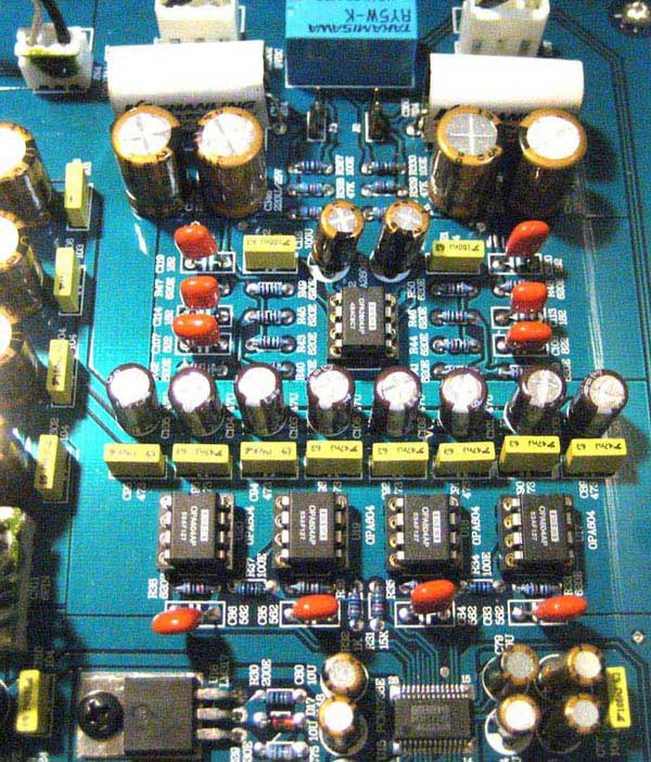

It seems like the Shanling suffers from a severe bout of DAC output overengineering...as a result the sound is ....nothing to write home about.
Here are pictures of the output section...with it's 6 op-amps.
I'm counting on the knowledge, wisdom and goodwill of ZM to help me along here, ...to get this thingy to sing !
DAC is:1738
Op-amps: OPA604AP and one double OPA2604AP

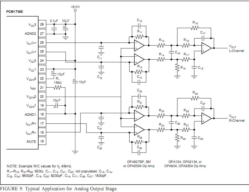

probably something straight from datasheet :
..It's a safe bet, they just followed the app note, but i'll take the board out just to check, it's easy.
At least the number of op-amps is right, 6 !....6 too many?
Finished checking.
...yep, that's the schematic they used.
All small electros and yellow nonpolar are power supply filtering.
Only the caps at the output are added by them ( initial picture , big white caps, large elctrolytics and relay...).

The '1738 has differential current output and no opamps, so you can mess around a bunch with the I/V stage. Lotsa versatility.

OK - I need some time to think what solution is easiest and have best PITA/result ratio
can you measure DC voltages ( ref. to gnd ) on pins 16,17 and 20 ?
do not measure directly at DAC pins , but on traces or - even better - on adequate OP pins

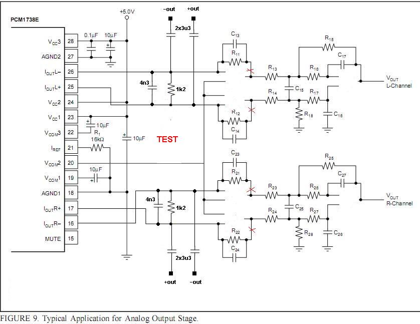

while we are at it ........ CeeVee - can you make small test :
-toss out all OPamps ;
-put 1k2 parallel with 4n3 - between + and - I outputs (DAC pins 17 and 16 , 25 and 26 ,respectively ) ;
-desolder one side of resistor placed across I/V conversion/filter OPamps (first to DAC);
-route output signal (via 3u3 in each (+/-) leg to output ;
-just listen - if you like what you hear in that raw test , we are on something
I hope that I'm clear enough , without attaching schmtc
edit:
attached test schematic
