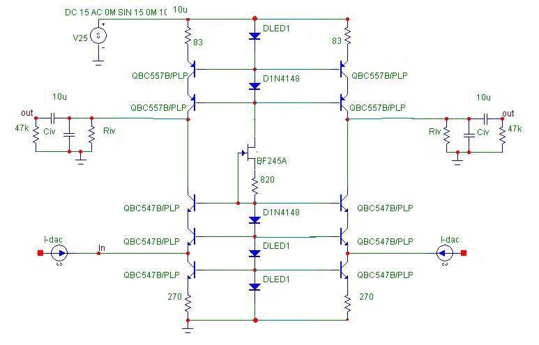

Some reference i've looked at:
Haiku I/V
- Loosely base on Nelson Pass´s mosfet version, so says Russ White, and he knows i'm sure.
- Schematic of Rudolf Boetje's proposal for an I/V stage for a current output DAC ( see bottom of post ).
-Gerhold Dietmar's FET_DCout

as I said - we will find what's most interesting to you 😉
Haiku is interesting , I'll study it later ......
Dietmar's stage is nice , but Jfet BOZ is nicer ...... primary because Papreamp is made with more "proper" part .......
and - it's not I/V conversion circ , what we need .
why reinventing the wheel
anyway - more I look , more I like it;

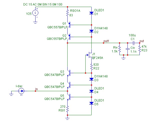

rudolf made it pretty clever ;
so - there it is , mirrored
Riv can be - for start, same as in Drekling ....... Civ , also same
you can also try also combination of 330E/10n
later , if you're in mood , you can try doubling 1N4148 (two in series , instead on one ..... in both positions)

as I wrote before -
thinkin' about that HF blurps .........
can you try to decrease these two resistors (between + and - I outs ) - put 330 Ohms , instead of 1K2
you can put 10n in parallel to both 330E resistors
try that first , then you can try Rudolf's variant ; it's simple enough to try on any protoboard .

Made nice balanced cables, checked again....and realized i had it connected wrong all along.
Connected again : between pin 2 of op-amp 1 and pin 2 of op-amp 2
( neg input ).
Op-amps are out, so it's just for convenience i use the IC socket.
...sound is great ! no HF rasping....it's cleaner and more open than with all the original op-amps.
Conclusion is that i had 6 op-amps too many.
Values i have now are 1k and 2n7 with 3u3 output caps.
...I don't think i need to test the 330R/10n option, but i'll do it just for curiosity's sake.

now we all have learn something 😉
if you're in ballpark with output level - comparing to original , then you don't need to try lover resistor values .
next - for fun , try Rudolf's mirrored version ; if I'm not mistaking , that can be definitive , with tweak or two .

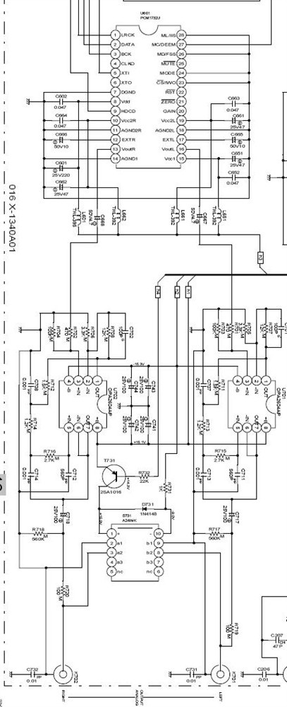

I'm also thinking about a similar mod, albeit on my Rotel rcd-02 player. This cdp was the biggest waste of money, and it's just collecting dust (I am still listening to an old Denon cdp).
Unfortunately, Rcd-02 uses PCM1732 dac, which provides only Vout...
The question is: Is it worth fiddling with, or shall I just forgetaboutit...

Somewhere I had found the relevant part of the schematics...
For the rest.. this player is free to play with! 😀
Internal photos may be done sometime nest week...actually I already tried something on this cdp...I had hooked a Jfet boz directly to the Vout of dac, but it didn't sound good...I even don't know how to describe the sound...somehow weird...now I'm thinking that I may have had some HF junk passing through....
So, I'm am willing to give it a second chance, with with some Hp filtering or whatever...
Vix
