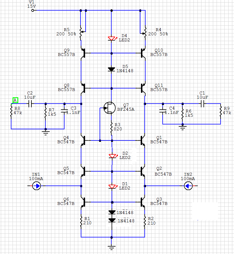

CeeVee said:Hi ZM,
So circuit looks like this now, with corrected values and pots in place for testing.
From my data sheet reading i think that the I/V resistor should be 1K...not 1k5 is this right ?
From Data Sheet : Vout = 2.48mApp.Rf
I think that you can leave fixed resistors for R1 and R2 ( either 200 or 270E) , because they're setting resistor for current through I/V halves ;
we don't need to make accordion of it 😉 , setting down , setting up , setting left , setting right
output resistors are not connected (at least not directly) with DAC datasheet values ; their value depends of your needed signal level , and exactly with decreasing just them , you can decrease output voltage ;
all other settings are solely to achieve exact DC level on DAC outputs , and Ub/2 on I/V output
or - try to set everything with that last schematic , then replace R1 and R2 with fixed resistors of nearest value
Ok ZM,
Thing is that i have to set Dc voltage on DAC outputs to 2.5V ...same as ref common voltage for DAC.
Right now it's at 3.04V...seems that the only way would be to lower R1 and R2 so that voltage across Q6+ R1 and Q3+R2 is 2.5V
...as for the accordion..that's the idea, ajust and replace with fixed resistor.
As a matter of fact i should do the same after testing with the top pots because they also influence the 2.5 V dc setting.

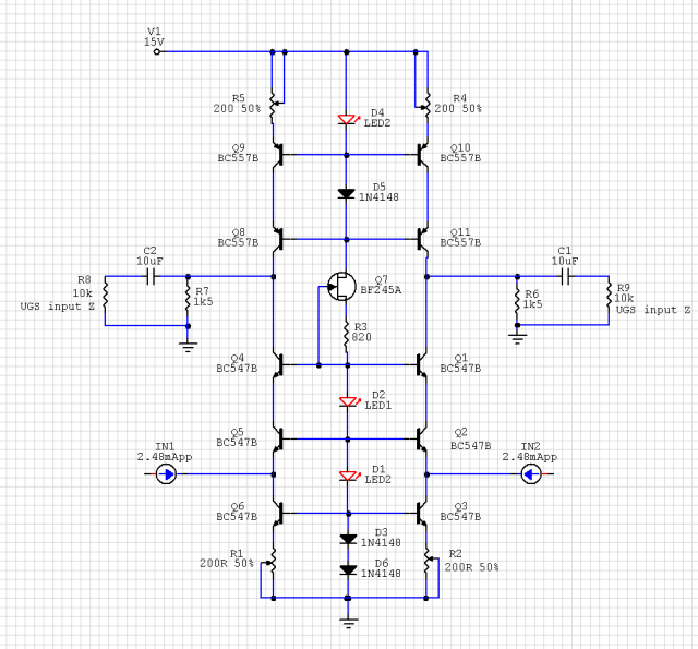

Hi ZM,
Bass is indeed at 2.5V...but i'm not there yet,
didn't have much time today but replaced the bottom resistor with
socket to make testing easier.
Placed a 25R in each and voltage at DAC output lowered to 2.87V.
Readjusted Ub/2....
Didn't change the double diode with LED yet but you know where i'm going....
How low can i go with the resistance....because I'll have to go very low and this means high current through the transistors....?
Edit: Adjustment of Ub/2 get increasingly more sensitive too and more difficult.

CeeVee said:Hi ZM,
Readjusted Ub/2....
if you decrease resistance in R1 and R2 , current still can be set/limited with R4 and R5 ...... so lower CCS-es ( Q6 and Q3 ) are sorta starved ;
anyway - replace these diodes , promptly ...... and try
keep greatest values of R1,R2,R4,R5 you can achieve ,with conditionss we have - 2V5 and Ub/2 ;
in case that you can't achieve that easy , we can change one of biasing diodes with resistor , without any harm .
keep me informed where are you with this , and what's happening with sound
