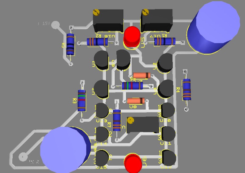

Ok ZM,
WOW...that looks good, I'll redo the PCB so i can test after returning from the Azores....luckily i got a bag full of BCs.
Steenoe, ....everything clicks into place when it has to.....your baby came of age just when i needed it !
Of course i have to thank Tony and Manu for so much work on a very well designed and compact PCB.

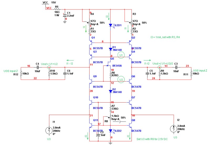

Anyway, i'm not idle in the important stuff...ie: I/V for my Shanling.
I'm waiting to have the Boards for the Toole Reg this weekend and i'm finishing the PCB design for the I/V ( last schematic ).
I'll be running some tests with the Toole Reg power supply this weekend and hope to do tests with the final scematic by the following weekend.

ok....changed PS for the circuit;
inserted the 10R 3900uF as per last schematic ( didn't have the 2200uF ).
Well......WOW!
Got all the bass i need and then some.
What a change! sound is still clean as is sound stage definition but now all the bass is there.
Can hardly wait for the Toole Reg boards and final PCBs for the schematic.
Great sound.......tks ZM ( it's not finished i know ).

...note edit on my last post....i'm using a 3900uF Rubicon cap not 3.9uF!
also i changed the PS i was using on speaker filter box for a Borberly all fet Absolute reg.
That also adds to cleaner more realistic sound.....I'm listening to Eric Johnson live.......WOW.
