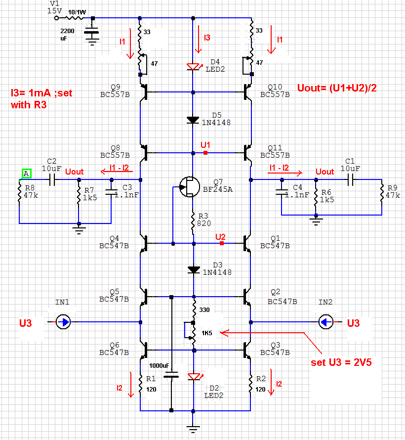

Hi ZM,
Today's report:
changed diodes and had to raise bottom resistor, right now it's at 820R, Ub/2 is set but top pot is at it's limit, won't give more adjustment.
DAC output voltage is 2.46V Dc...almost there.
Question is, do i raise top resistor ( pot ) ? and take bottom resistor to say 1K5, i guess that is where i'll have to go to get 2.5V at DAC output.

now just increase bottom resistors..... then re-set ; it's better when you have more symmetry between top and bottom CCS-es setting ;
that way I presume that you'll be in ballpark ;
you already are , anyway ....... 2,46 is pretty close to 2,5 ...... isn't it 😉
if you need to feedle with gain , change output resistors , nothing else !
if you are "almost there" with bass , but you already have needed definition , than is time to implement better supply for your I/V .
that will give you that last missing part of bass , both bottom and definition .
I presume that overall sound didn't change to worse ?

One issue you did not address, on one of the top pots i cannot quite adjust to Ub/2 because the pot is at end of travel ( 200R ).
Should/ can i raise this value to say 300R ? to get Ub/2.
It's almost there ( 7.56V ) but i cannot get to 7.5.

naah ...... just leave it as is ; it's good enough ;
having Ub/2 is just to be sure that you'll have symmetrical clipping , and you are near enough ;

nope Shinyy - it's symmetric ; you need something as Shiny - just positive supply ; or newest Steen's pet I mean that's Tool Reg ;
whatever you find more convenient , regarding pcb size ;
just listen few days , and we'll maybe try to recalc few values to increase overall current through stage ....... that way it will sing even better

my intention is that we can implement pot+elco instead one led , in biasing string ;
that way , we can set entire gadget pretty easy ......

finally
now ( blame my lack of time ) everything clicked 😉
look this ... and try - whenever you have time
overall consumption around 30mA per channel
power up , check I3
set U3
then set Uout on both sides
Uout ISN'T Ub/2 !
