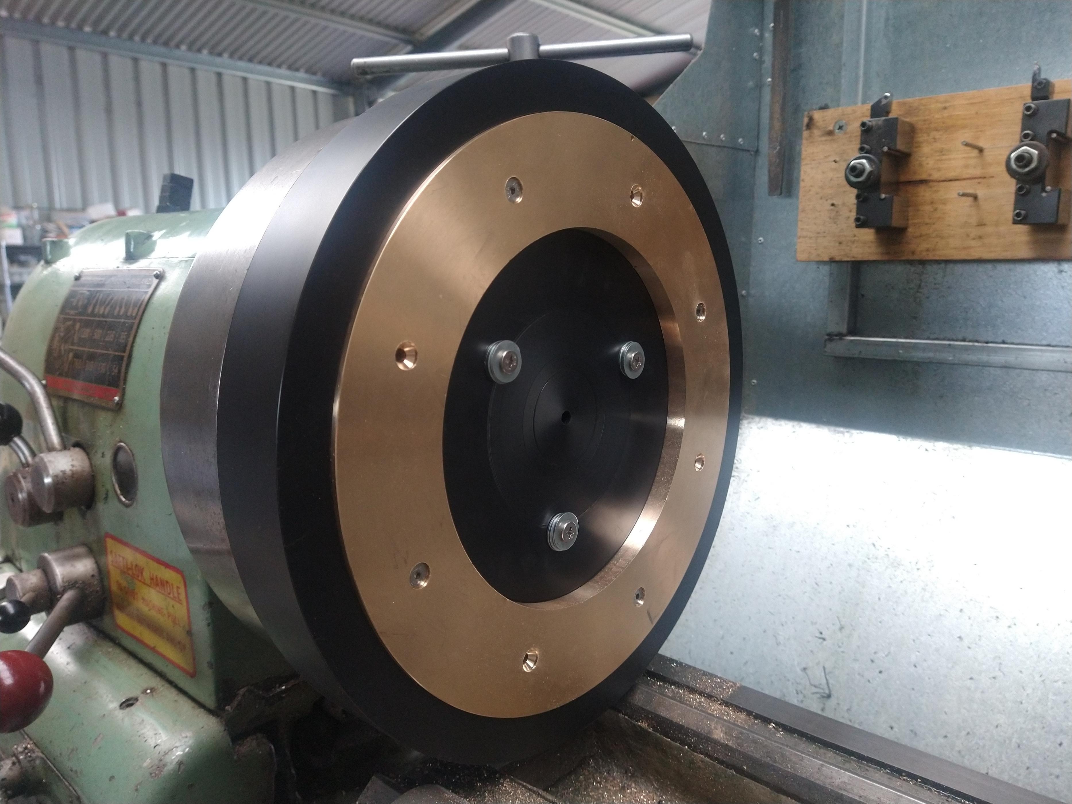

Have you tried POM, I have made 6 platters so far for SP10mk2 Stainless Steel, SS/POM, Gunmetal, Gunmetal/POM and OEM/POM. Bolting 20mm POM to the OEM platter damped ringing effectively.
The best by far is thick 40-60mm POM with a ring underneath to keep COM low and provide some rigidity to the platter. This platter also uses a de-coupled spindle, the LP spindle does not touch the motor spindle.

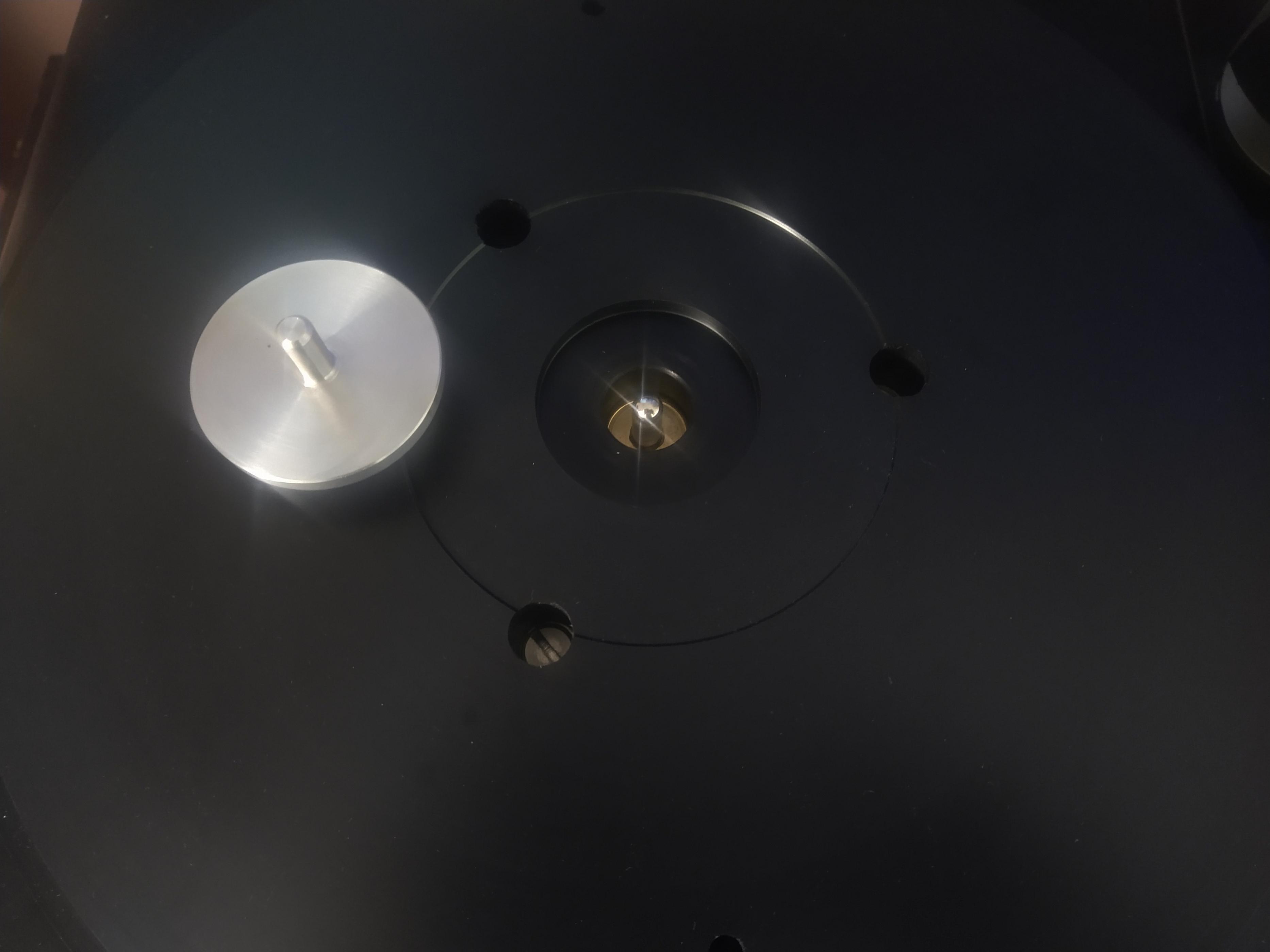

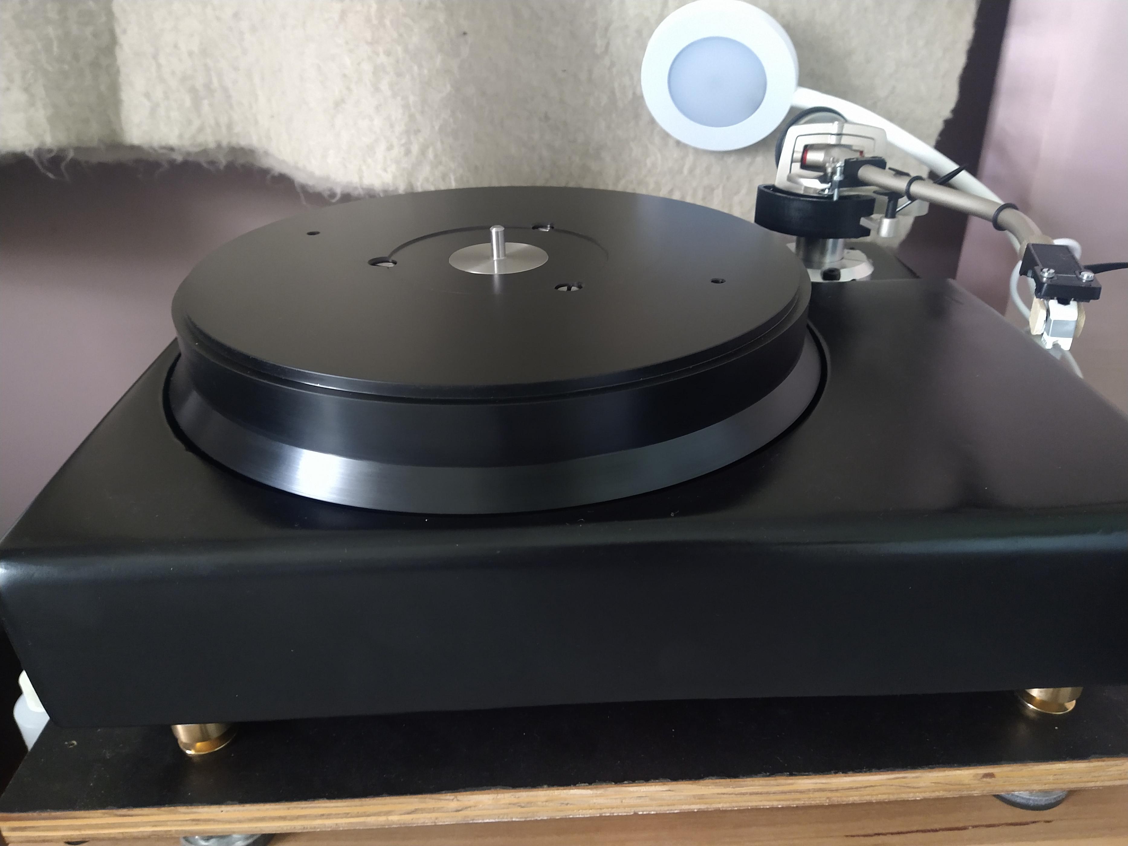

I've been running a de-coupled spindle since I went to 20mm POM bonded to a base. 40mm thickness allows the addition of the de-coupled spindle without having to cut the OEM spindle.
I have spent a considerable amount of time designing, making and testing various upgrades to the SP10mk2. Removing the motor from the OEM chassis and mounting it in a well damped resin/bentonite plinth and the POM platter have made huge improvement on the already competent SP10.
All of the mods were intended to increase rigidity of the motor and damp vibration energy.
A list of mods
Decoupled spindle
60mm thick POM platter
Damping added to the inside of the motor housing
Motor mounting modified from 4 to 3 bolts and fixed at 3 points. So the motor mounting face does not touch all the way around
Bearing collar clamp fixes the bottom of the bearing housing rigidly to the plinth.
Any mechanical rotating component will exhibit noise. I found my contact mic nowhere sensitive enough to measure bearing noise. A phono cart is way more sensitive.
My method for measuring bearing noise is to place the stylus on a gauge block on the plinth monitored by a HP dynamic signal analyzer. Reference set with a 7cm/s 1kHz tone played and markers set to reference.
Spin the platter by hand and the HP picks up the bearing spinning albeit 70dB down. I know it's bearing because you can see the peak track down in F as the platter slows.
I subscribe to the Korf blog and seen that clip. It was the motivation for me to experiment with the de-coupled spindle.
My theory is, most of the energy imparted into the bearing comes via the platter as the LP/spindle interface is quite small. (I will test this one day). Some/all vibration energy traveling down the bearing will be reflected back to the LP via the platter, how much depends on the topology of the bearing/ball interface. 40mm POM has better damping properties than a metal spindle.
I have made noise floor measurements. Play a 1kHz 7cm/s tone and measure narrow band 0-200Hz, with the POM platter and de-coupled spindle noise floor dropped 3dB. This is audible

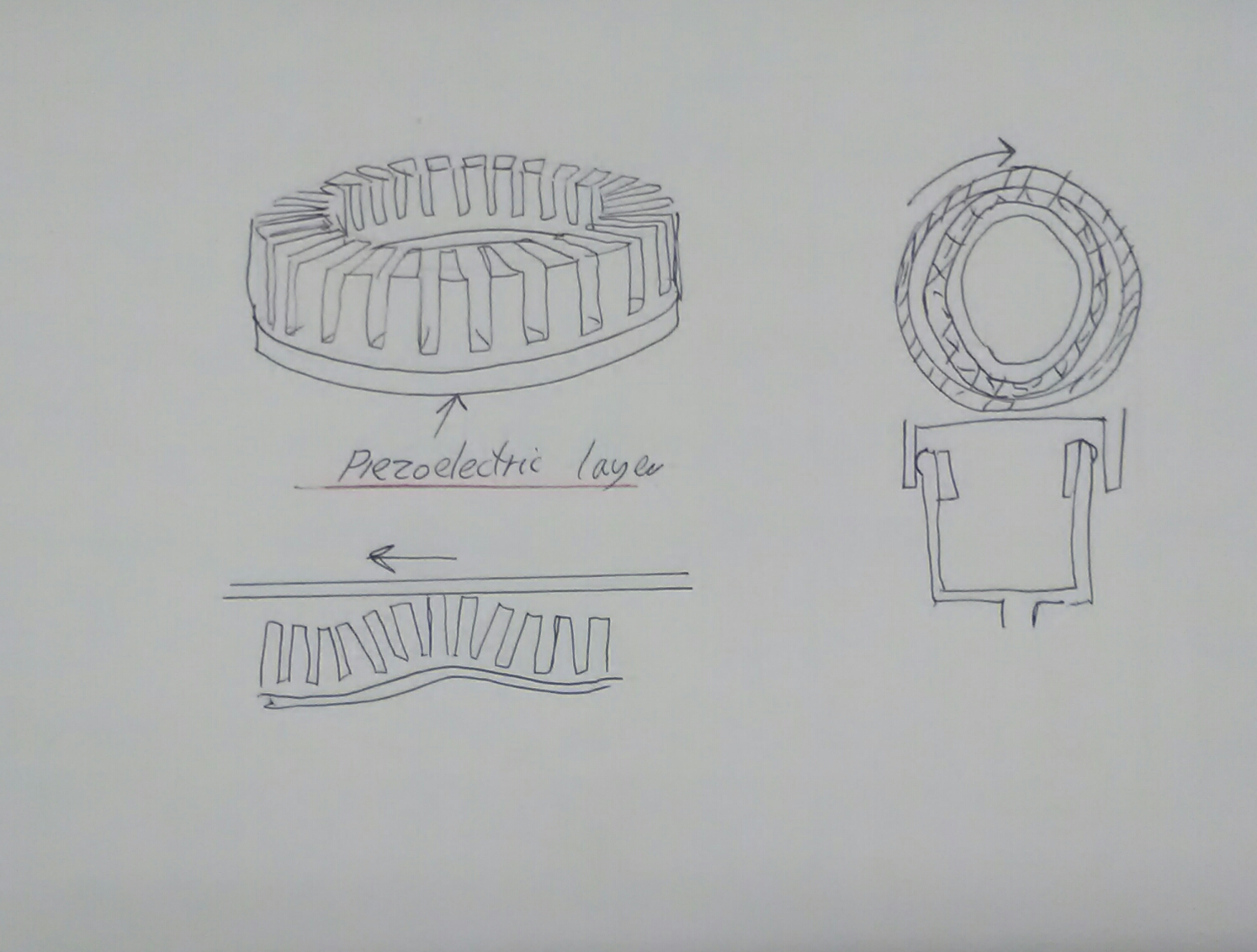

Many years ago, on tomorrow's world ( a UK TV programme ) they showed an new design of electric motor that was going to "revolutionize " tape recorders and Walkman's, it consisted of a slotted metal ring that had a piezoelectric layer underneath that caused it to flex and " walk " a ring with a similar action to a caterpillar, can anyone else remember what happened to this invention? On the right I have drawn a different design that would reduce the possibility of the " legs " taping on the revolving surface, causing vibration.
I miss programs such as tomorrow's world, QED, horizon, the secret life of.... ( with Tim Hunkin), and despair at the current drivel.
That's basically a strain wave gear with a piezo actuation layer, I can see uses for it but probably not for those applications.
A coreless BLDC direct drive is probably going to be superior in essentially all ways.

Tomorrow's World ( a UK TV programme ) showed an new design of electric motor that was going to "revolutionize " tape recorders and Walkman's, it consisted of a slotted metal ring that had a piezoelectric layer underneath that caused it to flex and " walk " a ring with a similar action to a caterpillar.
That's an ultrasonic motor, which has found wide-scale adoption in camera lens focusing mechanisms.
