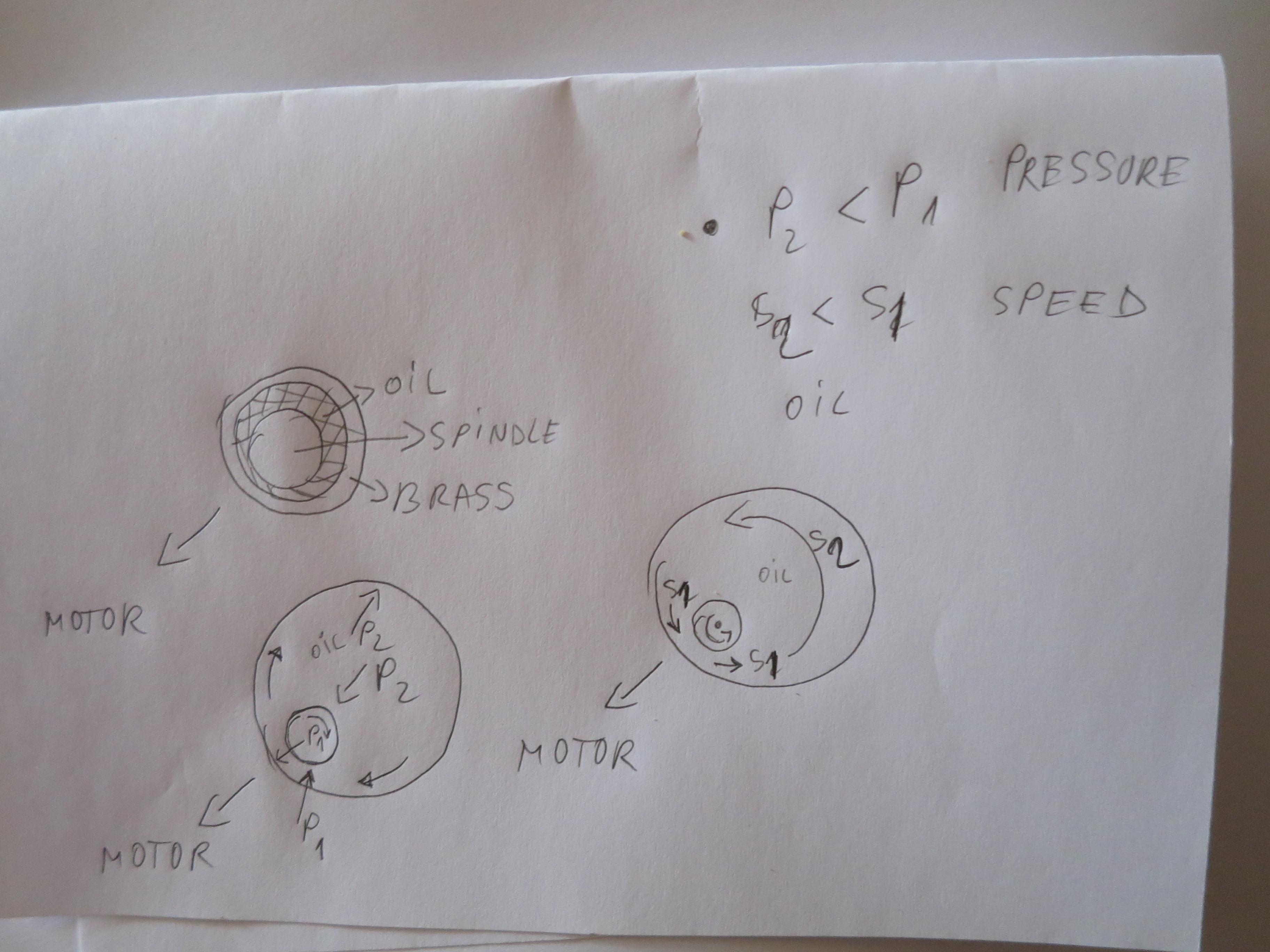

I already mentioned the wing aerodanamics operating in one motor driving the spindle from one side like in a belt or idle drive , but i feel a drawing was necessary.
Although some might say it does not apply to audio turntables because of the slow speed of spindle spinning , it's not true because of the micron size clearance between the spindle and bearing .
The pictures are exagerated of course , but here's why one motor traction is actually making that system much more stable than a 3 motor system.I've put the link to Neumann Lyrec motor, but nobody said anything about the hidrokinetic transmission that also contributes to stabilizing the platter center spining, not just to lowering the noise coupling. In Neumann system is the bearing that rotates driven by the motor and the fluid between the bearing and the subplatter spindle( a bigger one, of course).
Just curious :when SP-02 motor came , was the hidrokinetic system discarded too?

Yea when the Lyrec is upgraded to a Sp-02 the oil cup arrangement is removed.
in a Lyrec install the motor goes in the bottom of the lathe cabinet and connects to the bottom of the oil coupler via a drive shaft with a couple of spring joints to take out any misalignment, speed stability is basically ensured by platter mass.
There are limit stops in the oil coupler and a pair of springs to centre the thing when running, but it can still move by a 1/4 turn or so before it hits the limit stops. The oil provides damping but is not (steady state) involved in the power transmission.
In an Sp-02 install the motor, drive shaft, oil coupler and all are removed and the lower platter directly connected to the motor (which mounts where the oil coupler used to be).
