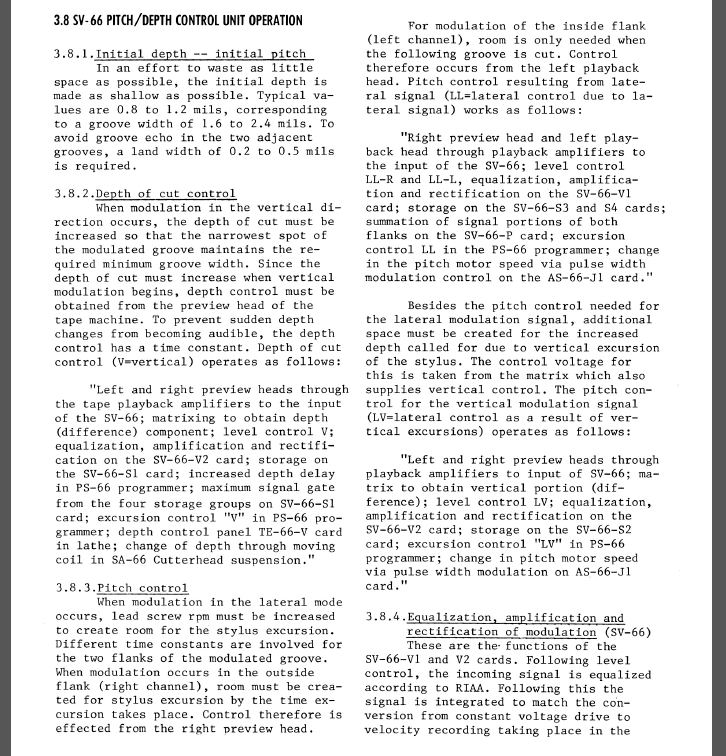

@dmills, do you have any recommendations for literature that covers the cutting depth topic in detail? I am aware that the lacquer layer is only about 0.2mm thick, therefore cutting too deep and into the aluminum substrate below would be catastrophic.
The literature that I have been able to find suggests that the depth limiting is accomplished through mono summing of LF content, and keeping the cutting stylus rake angle at 90 degrees to the groove. (I haven't been able to find any literature from the studio industry that supports Jon Risch's contention that orienting the playback stylus rake angle at 92 degrees to the groove gives the most accurate results.)
However, an article from the July 1975 issue of Studio Sound states (for mono discs) "research indicates that the chisel should cut the disc at a trailing angle of about 88º. A trailing angle of less that 90º is essential to exclude the possibility of the chisel digging into the disc surface."
For stereo discs, the same article continues "research indicates that the chisel should cut the disc at a trailing angle of about 75º."
(presumably since stereo LF content of the left channel will be out of phase with that of the right channel, causing the chisel to cut deeper).
This would make sense if a key goal was to keep the cutting chisel from digging too deeply into the 0.2mm-thick lacquer layer, but this position is not supported by the other articles that I have been able to find.
Any recommendations for reading material that could shed additional light on this issue will be highly appreciated.

When he's talking about the "rumble" added by a variable-depth lathe, it is discussing the up-down adjustment movement of the depth system in the cutter head drop box imposing its own signal on the groove.
Like a variable-pitch system responds to (future) magnitude of signal by advancing the carriage more quickly, the variable-depth system on some late-model lathes ensures that only the minimum required depth is cut, to keep the groove narrow except when more vertical modulation is needed from out-of-phase signal. One must cut deeper in total to prevent the "peaks" of a vertical modulated waveform from becoming too light and narrow of a cut.
One would need to look at the schematics of the Neumann variable depth electronics to see lowpass characteristics of the adjustment, and come up with a description of the signal added by it, which is probably lower than 10Hz.
As far as spec: "On stereophonic records, the instantaneous groove width should preferably be not less than 0.025mm, the average groove width should preferably be not less than 0.035mm" Depth = width / 2. One can cut much wider and deeper grooves, but a wide groove will use up disc real estate.

There are almost 200 pages spread on 5 manuals about how this thing works and 2/3rd of them are the electronic schematics...When he's talking about the "rumble" added by a variable-depth lathe, it is discussing the up-down adjustment movement of the depth system in the cutter head drop box imposing its own signal on the groove.
And still doubt that any noise or signal from variable-depth could be considered "rumble", as this is the first I've ever seen such an idea contemplated even academically - It might rather be described more like a micro-warp, as we slowly move 0.1mm deeper to anticipate the start of "vertical modulation tracing test" I sent to be mastered. A cartridge will tend to follow instead of transcribe low frequencies below tonearm resonance.
With amp signal disconnected and some worst-case full-modulation test pulses, one could cut only the output of variable depth into a silent groove.
