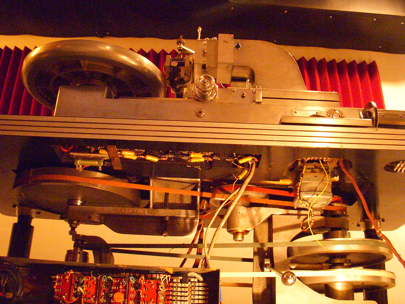

The Scully motor uses a complicated belt drive system.
Two Scully lathes are used in Bernie Grundman's mastering studio but he eliminated the belt drive systems and replaced them each with an entire Technics SP-10Mk3 direct drive turntable which includes the SP-02 motor. So every record you own that was mastered at his place is the sound of the SP-10Mk3.

In case people want to look at the original stock motor and drive system of the Scully lathe, here's a post of a restoration.
Looks overly complicated. No wonder many studios decided to replace them with direct drive motors!
