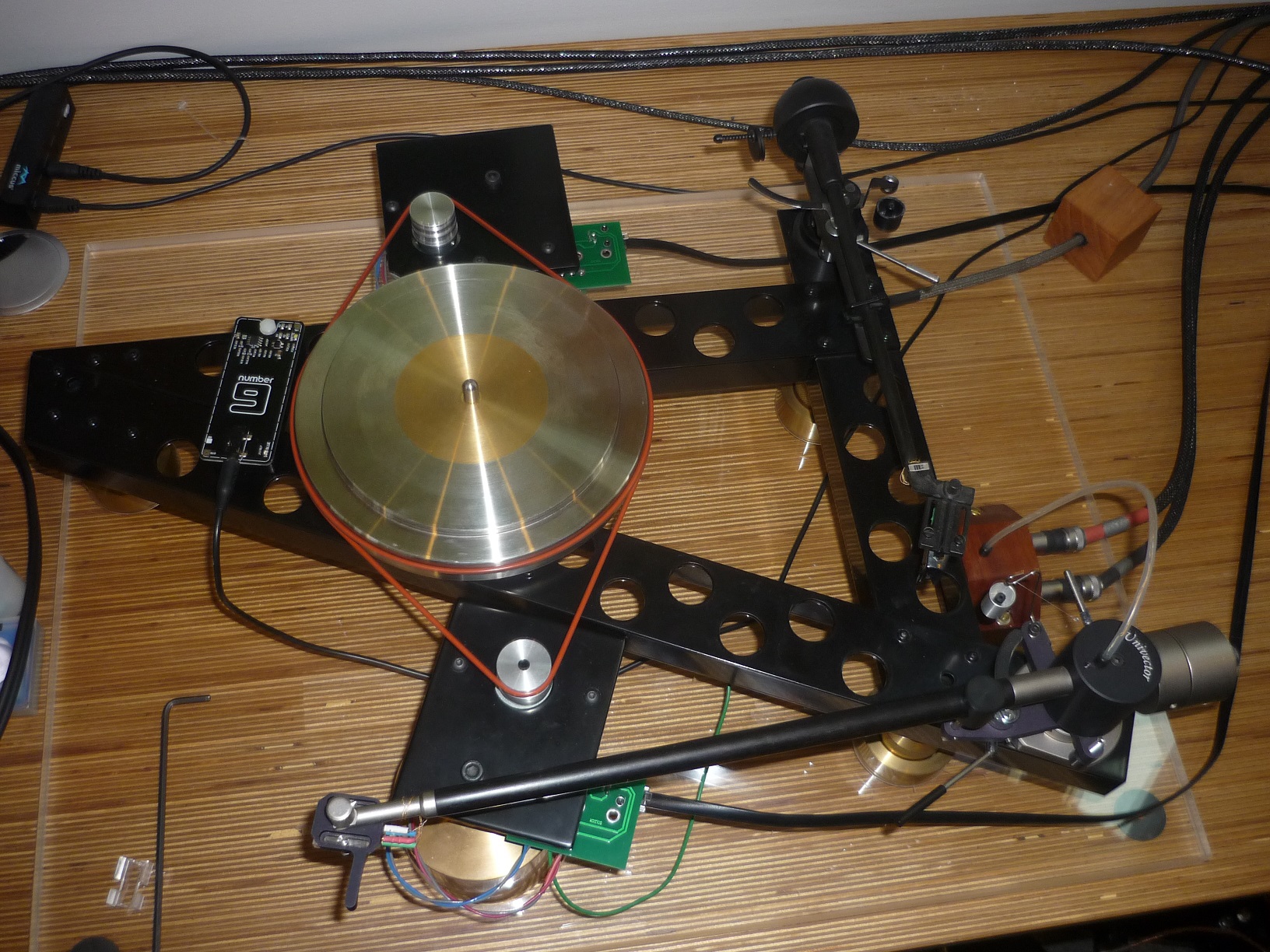

As i don't like asymetric drive by nature i use an external axle as well. this is placed on the opposite side of the motor/drive. The string is tensioned between the oversized pulley and this external axle. The air bearing platter is coasting in between.
Why not simply use 2 motors (each with its own belt) at 180 degrees orientation ... as I did?

Of course, you need to have a motor speed controller that is set up to drive 2 motors (there's a phase difference between the two motors). The 'Number9' that I use was designed with this in mind. 🙂
Andy
Hi Andy,
i didn't have the space for another motor at that location.......
so i had to settle for the next best thing......
To be fair i tried a 2 and even a 3 motor drive at another turntable but never got that perfect (motormanagement to get those motors to work in correctly). Instead of working together these motors tried to compensate for each other. It ended up as too nervous and not stable.
So when i did this monster i wasn't unhappy that there wasn't space for that other motor/drive.

And officially i'm not an engineer , i hold no engineering diploma in any field, never attended any university courses other than on Youtube, I just do engineering based on some 8 years of physics and chemistry studied in schools ...Up untill 25 years ago i was doing 7 hours of physics and 6 hours of chemistry every single week in highschool.I can't say i was the snappiest kid at answering those quetions, put by my teachers, some knowing me might say i was rather a mediocre student compared to the worlsd's olympics medalists I had back then studying in the same classroom with me , but i won't allow my perceptions about my rather horrible teachers to put a veil on the science itself...
Absolutely! And definitely what you did is the next best thing. 🙂Hi Andy,
Reinout
To be fair i tried a 2 and even a 3 motor drive at another turntable but never got that perfect (motor management to get those motors to work in correctly). Instead of working together these motors tried to compensate for each other. It ended up as too nervous and not stable.
Yes, I know the problem. I could only do what I did because the 'Number9' AC motor speed controller which I use is set up to handle 2 motors (with independent setting of the motor drive parameters).
Andy
A well reputed Germany manufacturer is using this system.
Rgds
Adelmo

Hi Dreamth,
I instead believe that 2 motors and a Fly Wheel to drive the platter are an improvement ( VPI and others have developed it ). A heavy Fly Wheel with similar weigh as the platter such as around 5 Kg ) needs 2 motors for torque reason.
I have also tried an attempt to make it, unfortunately the fly wheel made by the lathe guy did not have the necessary precision and was not well balanced so gave some short coming, but regarding the speed stability and dynamic of the sound was an improvement VS the single motor.
Allow me to add that type of belt and length is also important so the system need e total matching and not just a simple single or double motor....
Regarding the type of motors and controllers, well..........it is a jungle, almost an endless debate.

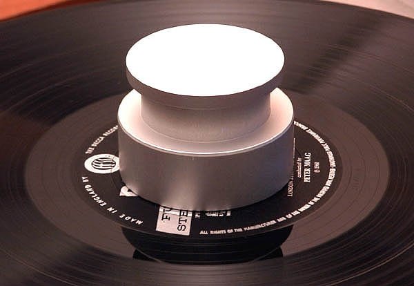

I have a somewhat off-topic question here, but I see that there are TT specialists.
I have a weight for vinyls similar to the one in the photograph that weighed 1.5 KG.
My turntable's DD motor is not very robust, so I decided to take weight off it so as not to overload the vertical pressure on the bearing. (I don't really know what it is like, I imagine it will be a ball dipped in a high-density oil, because I had a hard time putting it back in its place)
I managed to get it down to 0.900 grams. But I think it's still too much, so I'm not using it.
The TT platter weighs 1.5KG.
Thoughts ?

HI,
I suppose it is a puc from the picture. Usually they are used to get a better sound coping with different issues. I have a puc 0.5 Kg and I need to use it as my platter is made of acrylic and the record without the puc could slip and sound worse. Indeed sound worse as I have tested, but that is my specific case.
As general speaking the puc are usually 350 to 500 grams unless there are special reasons to need a more heavy one. There are also clamp that weigh very little but clamping on the spindle help to press down or flatten down the record to the platter/mat.
What is in reality your goal. The record does sound better with the puc ?
The puc match well you mat and so the record sound better?
You have copper of other slippery platter and need a puc?

If honestly needed, like for cupped or warped records, and a weight is not wise, use a "lighter weight"clamp type stabilizer instead.
Those clamp to the spindle instead.
12russel3456 and wiseoldtech:
I know the anchor fittings, it's just my concern of how strong the motor is to put 3/4 of its extra weight on the bearing.
Anyone know exactly how is the bearing inside?
The mat is rubber, I don't have warped vinyls and I don't hear differences, but it's just a curiosity.
