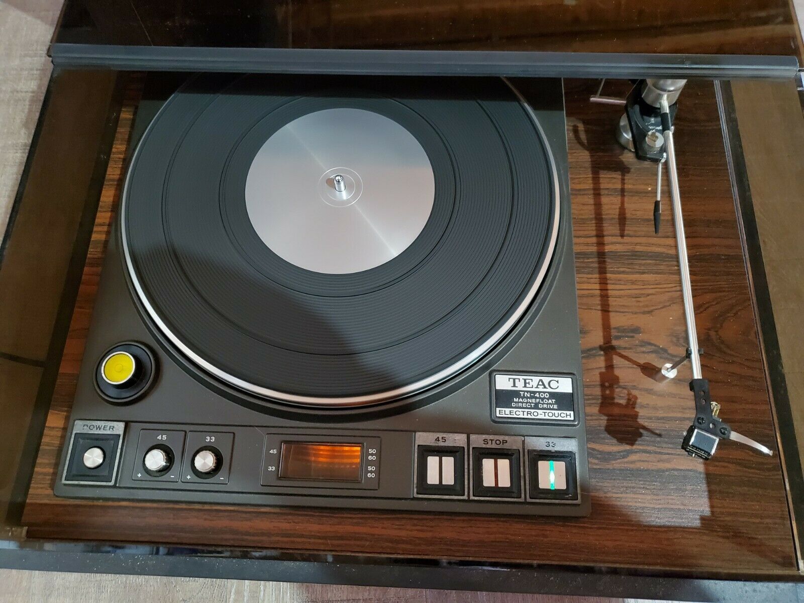

Teac TN400 made SP10mk2 pale for its magnetic levitation system, beating it in wow and flutter, boot time, etc, etc.
I never understood why it was not a massive success and so few people adopted.
Is it one of those two?
TEAC TN-400 Magnefloat Giradiscos Tocadiscos JH Formula 4 brazo De Tocadiscos Shure V 15 | eBay
Magnetic levitation by itself sound wonderful but it's completely useless without lateral thrust air or liquid high precision bearing so why would you even bother with it?I spent some time on vinyl cutter sites and finding that a Neumann cutter is using regular ball bearings made me really doubtfull about all this bearing fuss.We should hear the Neumann ball bearings noise on virtually every record made in Europe yet we don't

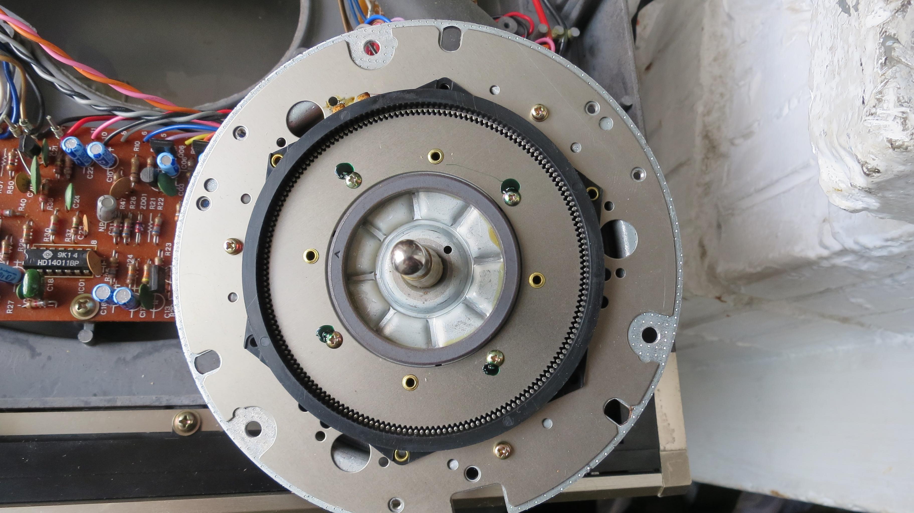

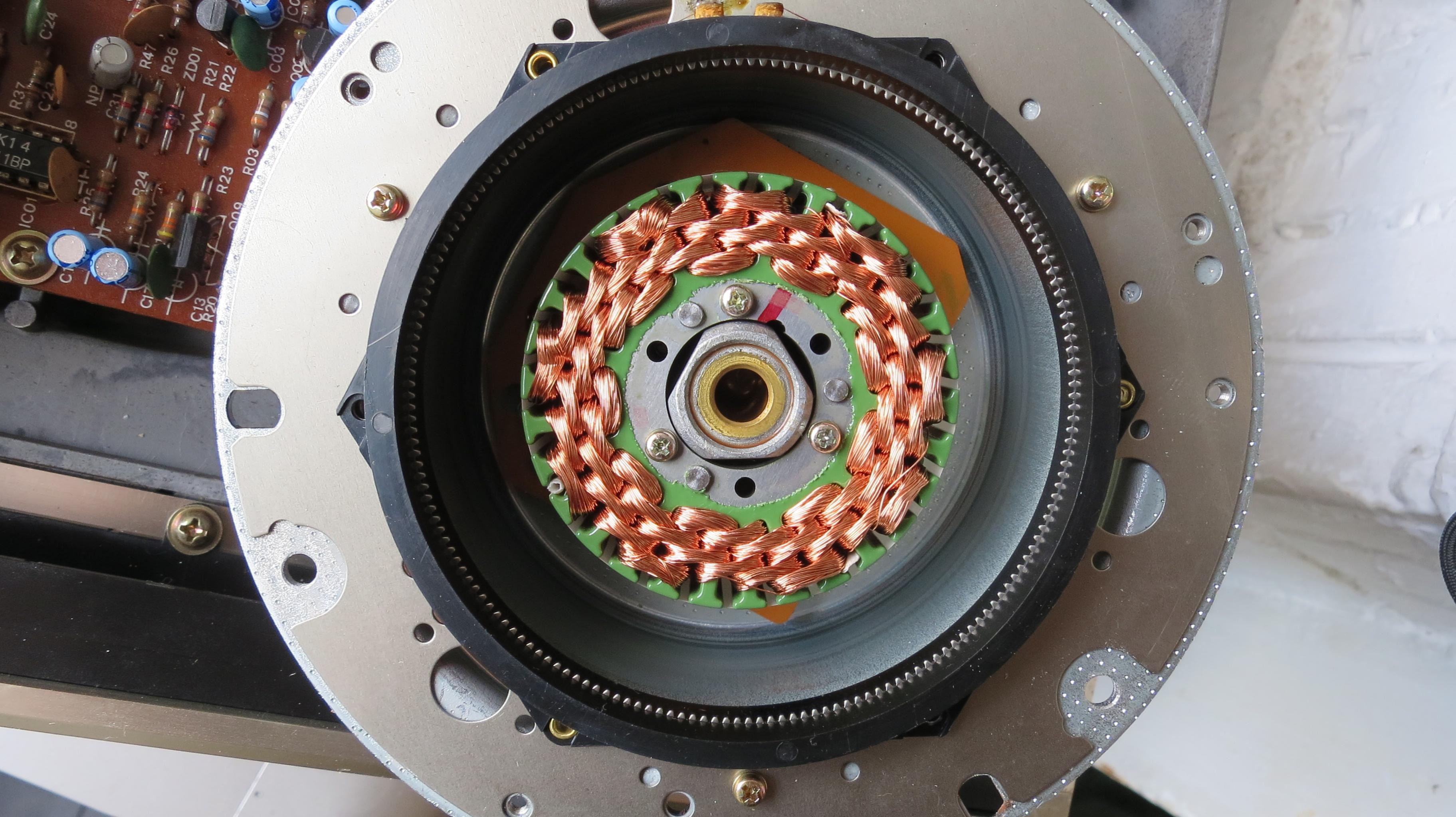

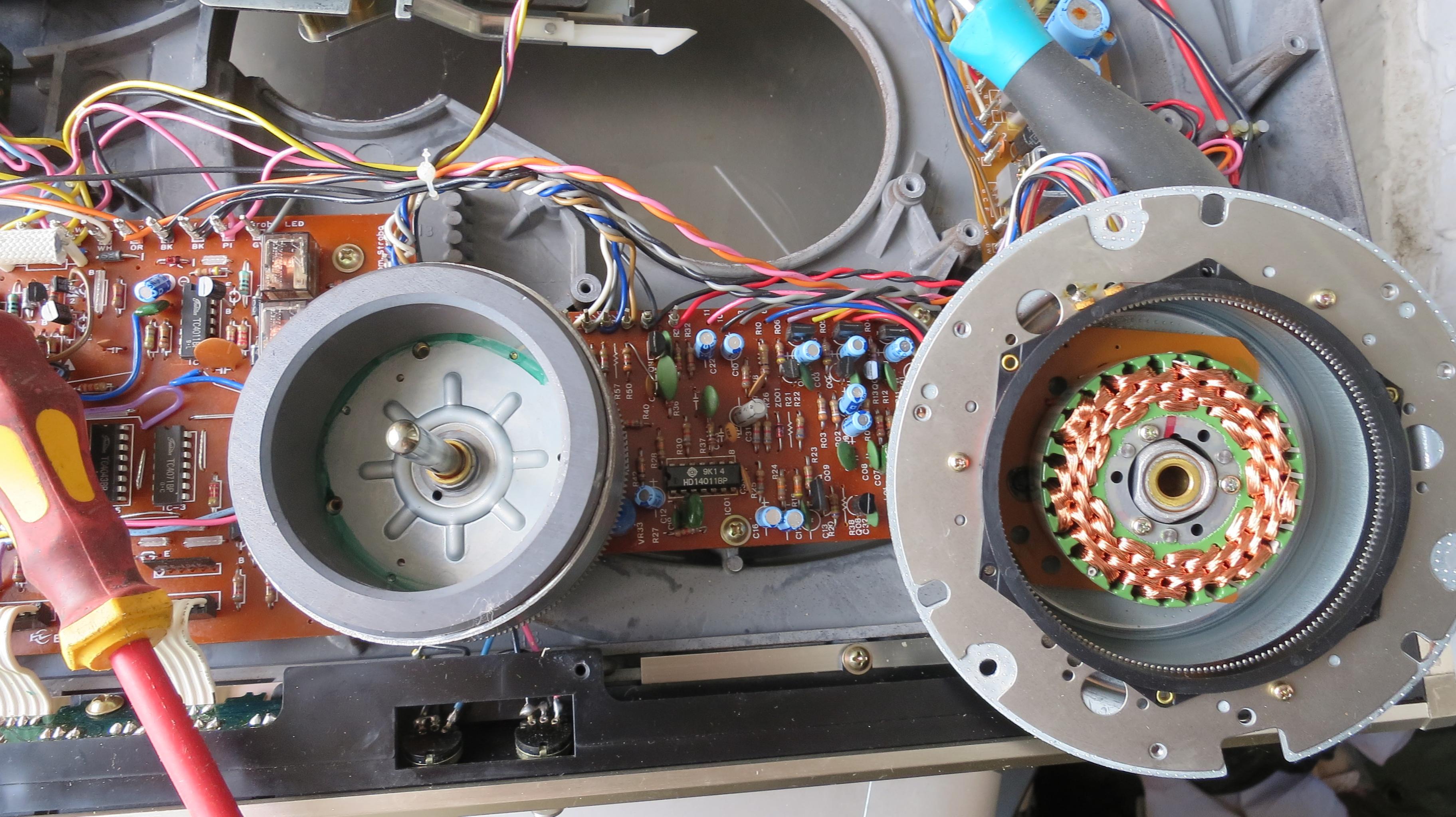

if you look at wiki definitions of complete magnetic bearings you spot that they are preffered especially for high speed moving parts while a turntable can hardly qualify as such...if there's smth i like about that teac is its 20 poles motors that was used in other models that thank God were not dicused on diyaudio so that their price go sky high.Here's a motor made in the 70's with such high finish and precision that it literally floats on air.Mine doesn't have 60 slots but it's way better than the best Technics one...
