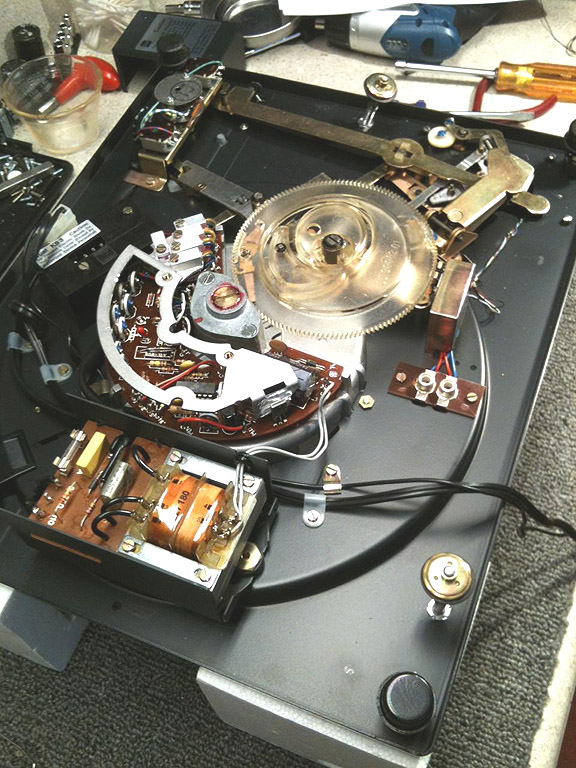

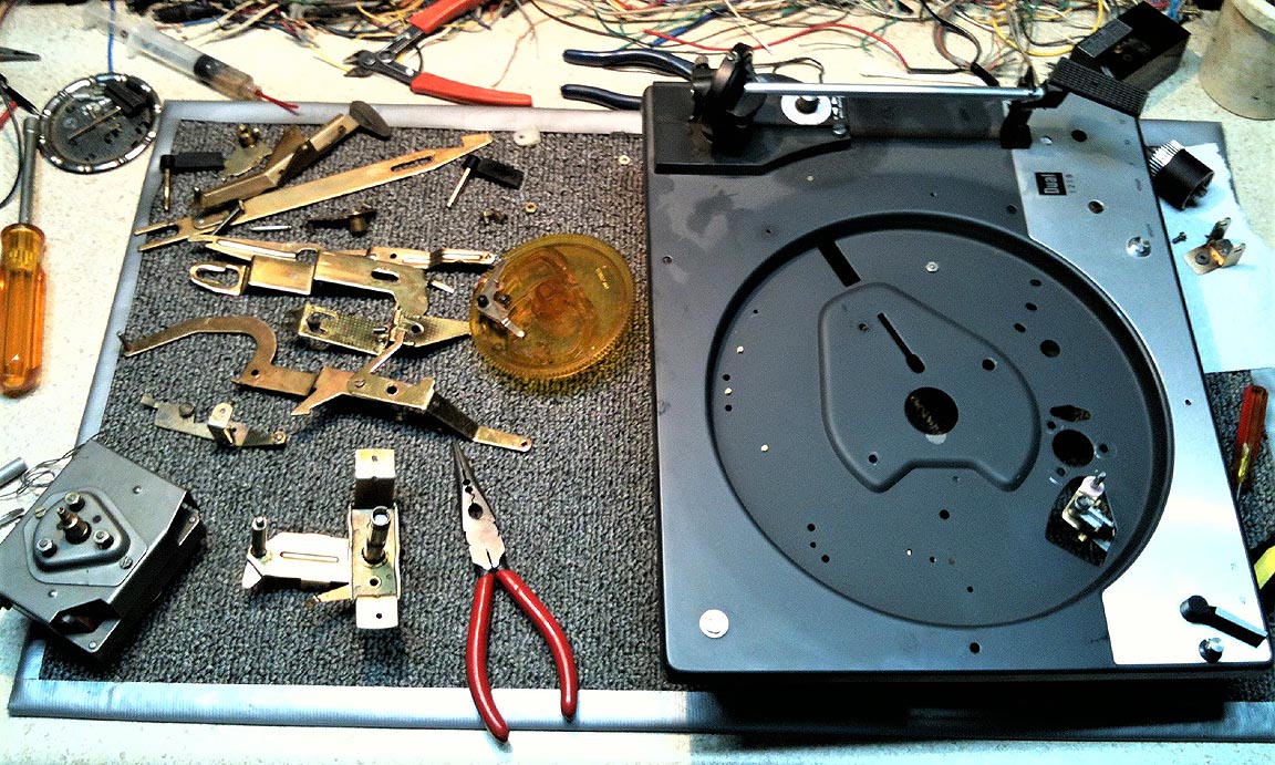

And being an experienced servicer, I've no problems tearing into a Dual today to bring it back to perfect operation.
I just finished up a complete restoration of a 1218 for a friend of mine, he kept it looking pristine, however the lubrication was old and needed refreshing.
And it plays like the day it was first made now.

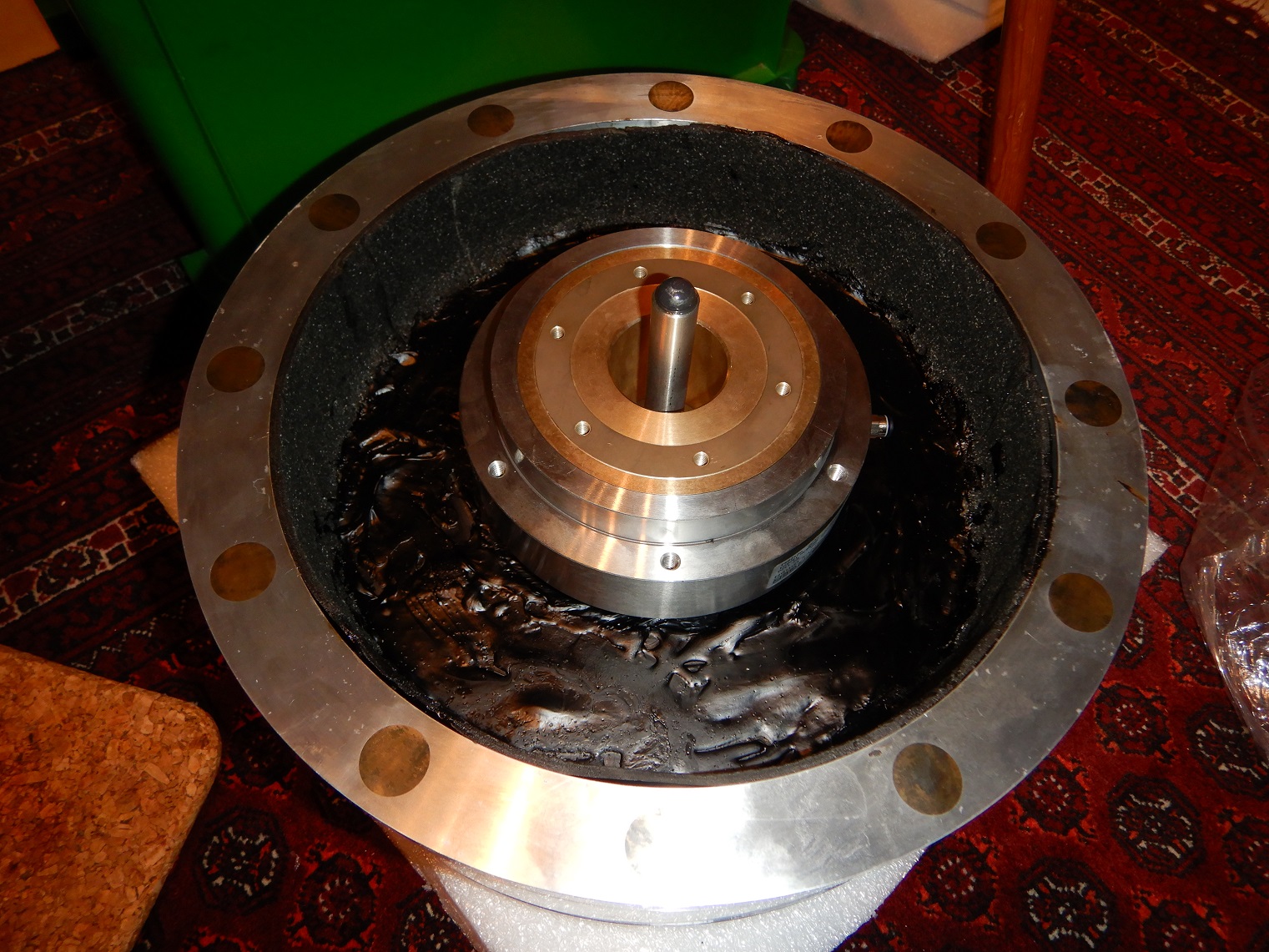

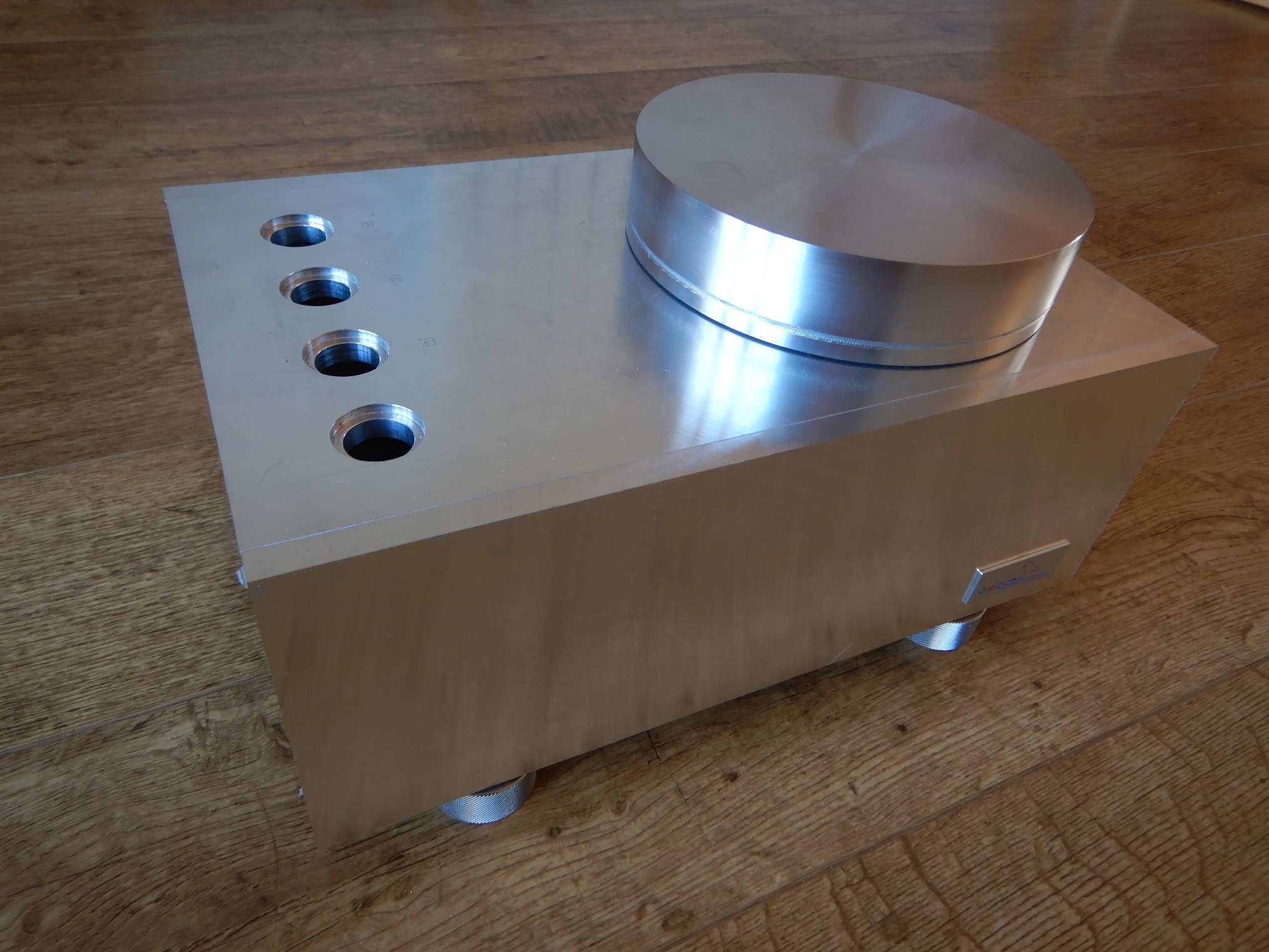

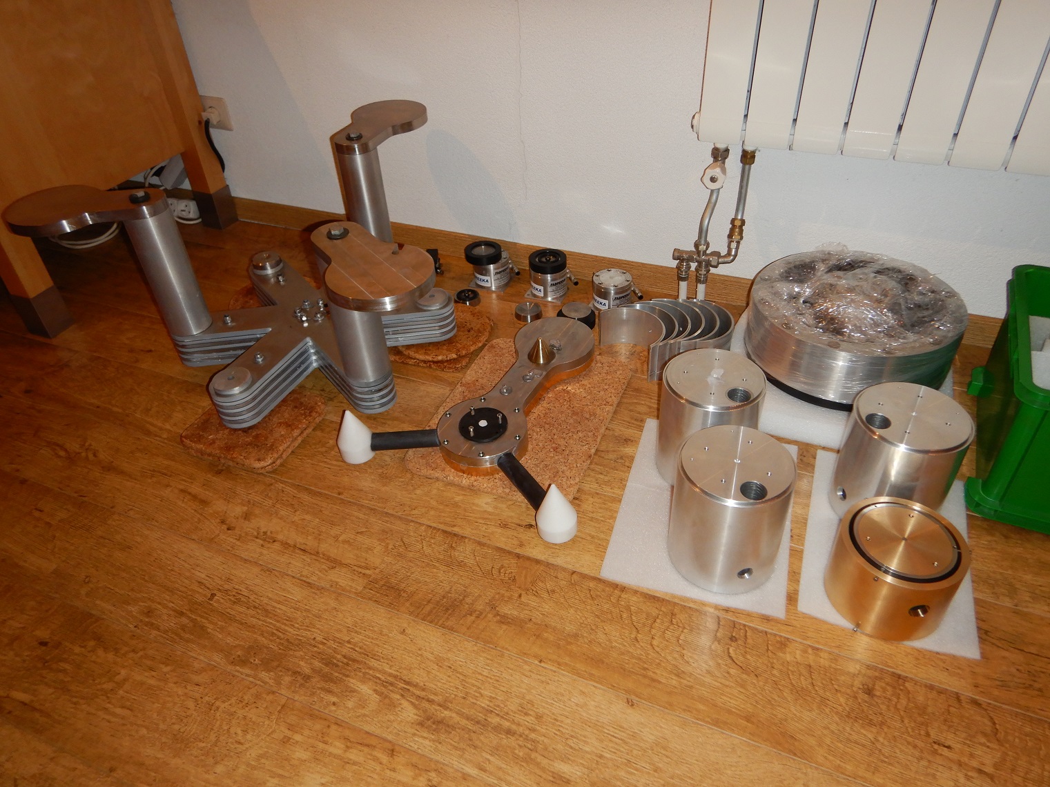

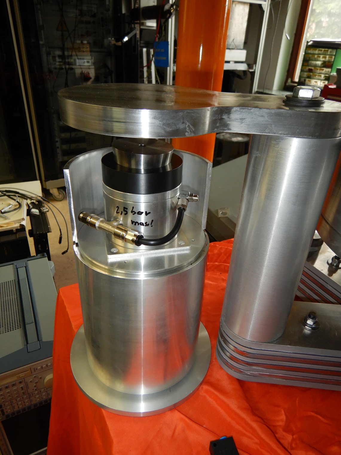

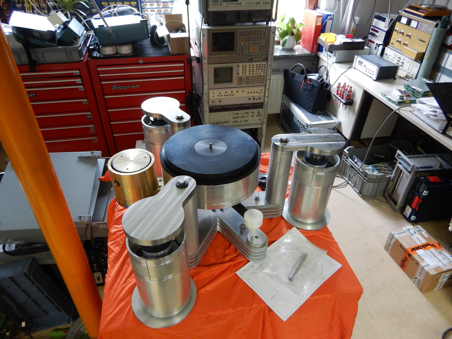

Good evening to you all,
for my turntable-project i followed a lot of your comments/plans/ideas (without knowing about this thread). That turntable started a couple of years as a non-standard Caeles air-bearing turntable but, as this is a hobby, it became a sport to improve on the already good functionality.

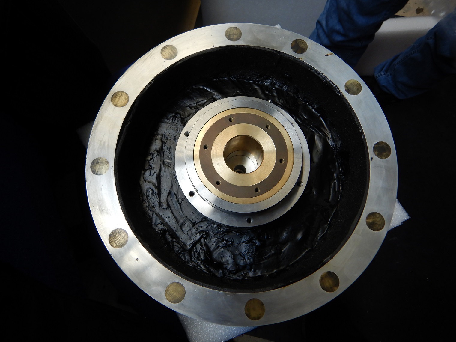

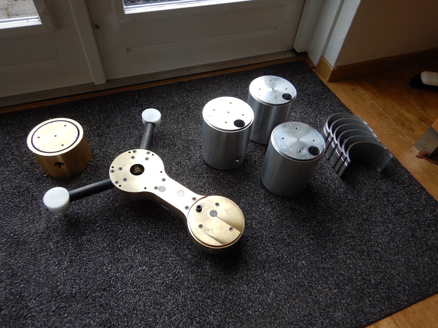

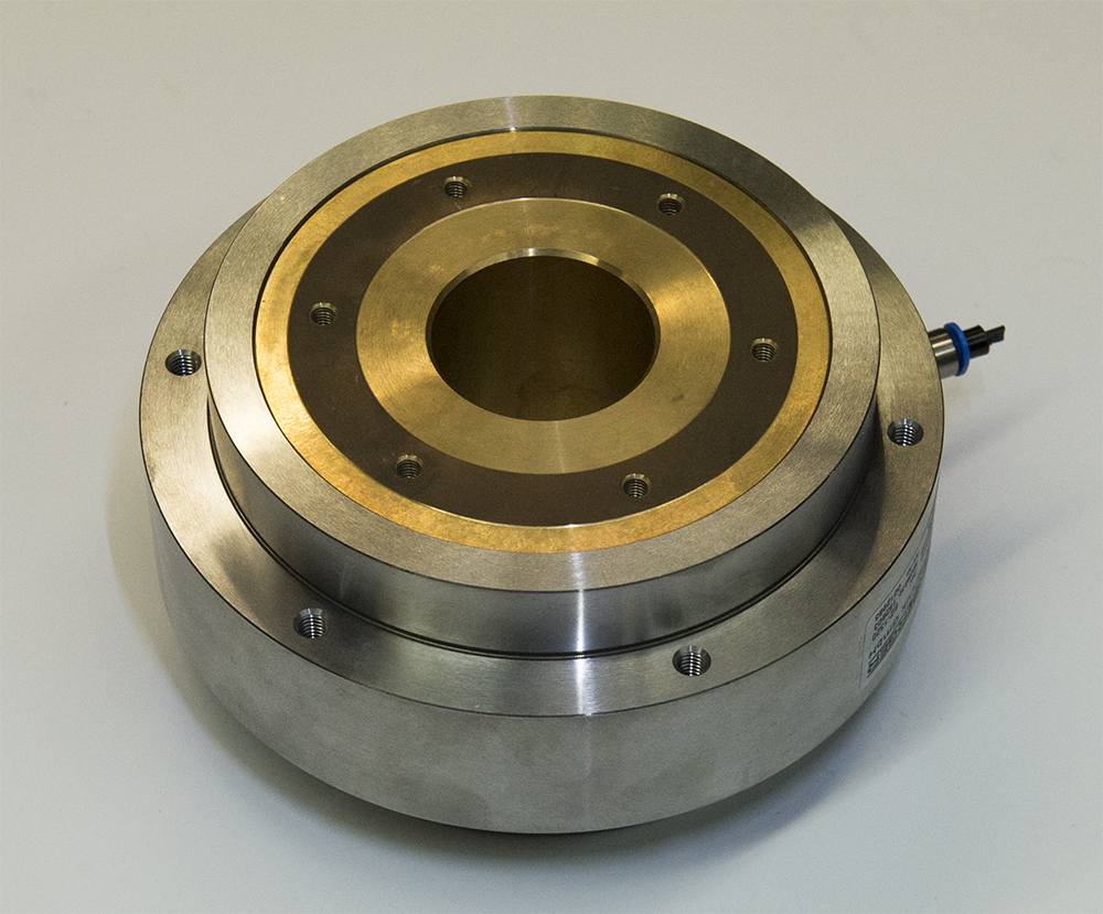

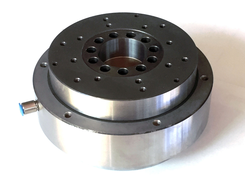

It's a real air-bearing by Eitzenberger (EZ-1320). No flimsy air bearing only in the vertical direction (small air chamber that acts as a enclosed pocket of air but fully susceptible from horizontal influences) but a proper bi-conical design. So that is self-centering and completely airfloating without any touching of any surfaces. Normally these weigh in at 7.6 kgs but that's standard stainless steel. For the Caeles they make it partly in bronce.

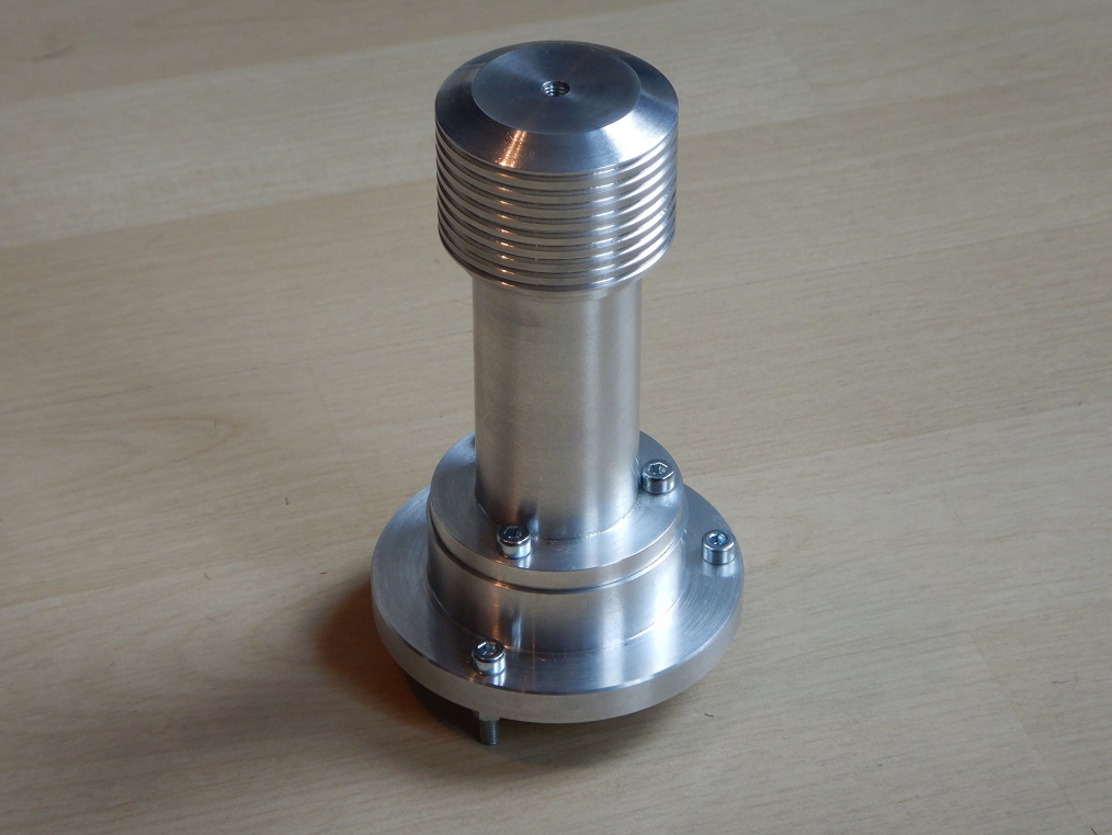

It's nice to have a mass-platter (several materials in order to supress resonances) but as you correctly stated that energy can be "stored" easily in this mass. There is a reason why those light weight platters can sometimes somply outplay mass turntables with crisp notes ! Simply because the energy is not contained but allowed to flow away.
I adopted that idea also here by inserting a mechanical diode in the air bearing middle void. All energy from the platter is simply channel to the subframe.
The subframe is supported by 3 airbladders. they level the turntable horizontal and smother most of the energy.
This turntable was a 3D-puzzle but very interesting

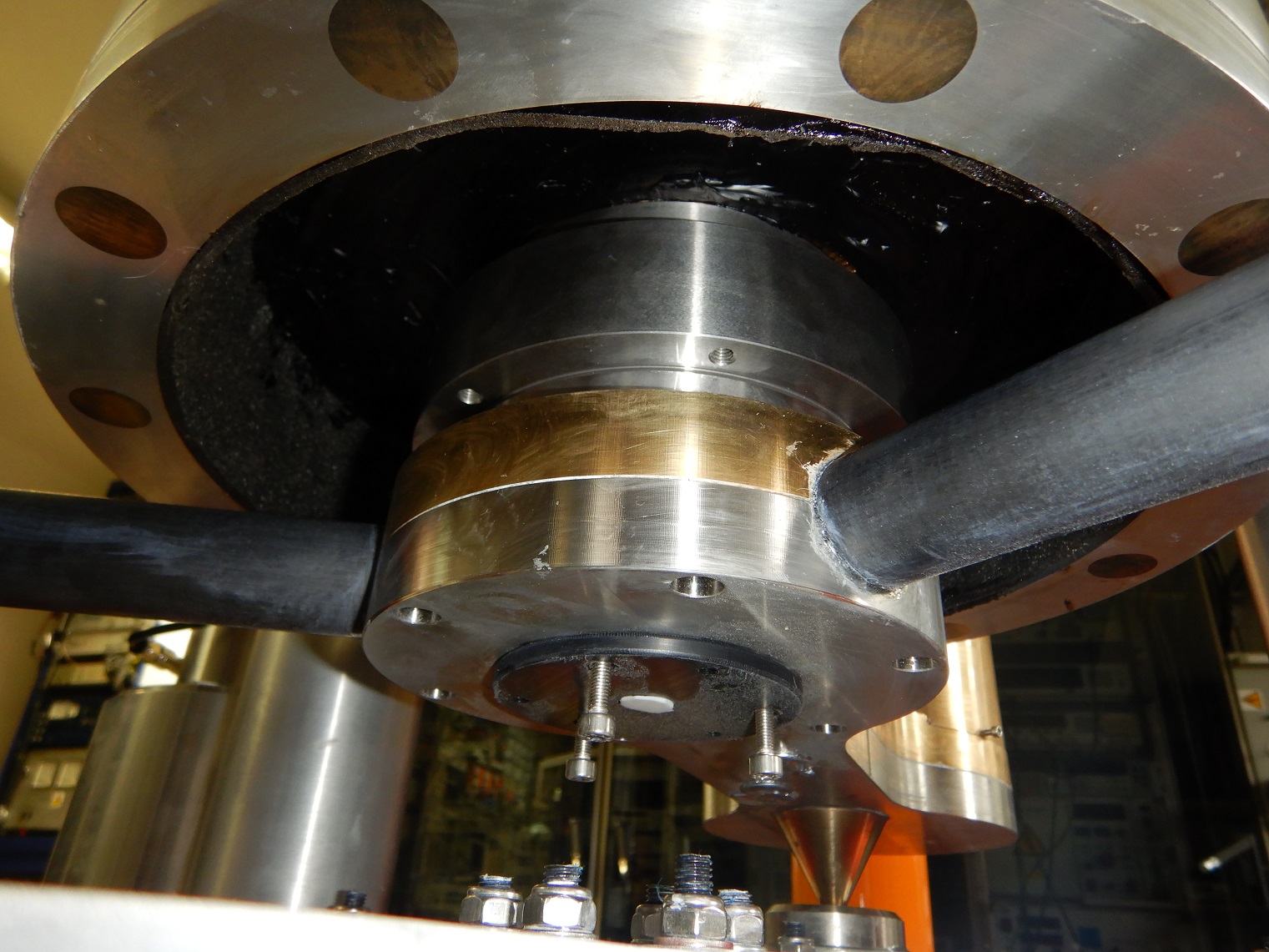

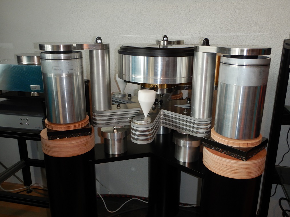

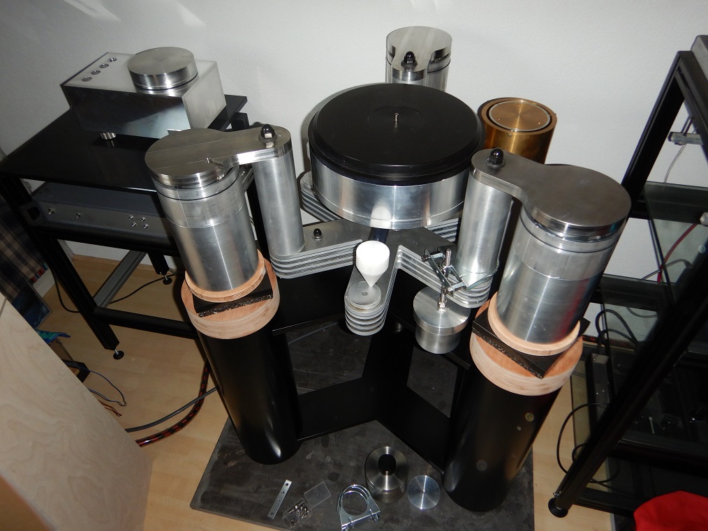

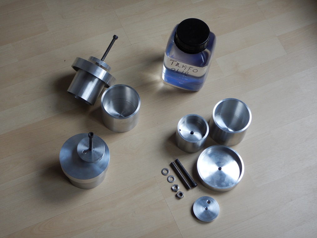

The air bladders can not take out all nasties so the final smothering of energy is done by 3 oil baths/peddles under the subframe.
Rest assured: it works
See pictures
That whole contraption is placed on a serious heavy tripod and slowly but surely were reaching the 400 kgs....

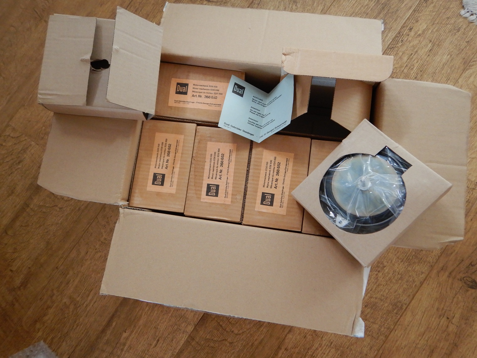

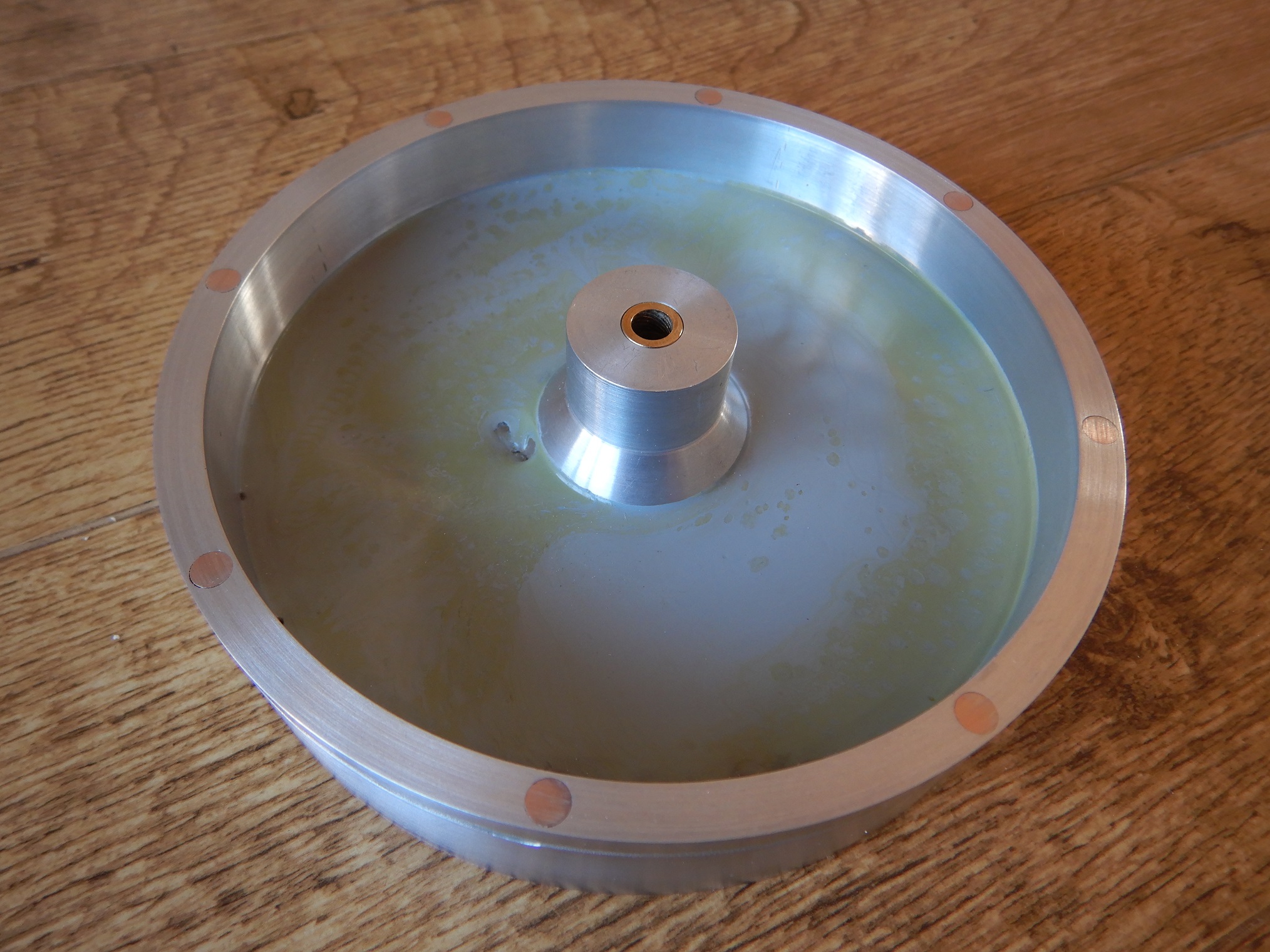

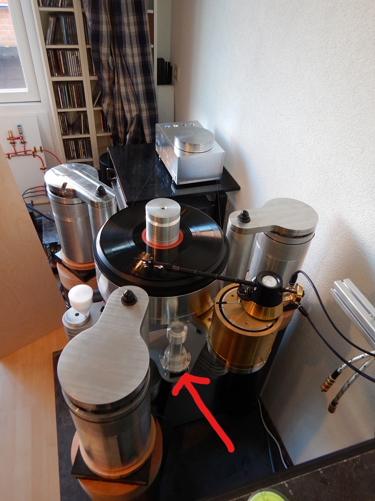

You were mentioning the Dual direct drive. I like those Duals. Not using the ESD1000 but the ESD930 (from the 741QL direct drive turntable). Still easy to source....
Reason for this choice is that i didn't want to run the external drive/motor with asmall spindle/pulley which runs like crazy (like 99% of all turntables with asymetric drives) but with a much lower speed huge pulley.
See pictures: this is half the size of an LP and runs comperatively slow. This solution is not only very stable but will last for ages....

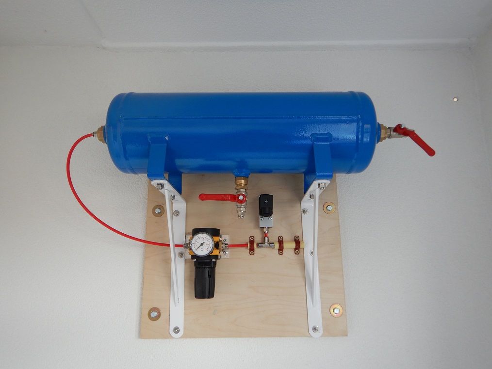

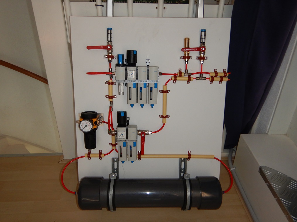

Of course this air bearing turntable needs proper pneumatics. I did this with 3 separate airtanks in order to avoid pressurewaves when the compressor kicks in. 2 seperate filter-banks take out the nasties for the bearing and the bladders
More to follow
See pictures

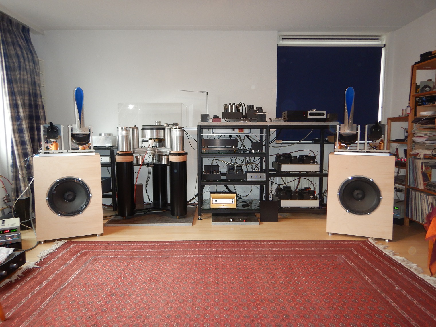

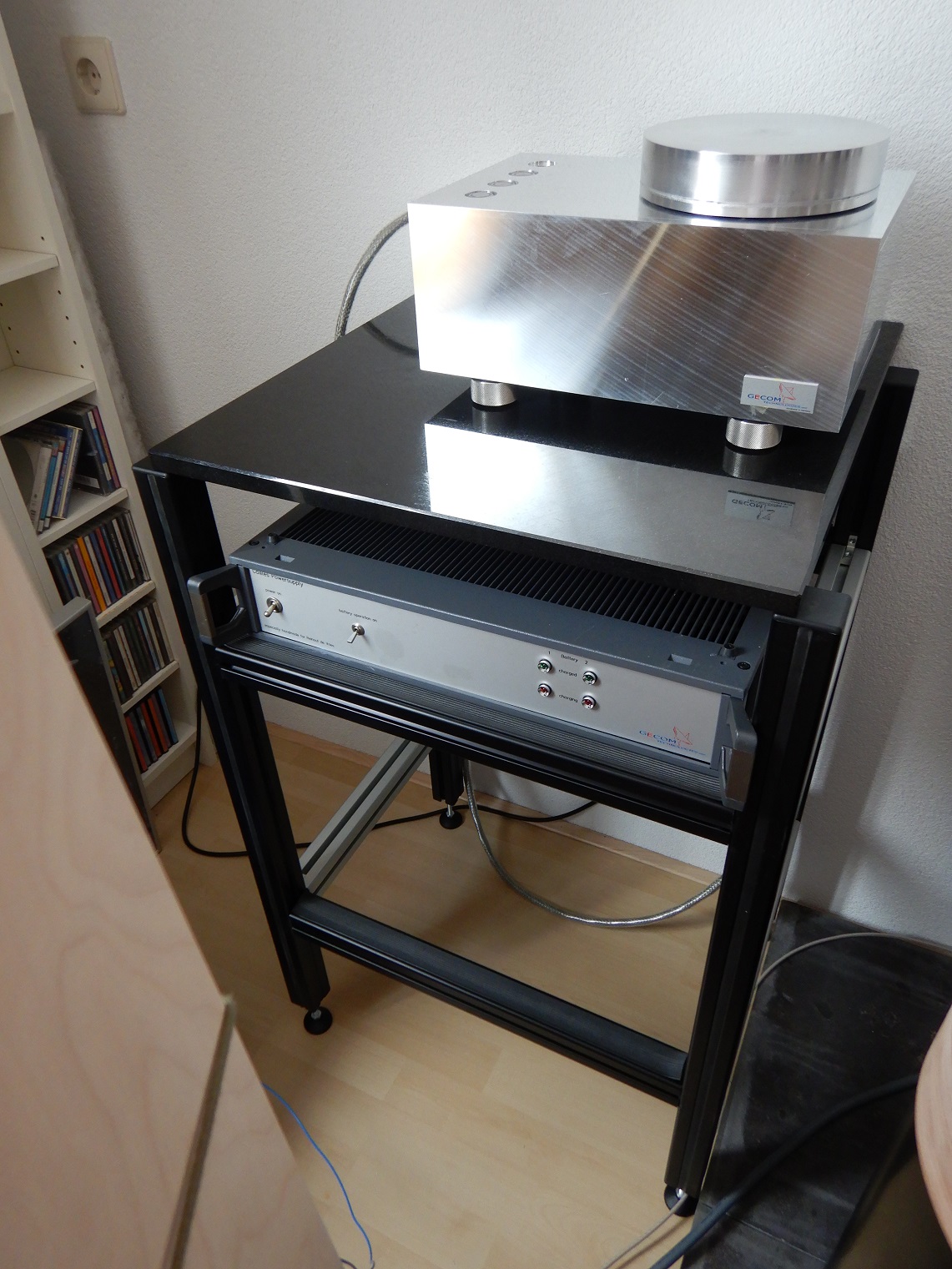

As i don't like asymetric drive by nature i use an external axle as well. this is placed on the opposite side of the motor/drive. The string is tensioned between the oversized pulley and this external axle. The air bearing platter is coasting in between.
The motordrive is fed by an external battery power supply.
Below that is the vacuum pump for the platter itself (sucking the vinyl to the platter if needed).
Pretty happy with the result but as this is a hobby i will not stop trying to improve.
Regards, Reinout
Have you measured platter vertical movement with a 0.001mm runout indicator?
How does the platter sink vibration energy away from the LP stylus interaction without any connection of the bottom of the bearing. I ask these questions because I too am designing a new TT based around a Technics DD motor and I'm interested in alternative approaches.
