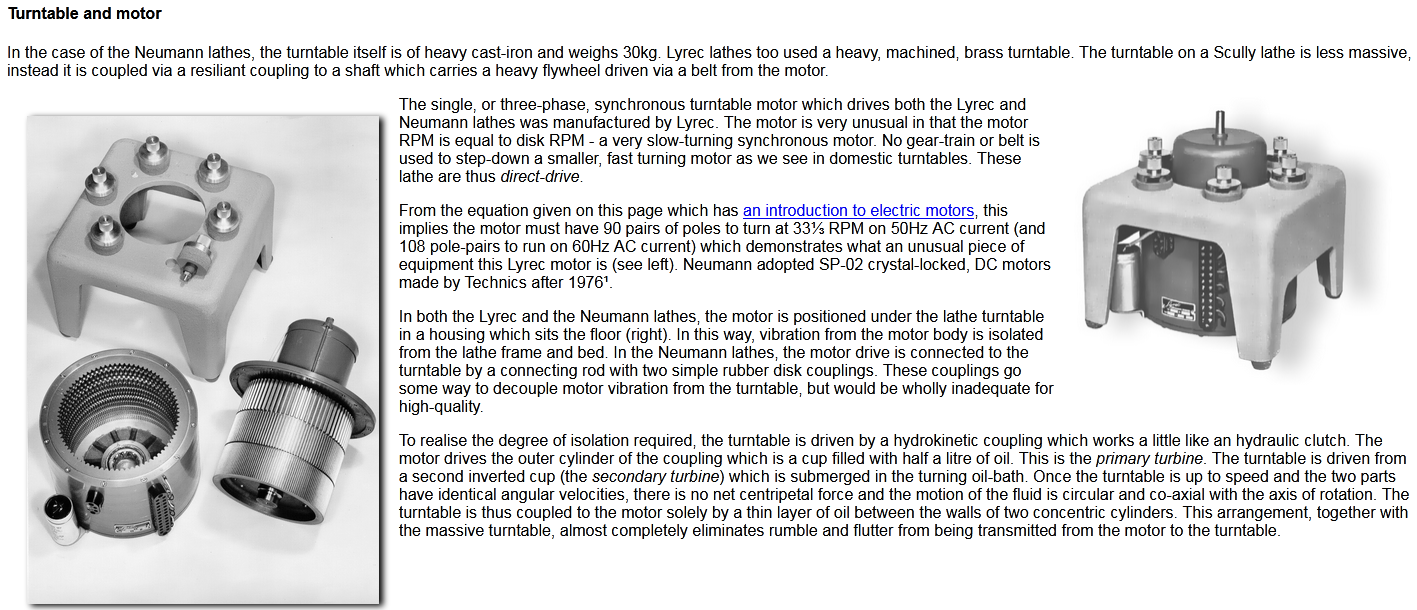

No matter what you do, you can never get better replay of a vinil recorded on a machine driven by this:
Disc-cutting lathes
Neumann VMS spindle bearing - The Secret Society of Lathe Trolls
How to service and refurbish Lyrec SM motors used in disc cutting lathes (Neumann, Lyrec) - YouTube
I couldn't find photos of the Neumann spindle bearing, but a high performance CNC lathe that's aimed at making micron size cuts in hard steel has to be as low noise as can possibly be because noise tranlates into micron length vibrations that can damage the finest work you need to be done on a CNC Lathe and imagine you need to make the platter center hole on such a lathe and it obviously won't be higher precision than the machine doing it..
Lathe Rebuild CNC Spindle Bearings ???? - YouTube
Disc-cutting lathes
