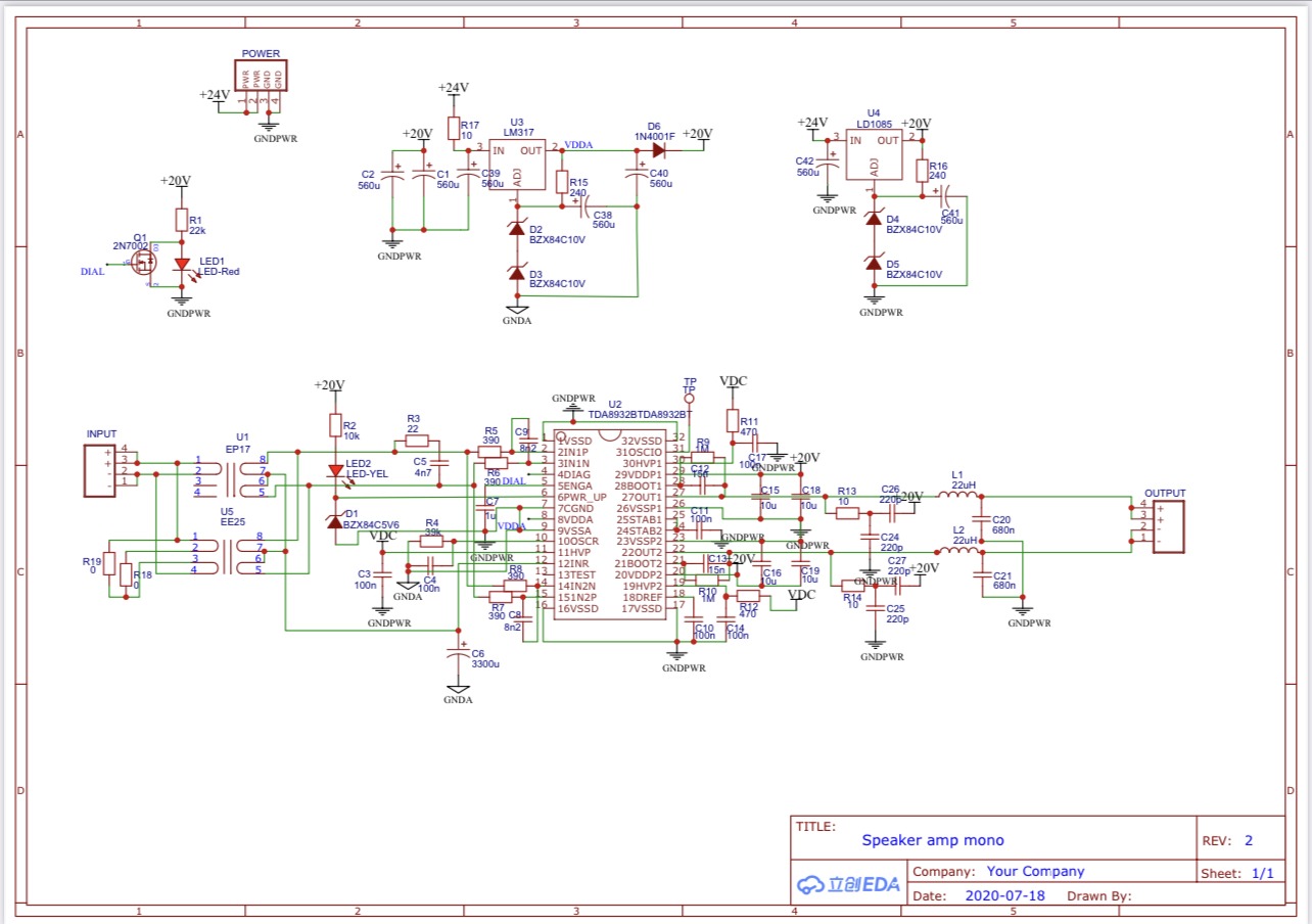

Richard is the only thing precluding the use of 4ohm loads on the amp the current through U4? What would the current demands be worst case with a 4ohm speaker?
I built mine with LD1084 which is a 5A device, although I assume it will need some more heatsinking .?
You can use a 4ohm load without any change, you'll forfeit about half the max output power. Upgrading U4 to a 5A type means the current limit stops being the regulator and becomes the TDA chip itself as that's spec'd at 4A. Theoretically 5A is the peak current for a 4ohm load. That 4A figure for the chip is the worst case so it might be able to put out more. I doubt you'll need more heatsinking unless either your input voltage is above 24V or your music is heavily compressed and you listen loud.

That one is a couple of revisions earlier than yours (r3) so this attached schematic applies. Changes are that R17 is now 2R2 and the trafo has only one footprint option with a ground lift resistor included. The output snubbers have lost one cap each.

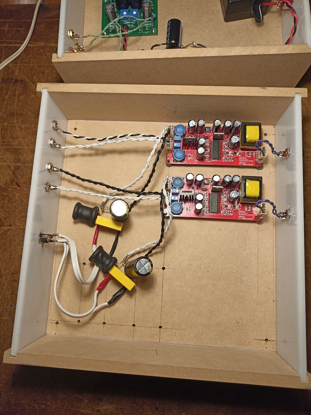

I was looking for alternatives to my hot running Class A amp for daily duty. I decided to venture into cool running Class D territory. In my searching I discovered Abraxalito's TDA8932 mono kit boards and they seemed the perfect choice. The positive feedback and reviews from other members on this thread also helped. And I can confirm – this is really a great sounding amp. A keeper for me.
Got them boxed up running and I am really very impressed and satisfied with the beautiful sound. They are driving my (not so efficient) full range speakers in a 2.1 bi-amped system. Using the Pass H2 V2 as a preamp. The 9dB gain of the pre matches perfectly with the TDA8932 amps. I feed them from a 24V smps with CLC filters (because I had them). Other psu options to be tried later. The amp is as quiet as a dead church mouse – absolutely no background noise. The sound is very musical, very detailed, and without any harshness. The bass is also very very good. Soundstage is wide and open. I am amazed how well the amp sounds, even at low volume.
The two mono boards are boxed up in a simple mdf enclosure of my own design, for a modular build approach. I am trying to get everything into similar sized boxes in order to stack them on top of each other. Like a hifi tower. Not much for the eye, but very cheap and practical. Currently the H2 preamp and TDA8932 amps are in similar sized boxes. Next will be the DAC and subwoofer amp.

Hi Richard ...looking forward to assembling this kit. Is there both a Rev 5 schematic (Rev 3 is the latest I can spot in the sub forums) and is there any sort of BOM available?

Hi Pete - I'll put the current (r5) schematic in the Vendor's Bazaar thread first post later on today. We haven't a BOM, no but there is a full stuffing guide in the same post.
