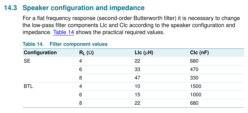

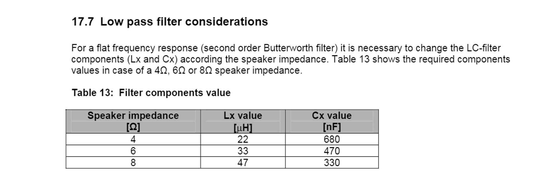

Richard, I just happened upon the Philips datasheet for the TDA8932 and noticed this low pass filter LC guide (see attached photo). Did you ever try the 47uH & 0.33uF combo on your amps? I'm asking because my speakers are rated at 8 ohms (nominal). My experience with altering the LC output filter on most 3255-based Class D amps led me to the opinion that it doesn't seem to change what one hears very much between setting the filter up for 4 ohm vs 8 ohm speakers...your thoughts?

Hi Pete,
I wonder what edition of the DS you have there. I have rev04 and the table of filter component values looks like this :
Seeing as the design is BTL, 8ohm load corresponds to 22uH/680nF. I guess your excerpt is for SE operation. I haven't tried using 47uH/330nF, no.
Running a lower impedance than the one designed for tends to produce HF roll-off. But its not subjectively very noticeable as it really only takes much effect above 10kHz.

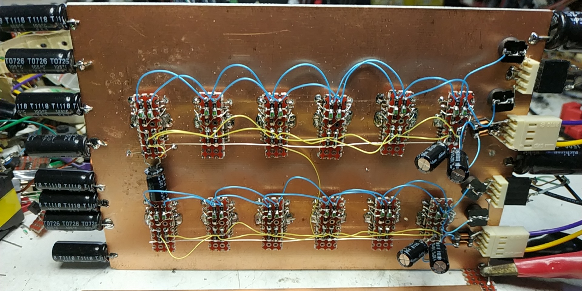

Some stellar steampunk design! Looking forward to the next stages of design and testing.Speaking of improvements to higher freqs, I now have a prototype which does sound a bit clearer than monoAMP. Trouble is, its way too 'hair shirt' to turn into a kit at present. There are 12 * AD815 ADSL drivers soldered to this double-sided PCB, 6 in parallel per channel....
The nice thing about having the power rails on either side of a DS PCB is - its very easy to go crazy on adding caps around the edge.

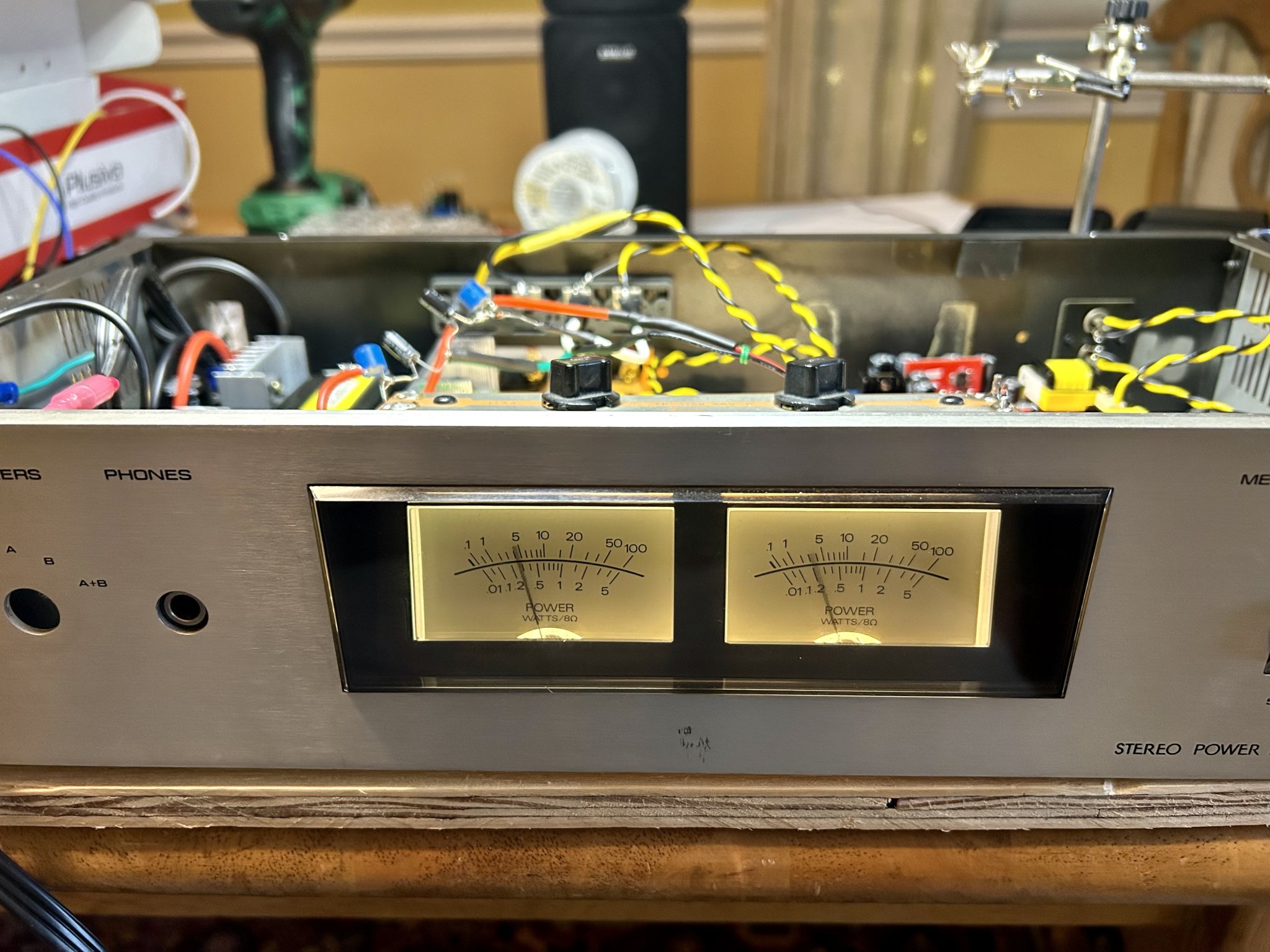

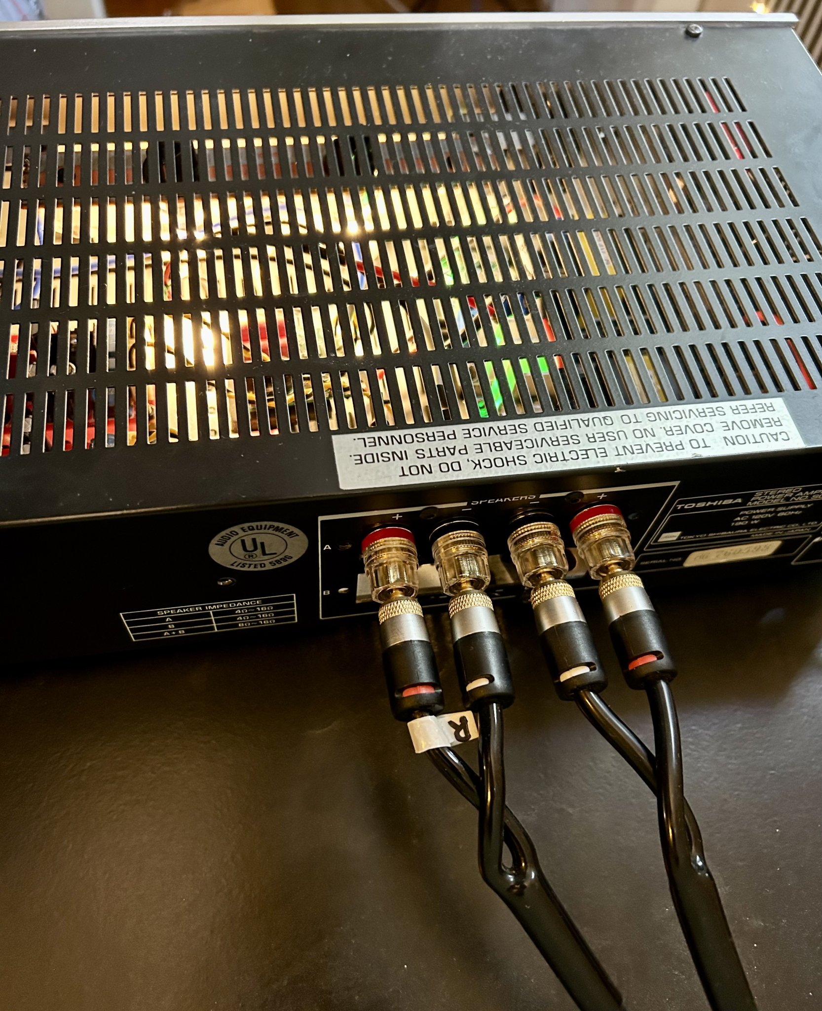

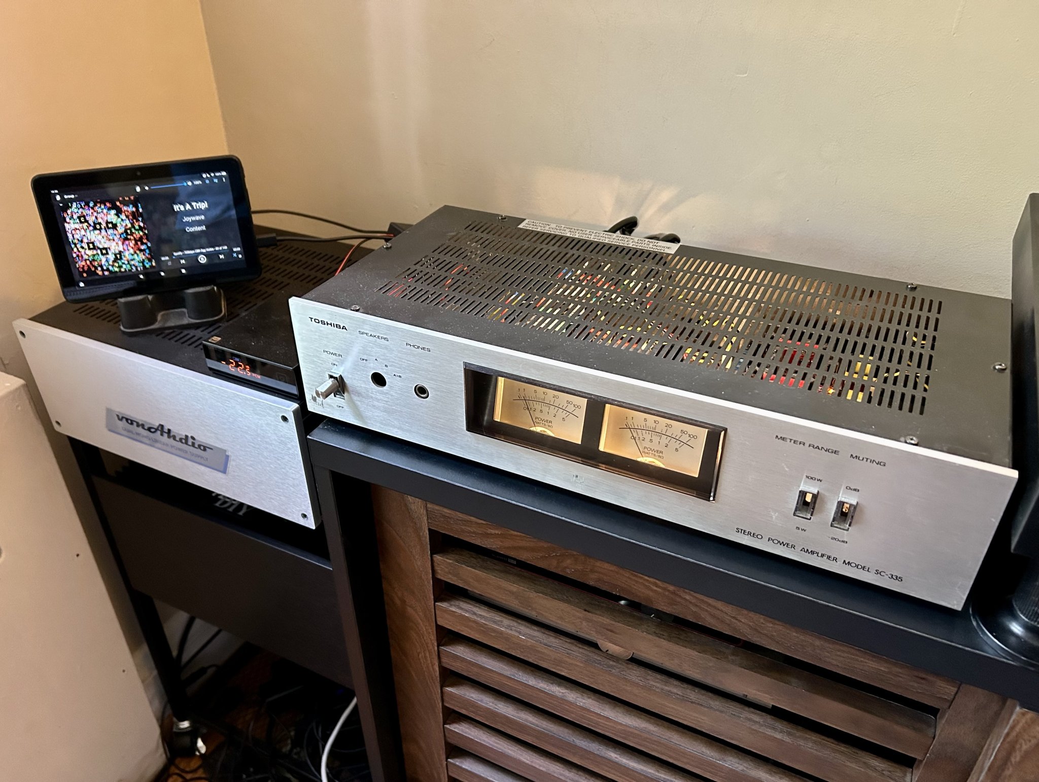

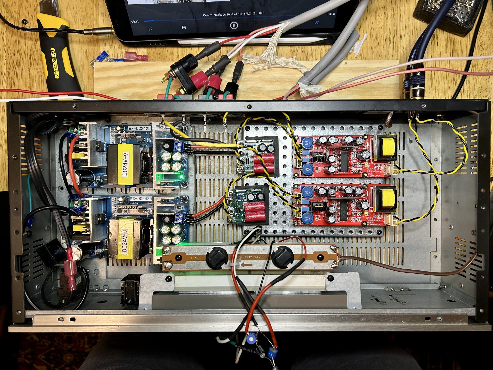

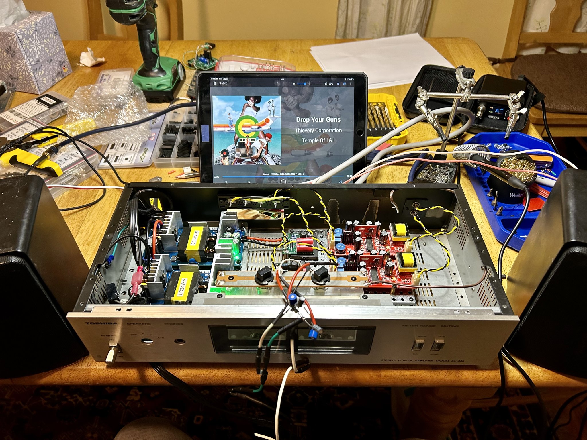

First power up of my new MonoAmps is a success! I replaced the previous TPA3255 board with integrated power supply I had in this chassis with the MonoAmps.
This build uses an inexpensive 24VDC SMPS plus a P089ZB filter per channel.
I still need to sort out the meter and light connections, but this sounds fabulous with my test speakers so far.
Thanks for the great design and service, Richard! I’m a happy camper with these modules!
