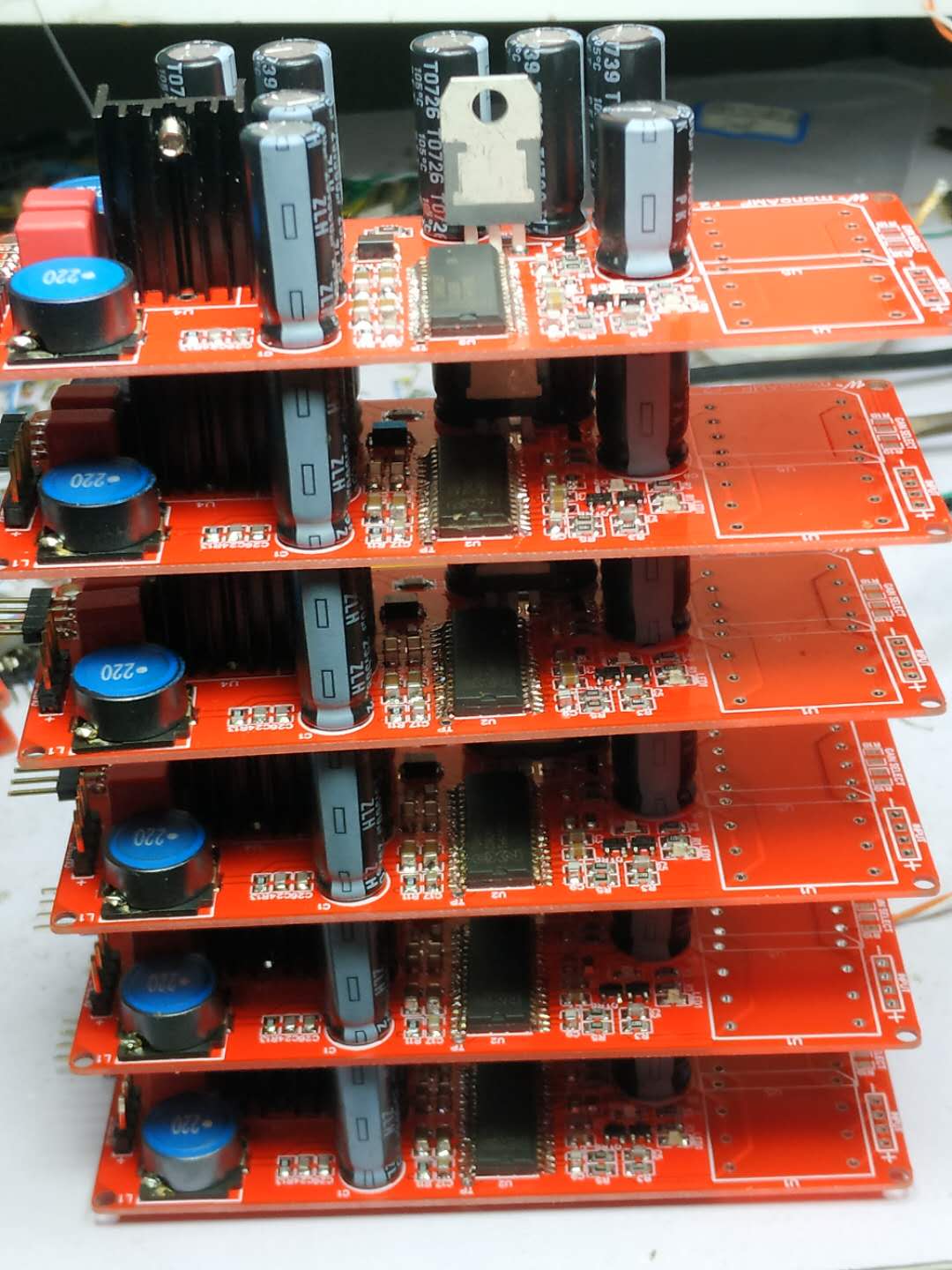

Speaking of improvements to higher freqs, I now have a prototype which does sound a bit clearer than monoAMP. Trouble is, its way too 'hair shirt' to turn into a kit at present. There are 12 * AD815 ADSL drivers soldered to this double-sided PCB, 6 in parallel per channel....
The nice thing about having the power rails on either side of a DS PCB is - its very easy to go crazy on adding caps around the edge.
Some stellar steampunk design! Looking forward to the next stages of design and testing.
