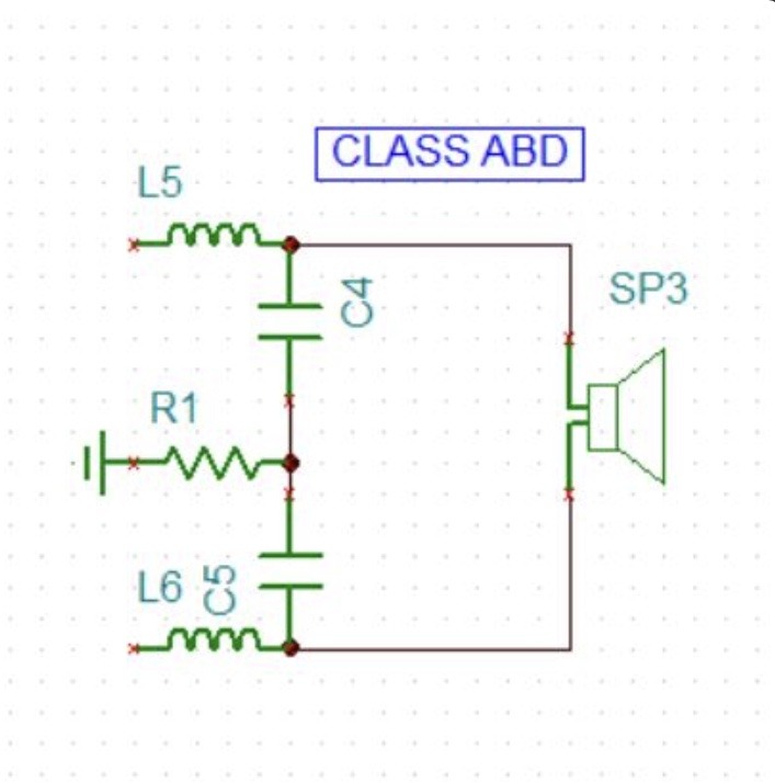

post 2. You only need to add a 2W220ohm resistor.

@Jogi - I have given consideration to @HAYK's mods but the extra distortion that R introduces (see the thread that @HAYK has started to introduce his mod) has so far put me off. Like you I also am very happy with how these amps sound in stock form.

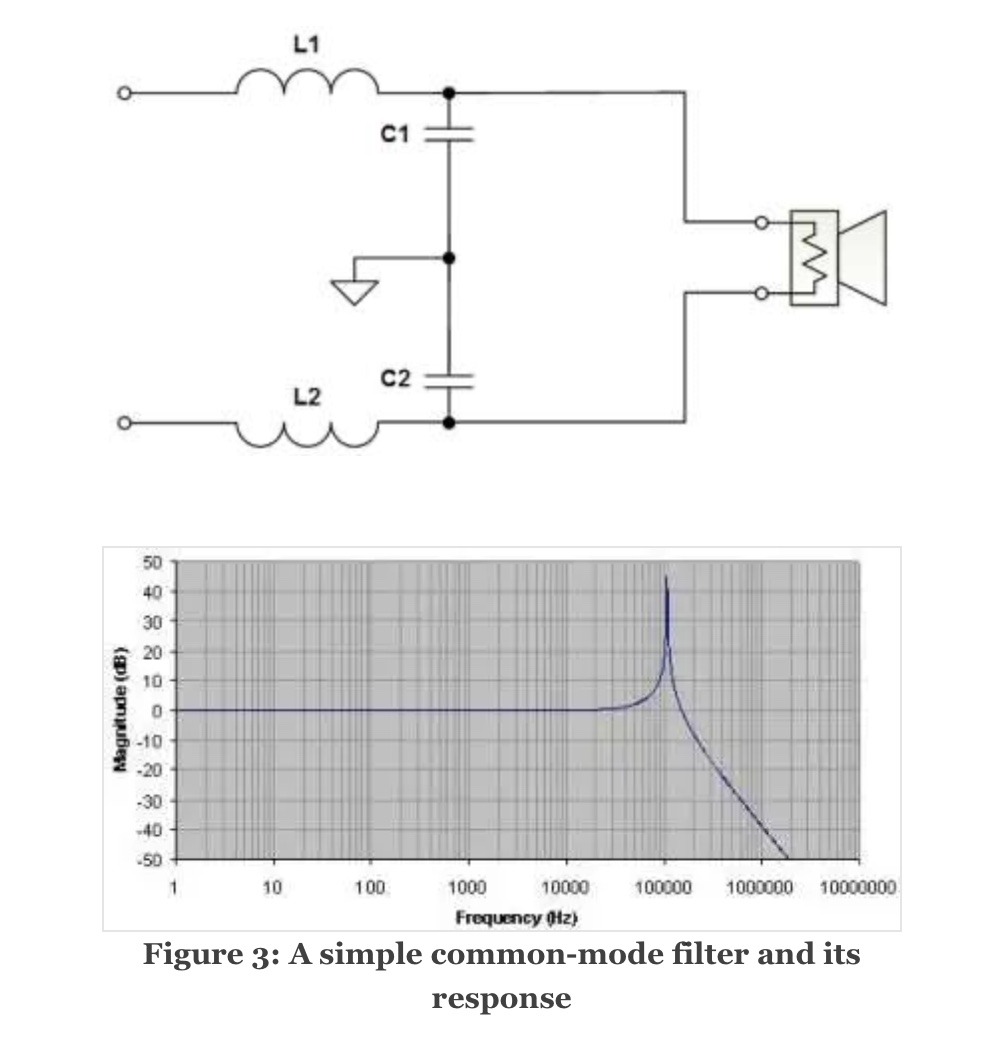

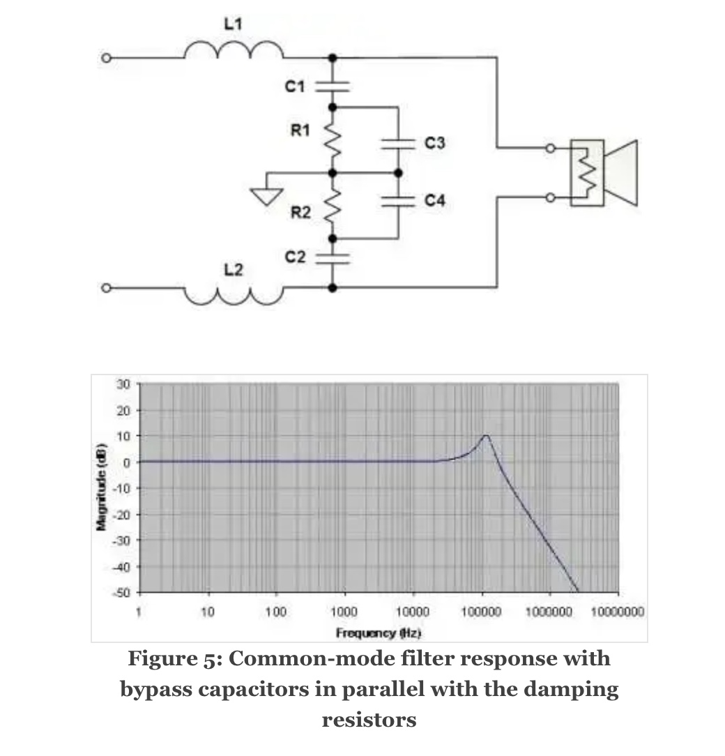

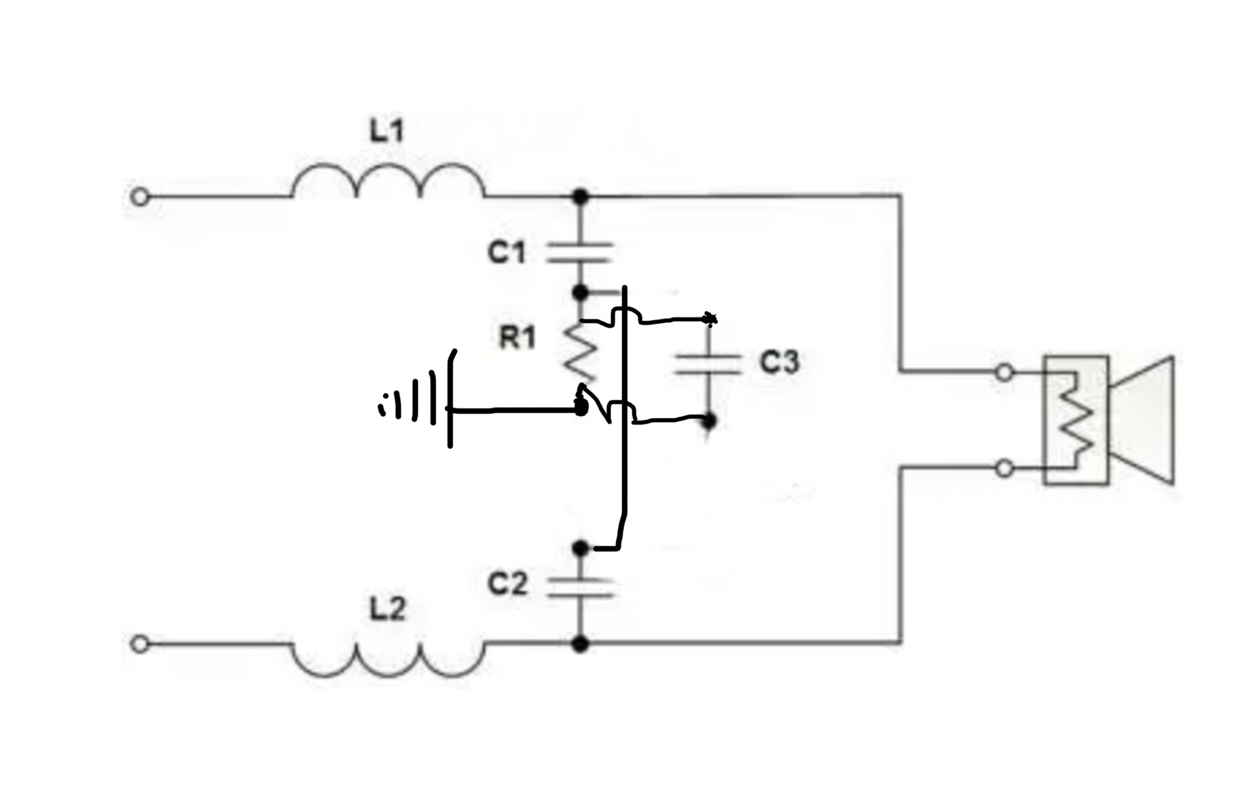

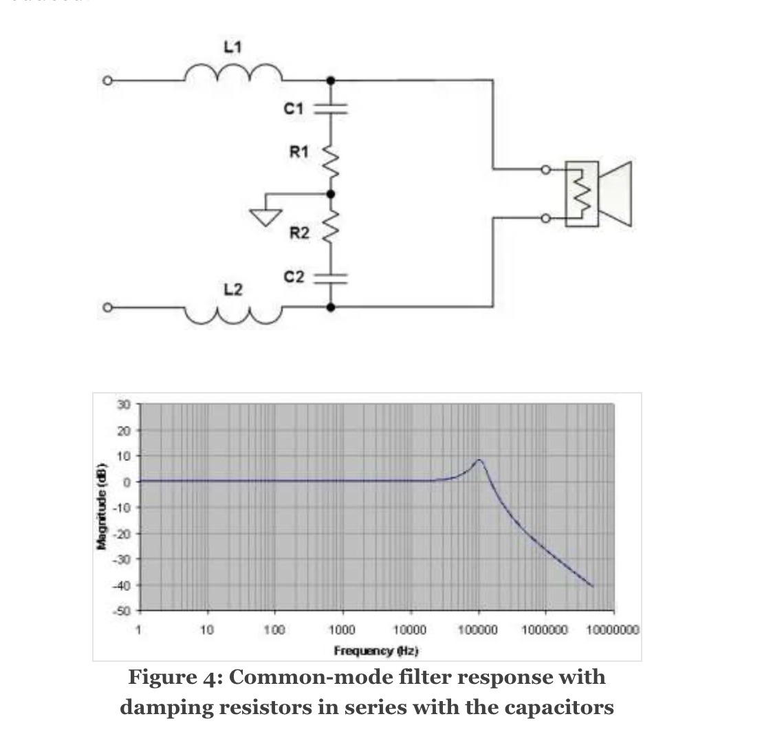

So here's how I'll be testing the SQ of HAYK's resistor inclusion (not a scope-guy, sorry). Reading through the following document ( https://www.eetimes.com/understanding-output-filters-for-class-d-amplifiers/) I'll reference the three attached illustrations from that document showing a normal LC filtering (currently on our Class D amps), what I think is the mod HAYK is proposing with a single resistor (except the illustration uses a resistor for each cap's ground feed) and finally the use of additional caps to reduce the upper, upper frequency noise induced by the use of the resistor(s). My altered drawing of the third scenario, for use with the single resistor proposed by HAYK, is also shown (I think I have it correct). I'm just going to have to calculate what C3 would be (C1 & C2 are the normal 0.68uF caps in Richard's circuit).

dunai2000....so far I can't detect anything detrimental by adding just the resistor (Class ABD) or adding the cap across the resistor (my drawing; Class ABD + 10uF cap). It's hard to tell whether anything positive has occurred. I'll be receiving another of Richard's kits this week and will build it up with stock components then put it in its own enclosure so I can quickly switch between stock & modified amps. So far the only thing definite I can say is what preamp you choose to input the signal has more impact on what you hear. Obviously one's DAC will play a role as well but I'm only rolling through preamps.

Thank you for trying the ABD mod. If you don't get enhancement because there is a bottleneck in the circuit. Maybe the input transformer. The two music files bellow 99% of amps including the Wolverin cannot reproduce clean sound. When converted to ABD, it does with celestial voice.
