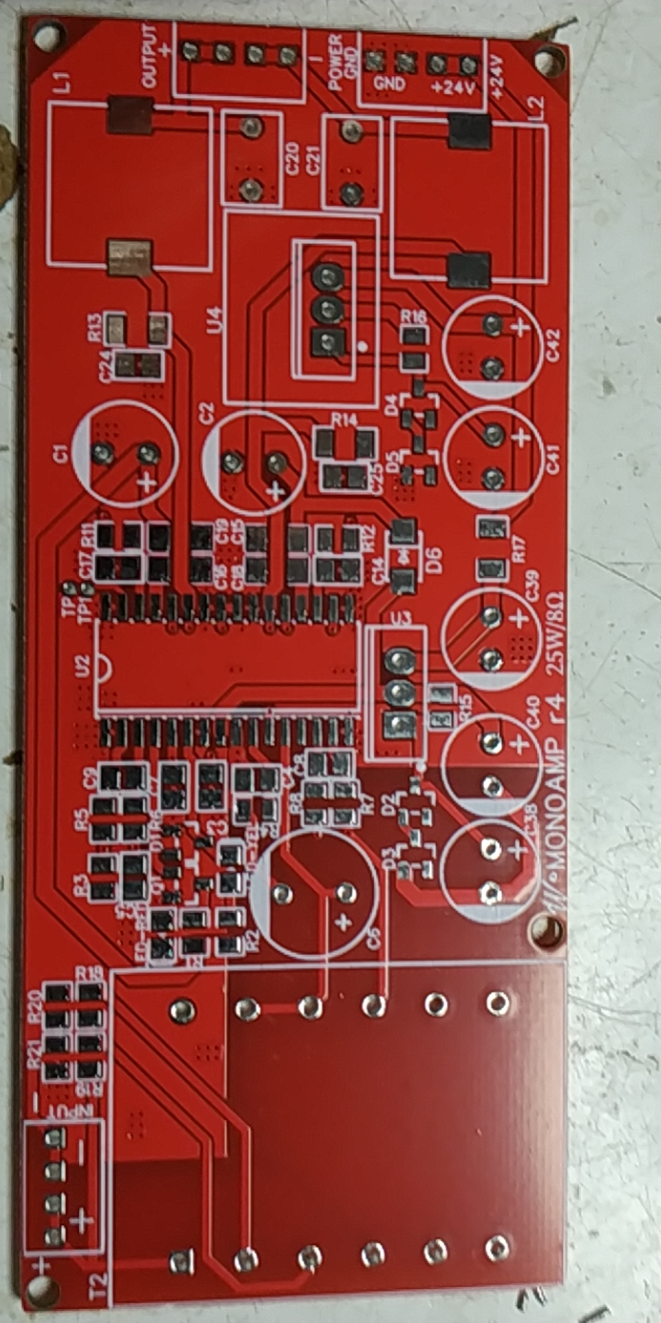

Speaking about input sensitivity reminded me we recently got a few boards made with a different input transformer. Its considerably bigger : EE35 vs EE25 for the standard one.
The thinking behind the larger trafo is to give more flexibility over input sensitivity. Why do we stick to such a low voltage as 2VRMS when most circuits being based on opamps can easily output 8VRMS even unbalanced? The EE25 trafo cannot handle such high voltage signals because the wire for the primary gets to be too thin and difficult to wind without breaking.
Enter the EE35 trafo - with a much bigger winding window it can easily handle 8VRMS and likely even higher.
The main reason for wanting higher voltage capability is to get higher SNRs out of the analog stages of DACs which are typically limited by opamp noise if JFET or CMOS opamps are used.

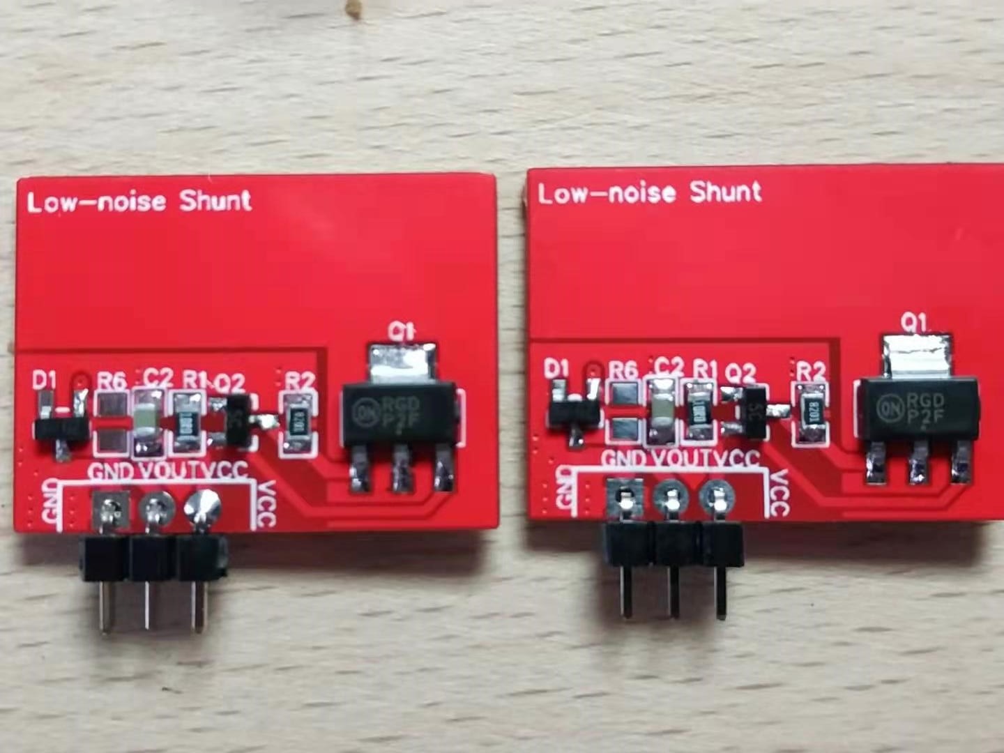

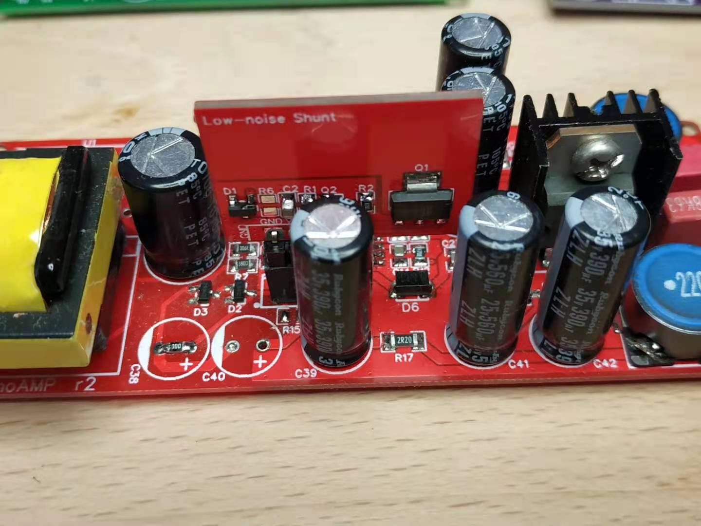

New shunt PCB as of last month - we've tweaked the layout and now the shunt PCBs mount on the mainboard at 180degrees relative to the old shunts. There is no electrical difference though, just slightly re-positioned components. How to know if you have a new shunt? - it'll have 'Low-noise shunt' on the silkscreen. The old shunts didn't announce themselves.
The second pic shows the new orientation - the height of the shunt board isn't representative as that's my test board in the shot, complete with socket. Pin1 (GND) is to the left.
