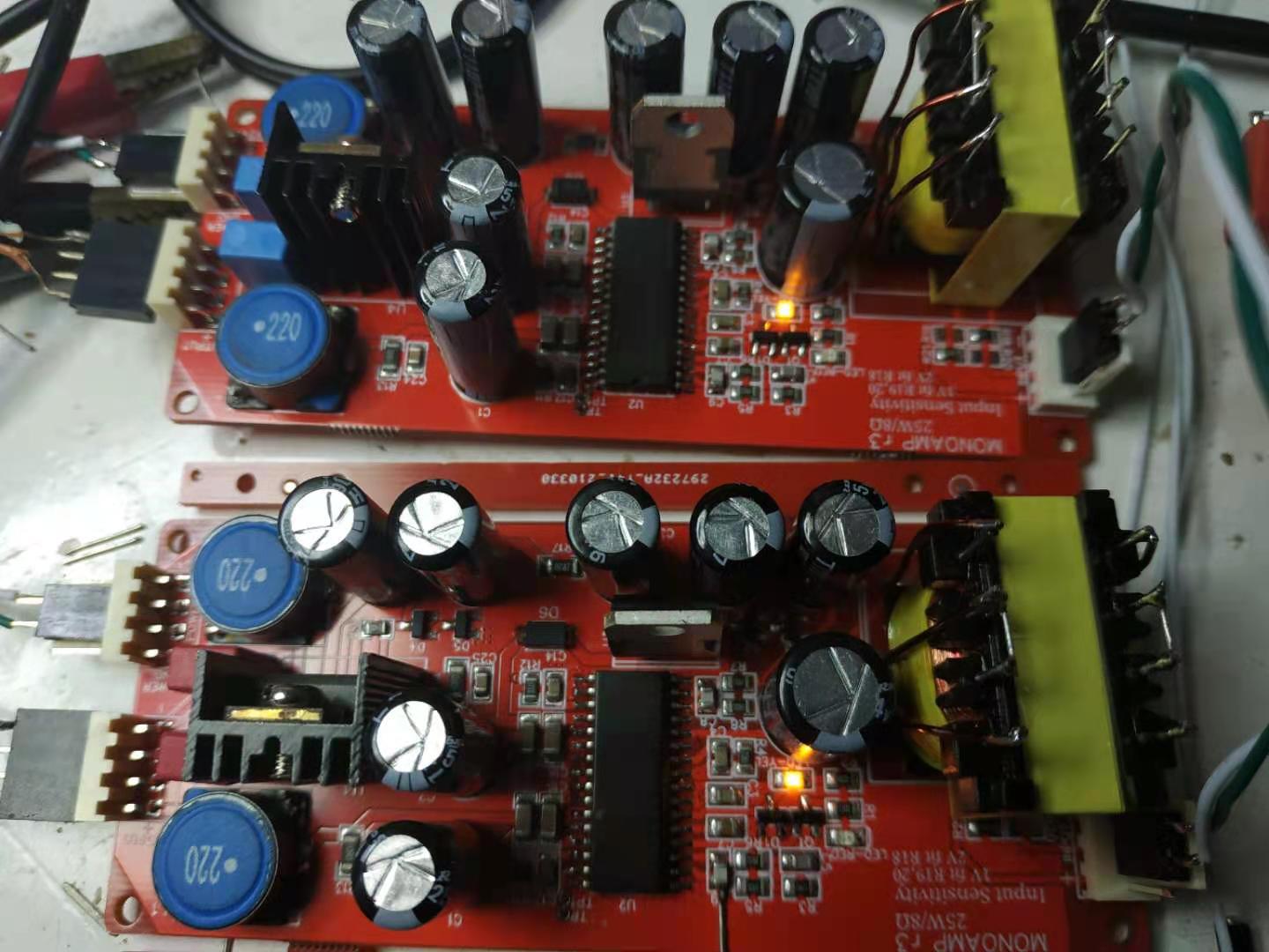

So far, so good with these COTS trafos - the leakage inductance isn't so different from the custom ferrite ones. I've inferred that from the FR which is acceptably flat in the HF - since I'm using the leakage L as an element of an input LPF if it was markedly different the LPF wouldn't be correctly aligned.
So far I haven't noticed any SQ difference between these and the originals but they give the amp a slightly increased voltage sensitivity - meaning it plays a couple of dB louder. Primary inductance is indeed reassuringly high - I'll try a measurement of the LF response with a 4.7uF film cap in a while.
