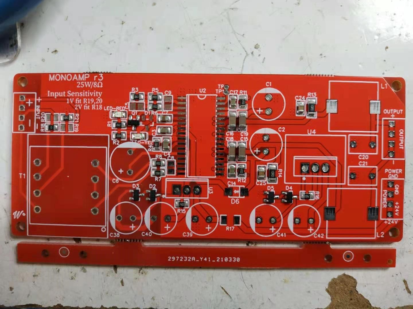

r3 PCBs arrived
Apologies that there will be a couple of days' delay in getting the ordering of kits open - some caps proved a little difficult to source.

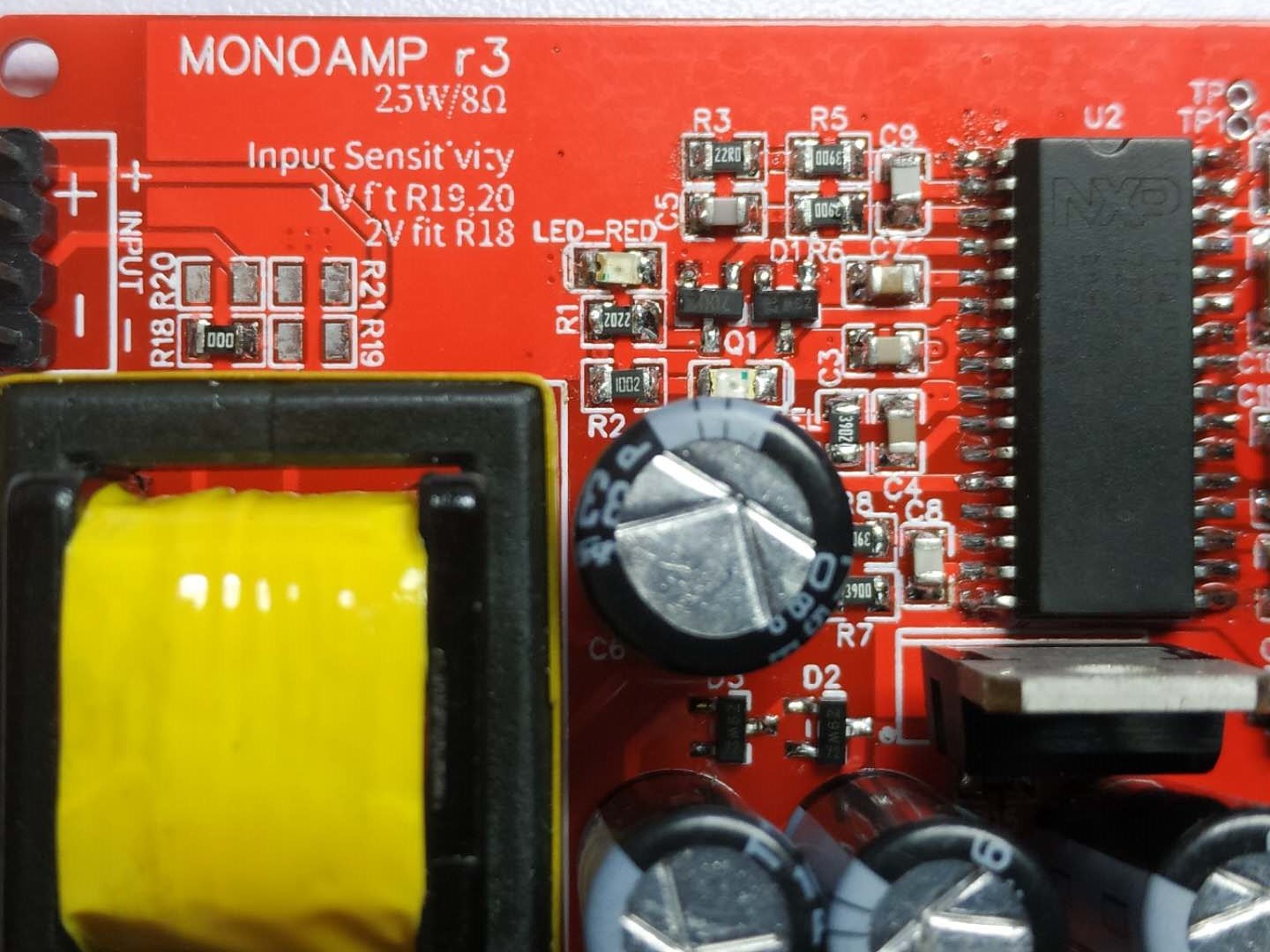

The input sensitivity (either 1V or 2V) is set by the resistors near the input. Default is 2V with R18 fitted. For 1V sensitivity (to drive from a mobile phone for example) then fit R19 & R20. R21 is a band-aid (aka 'ground lifter') if there's no other way to reduce common-mode voltage variations between source and amp. Best is to connect the 0V of your source to the 0V (power input) of this amp via a dedicated wire. If that's impossible or impractical, then R21 may be fitted with a 10R to reduce the CM voltage between the two. Without a conductive path between source and amp there may well be low level hum as the CMRR of the transformer isn't perfect.
While we're on the subject of transformers there's another caveat - they don't like DC at all, not even a few mV. So AC coupling is a requirement to the input of this amp, I usually use an electrolytic. If you choose an overly small valued cap there's the chance of introducing some bass-boost, which may (or may not) be desirable. I will run some sims to give an indication of the values of coupling cap which might be gainfully employed.
There are two LEDs, one yellow - for power, and the other is red, to indicate a fault. On power up (from 24V), they both come on and if all is fine, the red one goes off after less than 1s. The TDA8932 is very well behaved as regards pops and clicks, nothing noticeable on powerup/powerdown on any of the prototypes I've built so far. The amp will work down to around 12V supply but will have reduced power output and poorer SQ as the supplies won't be regulated. Of course it can be modded to regulate at 12V by substituting the zeners (D2-D5) for lower voltage ones.
