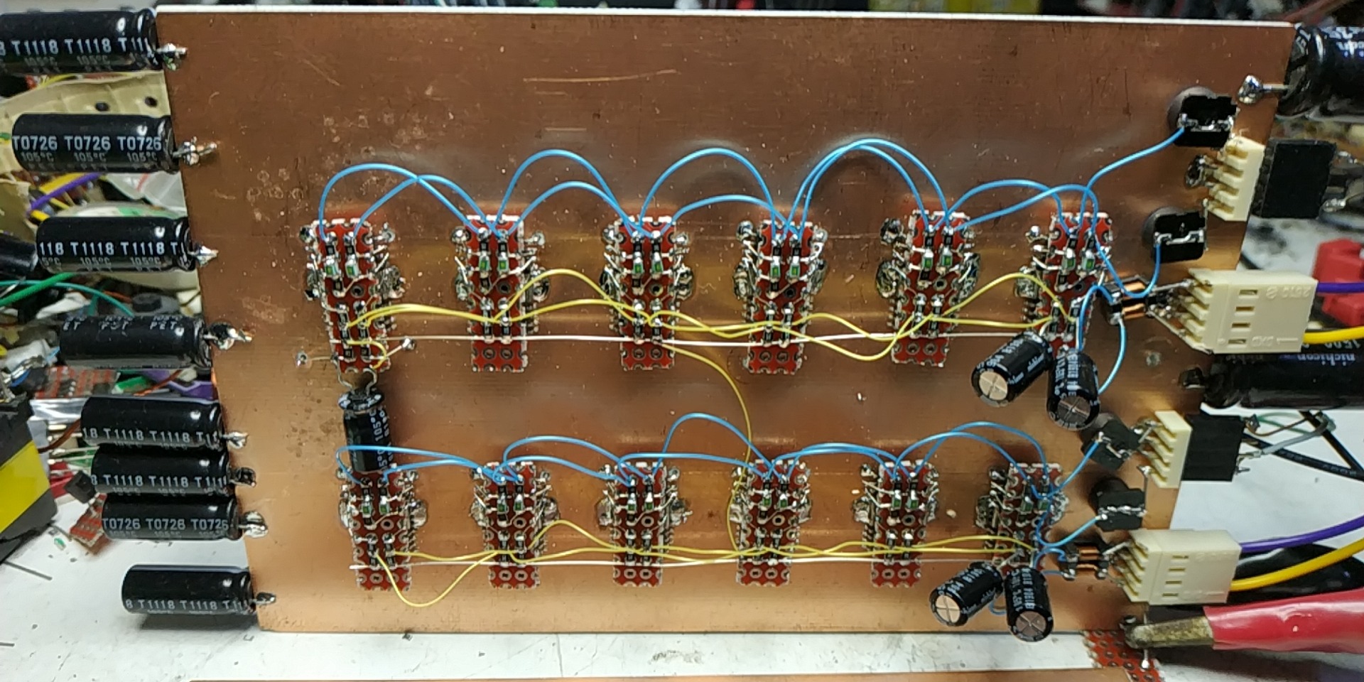

Speaking of improvements to higher freqs, I now have a prototype which does sound a bit clearer than monoAMP. Trouble is, its way too 'hair shirt' to turn into a kit at present. There are 12 * AD815 ADSL drivers soldered to this double-sided PCB, 6 in parallel per channel....
The nice thing about having the power rails on either side of a DS PCB is - its very easy to go crazy on adding caps around the edge.
YesAre you talking about MJ's smps filter?
Its going to need a fair amount of work to make it a practical solution. At present the issue is - it runs too hot. The AD815s are too close together so I'm starting on another build with just one channel (rather than two as here) on the same size sheet of PCB. We'll see how that goes. The version in the picture can't run anywhere near the max supply for the chips due to overheating, and that's not even playing music, just the quiescent current which rises as the temperature increases. So a kind of thermal runaway.
