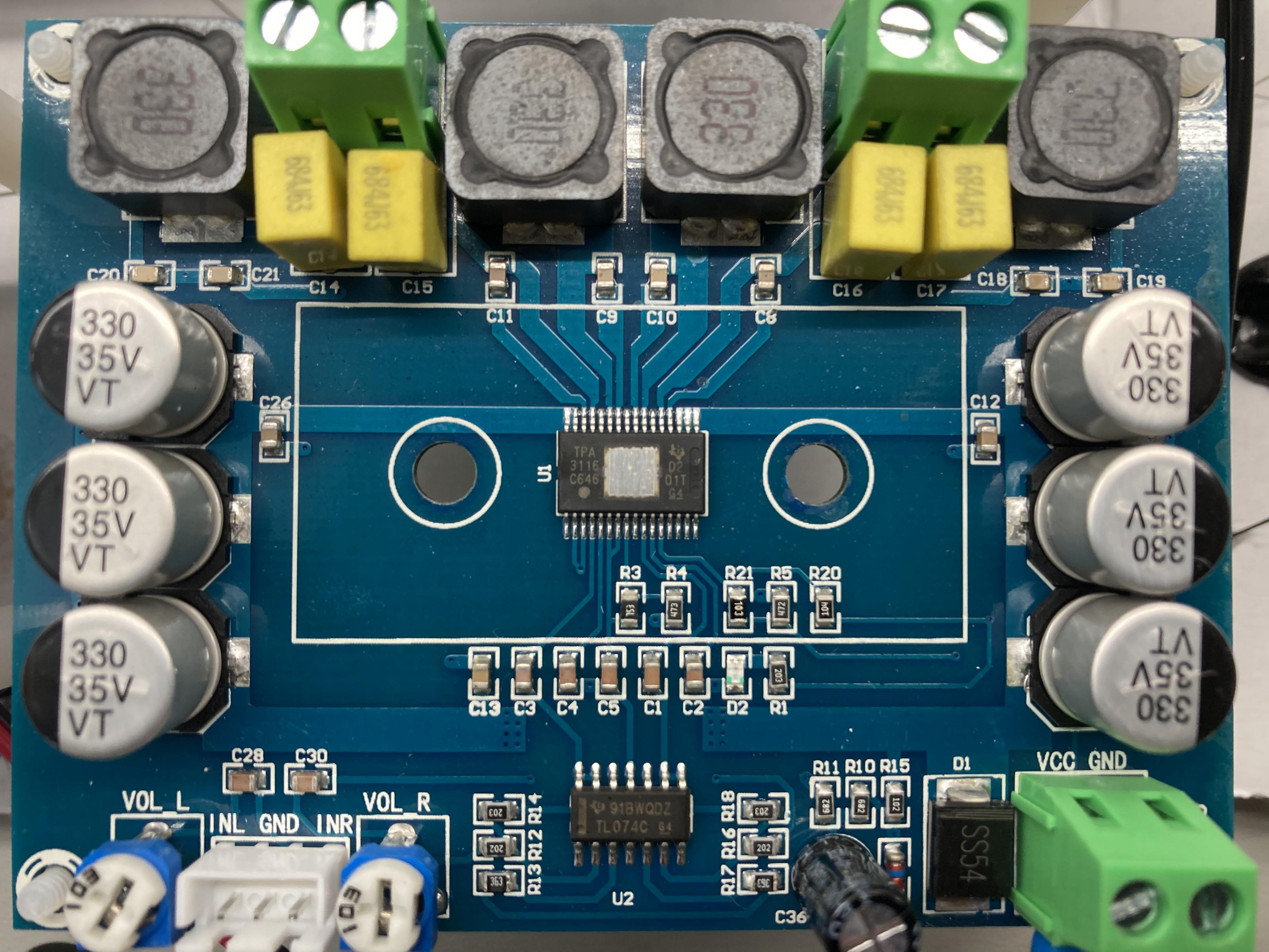

Here is the board I’m discussing:
I removed the op amp and added sync to another board, plus remote turn on via the SDZ pin.

5) The rear side of the board is cleaned with isopropyl alcohol. Use a soft brush and hold the board vertically such that the alcohol drips off in a corner.
* On the output of my power adapter I have some further 10000uF.
Hi FF
Please, I have 2 questions:
1) why to clean the rear side of the board with isopropyl alcohol?
2) what kind of 10000uf capacitor you are using for The power supply output?
Thanks in advance
Udi
I clean the board with isopropyl alcohol in order to get the remains of flux away from the board. Most of the boards look "greasy" when you let the light fall on the board at an angle. After cleaning, you can make the board look nice and shiny. I also do this when I have been soldering myself.
As I recall, the 10000uF is marked "Rubicon". It does not need to be a top-quality low-ESR capacitor.
If you are going to use it only for this TPA3116 amplifier, 35V rating is fine. I use my large external decoupling capacitors for more different amplifier constructions (and transformers) so I often go for 50V or 63V.
Rubicon or Nichicon (not the expensive golden ones) is sufficient. They mainly serve as charge-buffer for lower frequencies. The decoupling capacitors on the board itself take the main part of the switching ripple.

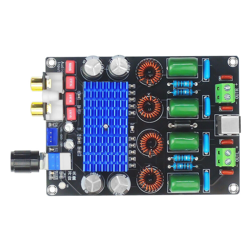

Hello.I am thinking of buying my first class D amp generally based on TPA3116D2.There are many posts and difficult to read all of them.Is this a good and reliable PCB design to buy ? Any downsides of this board? model is XH-M590
