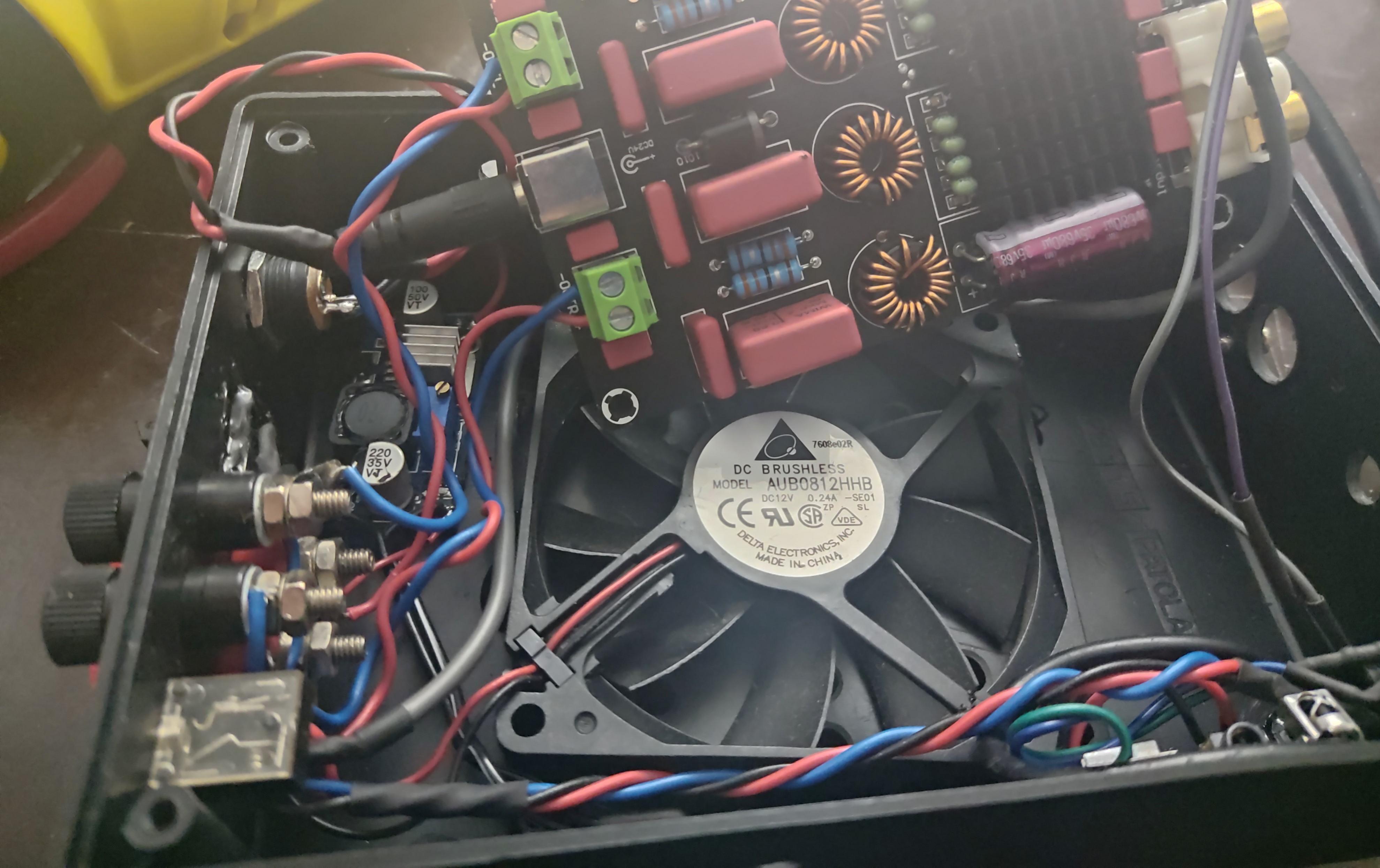

@FauxFrench First of all, thank you for helping so many users with those boards/chips. You've helped a lot of people (me included) improve their amplifiers and I wish you the best this following year.
I followed your instructions on those resistors once my new board arrived. I got one of those Aiyima 2x100W with the Wima caps. Can't be sure if they're fake or not.
AIYIMA Professional Mini Amplificador Audio Amplifiers Board TPA3116 2.0 Dual Chip Digital Power Amplifier 100W For Home Theater|Amplifier| - AliExpress
This board does come with the same issue as others do, a lot of noise when turning the potentiometer. I've been thinking about trying to get a 10 or 5k Log potentiometer that will fit in the board.
Well...other than that, the usual removal of those 75K gain resistors do help a lot. The potentiometer still causes hiss, but you have to get close to the speakers to hear it.
I later then changed the 47k for the correct 5.6k ones, just to keep things clean.
I did manage to change the Bootstrap main caps for a Multilayer one, that didn't give me any noticeable changes.
I then added the last mod I could, that was the snubber mod. This one does change the sound profile quite a lot. This chip does seem to like producing highs that kind of hurts your ears after a while. The snubber mod does fix that and the amp sounds very pleasant, I can now keep it on for hours without issues.
Since I decreased the gain, I didn't want to lose all that power - I don't really have a pre amplifier around and the source I am using is either the BT board I added or a P2 Line from my computer, neither have enough gain.
I then found a very simple pre-amp based on the NE5532 chip in which I could make and managed to add it to my amplifier as a "line" input pre-amplifier. Kinda wish I had a scope to measure things properly, but I only have a half-ok multimeter.
Oddly enough, I found a "DC- Simmetrical converter and isolator", that takes the 24V I use and converts it into 12V+, 0 GND and 12V-. I am unsure how common those things are, but I do have another isolator, for 5V on my Bluetooth board. This did cut down the noise/hiss a lot. So, even adding that pre-amp didn't bring much noise into the system (apart from full volume on the pot).
The 5V isolator is usually found in AliExpress by the name B0505S. The 24-12+/- seems to go by A2412S in case anyone is interested.
They're usually cheap and the "B" version does seem to have a wide range of voltages (B2405 for example).
It's a bit messy in the wiring right now, but here are 2 pictures from before I added the pre-amp.

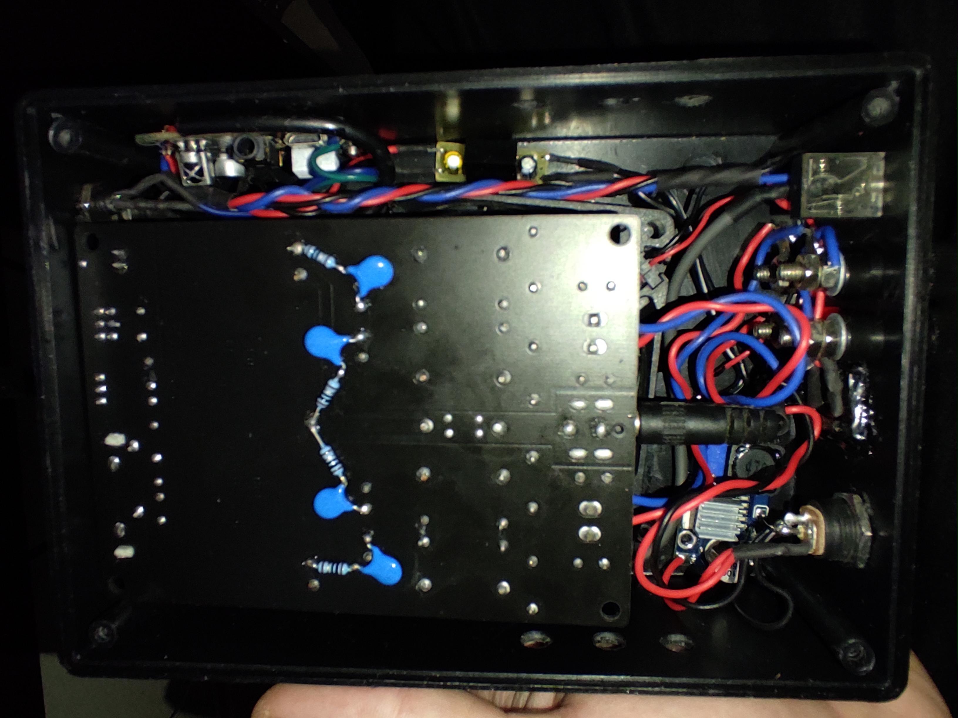

It was a pain to find the 10uH inductors to use on my older board (I could not find a single seller of any type of inductor here, even if non-branded or outright fake, nothing for the needed ratings..), had to order from Ali, but I got the "not so good" ones. Should have gone for some slightly better I found later.
Good to hear more feedback on this mod. I always thought it made a big difference but never quite sure.
Ohh, my apologies! I just read up on the board where you put out that mod! Good job dude!
I was about to question if I should have used different values since my board is a dual PBTL. It did help with the "metallic" high notes, but it may have made the highs a bit too muffled... It's better to hear it nonetheless.
Pic attached from my old board, I ended up following someone (can't remember who mentioned..) about just by-passing the entire pre-amp stage, ended up doing that and also added the snubber mod. (Sorry, this board has been really abused...it's been a plaything for me to learn and is currently on a small Home theather central box running at 12V, no need to worry about the underrated 10uH I or the small heatsink)
