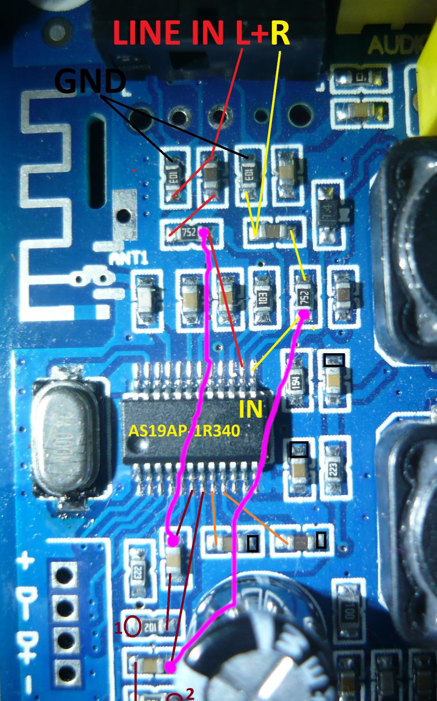

You could just try to remove the crystal and solder two wires like the pink lines I drew on the photo, should work but it's not ideal.
Dear Trileru,
I soldered that two pink lines and removed the crystal but there is no any output after that. If I solder back the crystal the amplifier works fine. So I think the BT chip use an "enable sign" to TPA chip. I will try to found it.
gsc73
I am 99% there's no enable from the BT chip.
Most probably the BT chip outputs are pulled to ground when the crystal is missing/chip is not working.
I would just remove the chip completely.
edit:
tpa3116 has pin 12 as mute pin:
"Mute signal for fast disable/enable of outputs(HIGH= outputs Hi-Z,LOW= outputs enabled).TTL logic levels with compliance to AVCC."
You can check this pin and see whats happening, might receive a HIGH signal when the BT is not working but I don't think they went to the trouble of implementing this.
Normal tpa3116 implementation pulls this pin to GND with a resistor. So if the BT chip is pulling this line high you can just cut the trace so that the normal tpa3116 mute resistor from the tpa chip pulls it low. Follow pin 12 from the tpa chip, you should find that it goes to a resistor that goes to GND. If there's a trace going further than that resistor, it must go to the BT chip, so you can just cut it after that resistor so the BT chip can't pull it high.
But my suspicion is that when the BT is not working without the crystal, it pulls its outputs to ground, so your signal wires that you soldered directly on its outputs are also pulled to GND.
2nd edit:
you can check if the bt chip pulls the outputs to ground this way: use your phone or any sound source with a 50-60Hz tone, measure this signal with multimeter on AC mode, so you see some voltage on the cable output jack. you don't need a certain level, just so you see some mV on the cable output, maybe raise the volume on the sound source so you get 100-200mV to be clear. Then insert the cable into the amp, with the wires connected as my last photo on the outputs of the bt chip. Power the board, and measure between GND and any of the two outputs, and see if you see any AC voltage or it shows 0V. If there isn't any voltage then the BT chip pulls its output to GND and you can't really do anything but either cut the output pins of the chip and desolder them either remove the whole chip from the pcb.
That should be the fastest way to understand whats happening. If you find the AC voltage on the bt chip output, with wires as I showed in the last photo, then indeed the bt chip pulls the tpa MUTE pin high, so you need to cut the MUTE trace going from the bt chip to the MUTE pin of the tpa.
