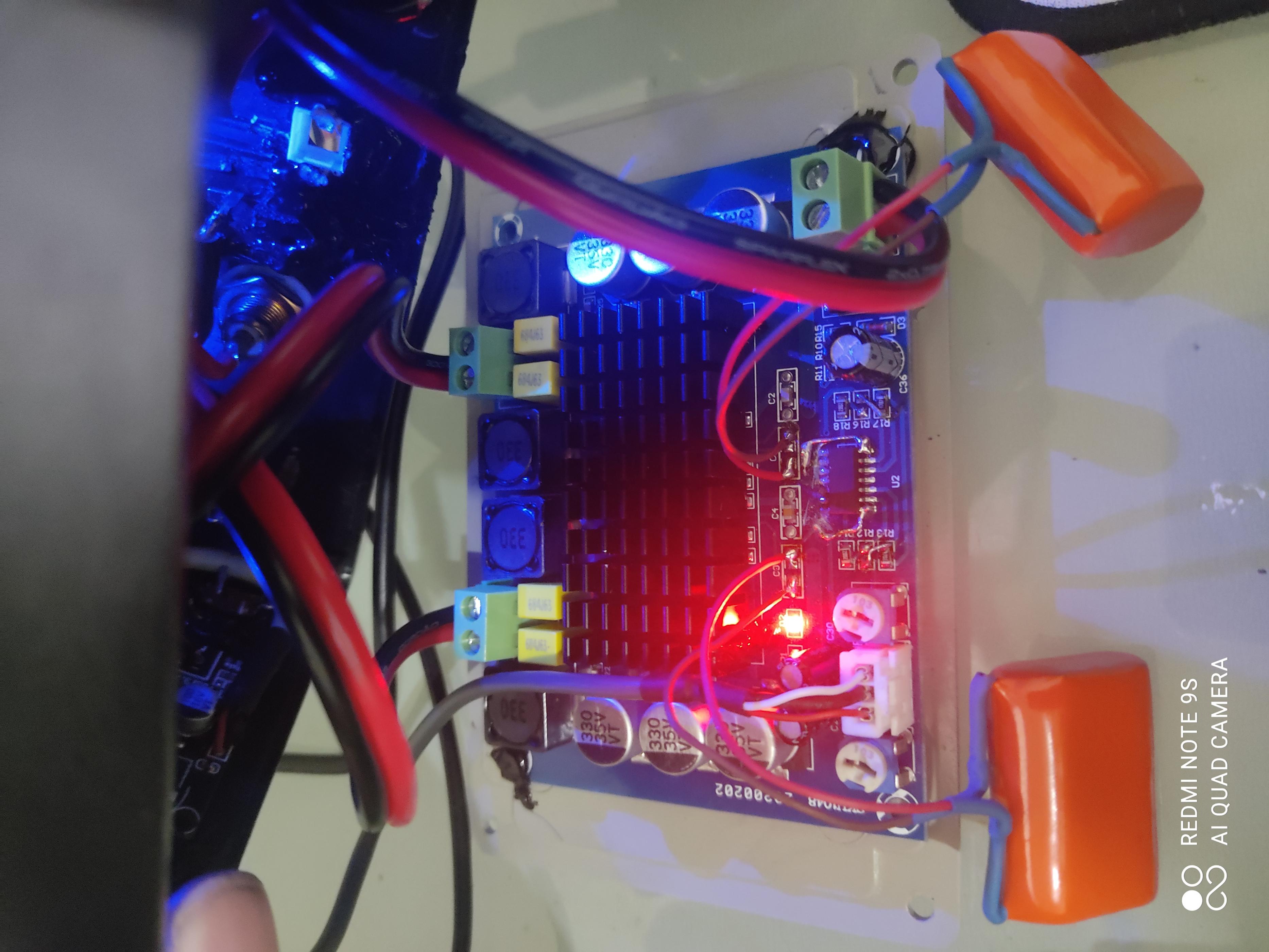

Greetings to all, in the holes 2 Panasonic FM 1000uF 35v, C6 and C9 are input capacitors and I put Panasonic ECWFE 2,2uF 450v interchangeable. I can't find the function and value of the other components to modify Zobel filter. The gain is quite low, I have to identify the resistance to try to raise the gain a little. Anyone familiar with this board can answer, thank you.
R2/R3 sets the gain of the amp. I think they are 100k/20K on your board. That makes for 26dB gain. Check page 14 of datasheet. You have options for 20dB (lower than now), 26dB which you have now, and louder for 32dB and 36dB. For 32dB you need R2 100K so you don't change that, and R3 39K. So you only replace R3 with 39K for extra 6dB. If you want to go for max 36dB you replace R2 with 75K and R3 with 47K. But input impedance decreases to 9K from 30K which you now have. So you need to up the value of input capacitors C6/C9 to 3.3uF/4.7uF so you don't loose any bass.
Check schematic from page 26 from datasheet, your amp should be the one in the upper part of the schematic. Check the pin numbers and follow the traces to find the parts you want to replace.
Keep in mind that this small board does not have any output filter. I don't see any inductors. They are the 10uH value in the datasheet schematic, with 680nF capacitors to ground. Your board completely misses that, and I wouldn't use it like this. Replacing the input capacitors with same value does almost nothing quality, even if you use 100$ capacitors since you don't have an output filter. That is the best improvement you can do to this board.

Hey everyone!
So, after a while using the simple 3116 board I was before, I decided to gift myself a "better one".
Well, while this one does look better (for not much value), there were definitely more issues than the simple board I had before.
After searching, I found out the board I currently own is a version of the XH-M543, mine doesn't have the screws for the heatsink.
Gladly, I found CyberPit's modifications for another similar version of this board and have attempted some of them. That is bypassing the pre-amp and that has fixed the standby hiss and even decreased a bit of the humming noise created by my bluetooth module.
I also followed the Board guide in which suggested 4.7uF capacitors for the Input signal (They're really big, 250V ones...I thought they'd be smaller since I can't really get good quality components without breaking the bank where I live)
Now, I have a few questions regarding this (I am a beginner in electronics):
I noticed that, after the changes I've made the sound became "warm". It's not bad, there is currently little to no distortion even at full volume, but it feels like the bass in not very present. Lower frequencies are finally playing now, but punch bass (and the lower frequencies) are a bit weak.

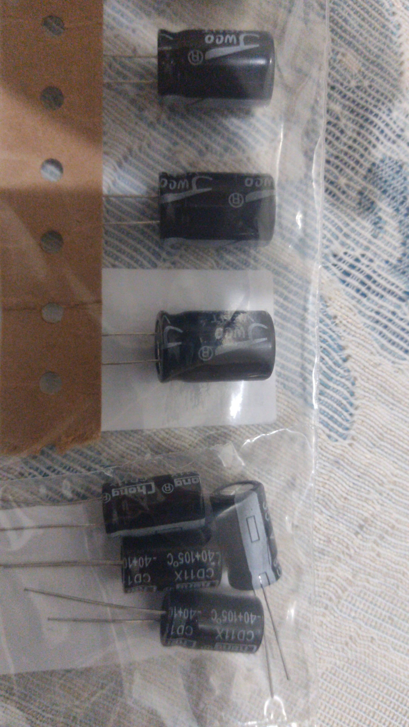

I have some other capacitors in which are the same values recommended in the board guide. I know they're not high quality caps...
Would it be beneficial to change the board Input DC caps for the ones I got? If yes, which one of them?
I have 4 of each:
- 470uF 35V from Chong
- 2200uF 25V from Jwco
This board has 6 330uF 35V metal SMD caps, and since I only own 4 of each above, would I be able to just add 4 (of one of the values) and remove 2 of the current 330uF, leaving those points without it? Or is there any other way around I could improve this?
I also plan on adding the mute circuit he made in the future, as the popping is really loud...

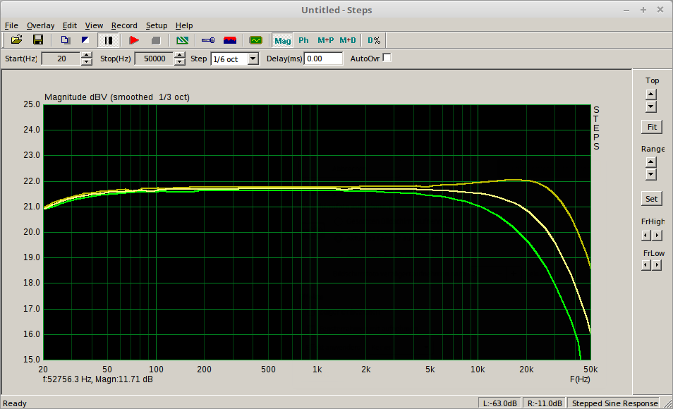

Let us do the math. Suppose L=10uH and C=1uF
Fres = 1/2*pi*sqrt(L*C) = 1MHz/2*pi*sqrt(10) = 50kHz.
The resistor for critical damping is
R = sqrt(L/C) =3.2 Ohms.
These numbers tell us:
1.Damping with 100R will make no significant diffence
2. For perfect critical damping a resistor of 3.2 Ohms is required - and this is a real resistor measured at Fres, i.e. at 50kHz. In reality no speaker has such a low and real impedance at 50kHz - and that means the speaker does not contribute to significant damping at all. You may omit it as well, no harm to be expected.
Another conclusion is that these frequency plots published by TI and other certainly use low inductance dummy loads achieving their frequency plots at rated impedance under laboratory conditions.
After all it would be closer to reality to measure unloaded output - which is avoided for obvious reasons.

Following the numbers the proposed snubbers are either without effect or will burn in case of resonance excitation.
All this can be avoided by a proper post-feedback circuit.
The resulting frequency response of my approach with 5R, 10R and no load, without any snubbers is documented at this plot.
Good work bucks bunny. My point is that the stimulation is not a steady signal but rather a "one-off" type, like if you expose the LC circuit to a voltage step. As you seem very skilled in simulation, try comparing the time-dependent voltage across the capacitor for a series-resonant circuit with and without 100 Ohm across the capacitor. Try eventually with a 12V step.
