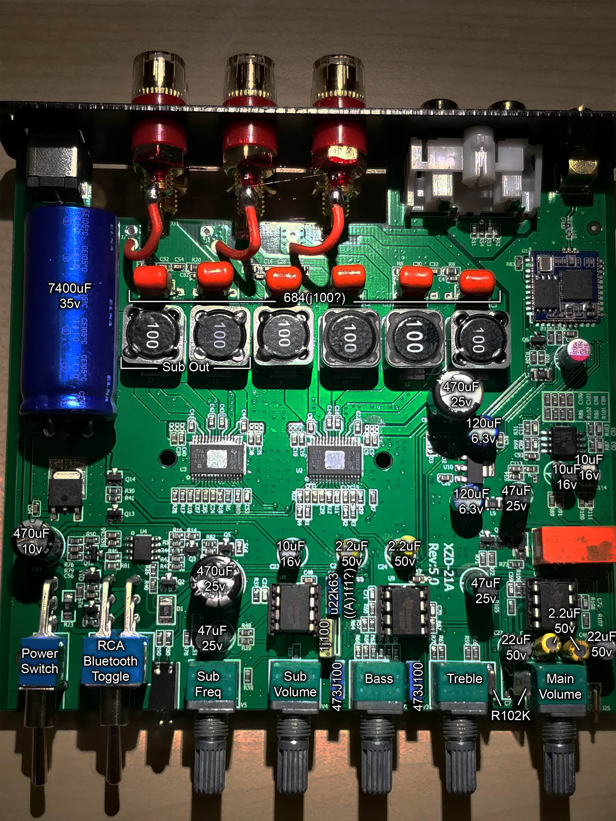

Hey yall, new user here. I've got an Aiyima A03 (TPA3116d2 x 2, 2.1 setup) and found the subwoofer output to be underwhelming in volume and extension. I've looked around a ton, and found some 4.7uF (or higher) input cap mods help out to get deeper bass, as well as changing out some output caps.
I've done some research and noted all caps on the board (See attached file). It seems like the input cap for the subwoofer channel is already a 10uF cap. The output is still the default .68uF cap. I was thinking of swapping them to a WIMA MKS4 since the MKP4 is too big to fit. This leads me to a couple of questions, since I'm completely new to (modding) amp circuitry:
1) Can someone confirm my findings on the board regarding the input filter and output filters are correct?
2) Would swapping out the 684's to 1uF indeed help with outputting deeper bass?
3) Would I need to change anything else on the board if I want to swap these caps?
Of course, any other input or help would be appreciated!

The image attached is a photo (not take by me, but same board) with all the caps marked with their specs.

The output filter is a low pass filter so it affects the highs. I wouldn't worry about it, there's nothing to gain for bass. The output filter you can adjust depending on the impedance of your speakers, but it would matter for the highs. Theoretically you should have the output filter adjusted depending on the impedance of your speaker. That one size fits all is usually a good enough compromise for most speakers.
The input filter (that 10uF cap + input impedance of the tpa3116) is what would eat into the bass. But with 10uF I don't think there's any problem there as even on the lowest impedance of the chip input (9k) the 10uF is still allowing for all the bass to go into the chip. For the highs it's opposite to the bass. The input filter does nothing but the output one matters.
Maybe the input opamps stuff? But I see you have a bass adjustment.
What subwoofer are you trying to power? What specs does it have? The tpa3116 is an "up to 100W" for a 2 ohm load. No way to get there for an 8 ohm sub. You get around 50W of cleanish power into 4 ohm speakers, in PBTL mode.
Did you ever power that sub with another amp? Was it more rewarding? Did you try to position the sub differently?

Thanks for your response! A quick on eat that
You make good points. No real hope for the input and output caps.
There are 2 knobs for the bass. One adjusts the frequency cutoff / crossover, the other the volume.
The woofers I have tried are a Rockford Fosgate RFZ3412 Punch Z 12 An old car subwoofer. Not the greatest usecase, but it should work. It's in a smaller sealed enclosure. I'd guess around 30L, around the recommended size according to its specsheet. The specs are the following:
- 4 ohm
- 150w RMS
- 90dB at 1 watt
- Freq Response of 25-200 Hz
It sounded way better in the car. I used a JVC DR3004 to power it with 180w (bridged mode). It's still attached, but I have no real way to power it atm (I don't have a 12v power supply)
Aside from that, I've also paired up the subwoofer from the Logitech Z623. I can't find any real specs of the subwoofer, aside form the RMS, which should be 130 watts.
What I can tell about this woofer, is that it was way louder, fuller and deeper with its own integrated circuit. I just wired it up through its vent port, so I'd think there shouldn't be a real noticeable difference for it's enclosure.

The car subwoofer won't sound good in a room. They are tweaked to work with the small volume of the car/trunk. You shouldn't consider that. They are for car use. Also 4 ohm which means the tpa3116 can at best push 50W into it. That's 1/3 of the subwoofer's power.
The Logitech sub might be a 8ohm sub as I found some info online. You get max 25W or so into it from the tpa3116. You could confirm that by measuring the resistance of the sub with a multimeter.
Also, for 100W into 2ohm with a 26V supply it needs to output 4A only for the subwoofer.
The opamp circuit could mess things up a bit but I think it's used as a filter/buffer for the subwoofer controls.
You're best to find a 2ohm subwoofer if you want the max power out of the tpa3116 but 2ohm subs are more for cars.
That logitech sub is pretty ok at 8ohm/130W, I think someone said it's a 200W sub but driven at 130W max with the logitech amp inside it. So I would just get a 150-200W amp for that sub, that can drive 150-200W into 8ohms. I'd look for a class D design so it's somewhat compact considering the power supply as well.

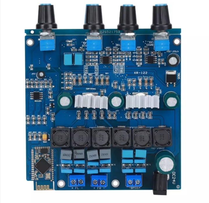

I really need some advice. I bought a TPA3116 amp from Banggood called Wuzhi Audio 2x100W ( 1002 hifi 2x100w tpa3116 ) which I have connected to my Chromecast Audio via the 3.5mm jack.

That is one strange speaker. I think it has two coils on the subwoofer, and has two separate tweeters integrated.
You first need to make sure you don't reverse the +/- connections on the speaker. Doing that would reverse the phase on one of the coils and would cancel eachother out.
I'm not keen on paralleling passive crossovers. I think you'd be better off if you used a 2.1 type tpa3116 amp wired this way. the two left/right to the tweeters, and the .1 subwoofer connection to the SW connection but you need to rip the wires from the passive crossover and wire them in parallel. You also need to take the +/- into account and not reverse them.
I showed here in pink the subwoofer connections:
With a 2.1 board you could go even further and limit the frequency from the input caps. You put 100nF instead of 1uF-2.2uF that they come with, so as to limit the bass going to the two channels. That way you can also bypass the passive crossover on the speaker, completely. You can take it out physically. The input cap should be adjusted for the input high pass filter so that it gets to the same frequency that the passive crossover is doing on the speaker. Without photos of the backside of the crossover on the speaker it's harder to say how it's wired up, to derive the crossover frequency. It's doable but needs some extra work.
Another problem is the amp might not need so much gain, so then you up the volume on the chromecast until you hear some distortion, back it up a bit so it's clear, then you use the amplifier knob to raise the volume, see if that sounds better at higher volume.
