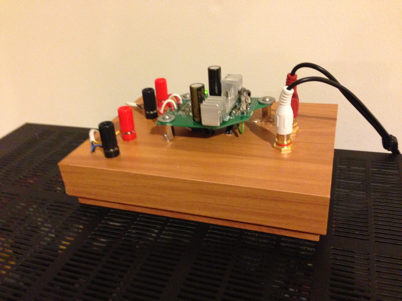

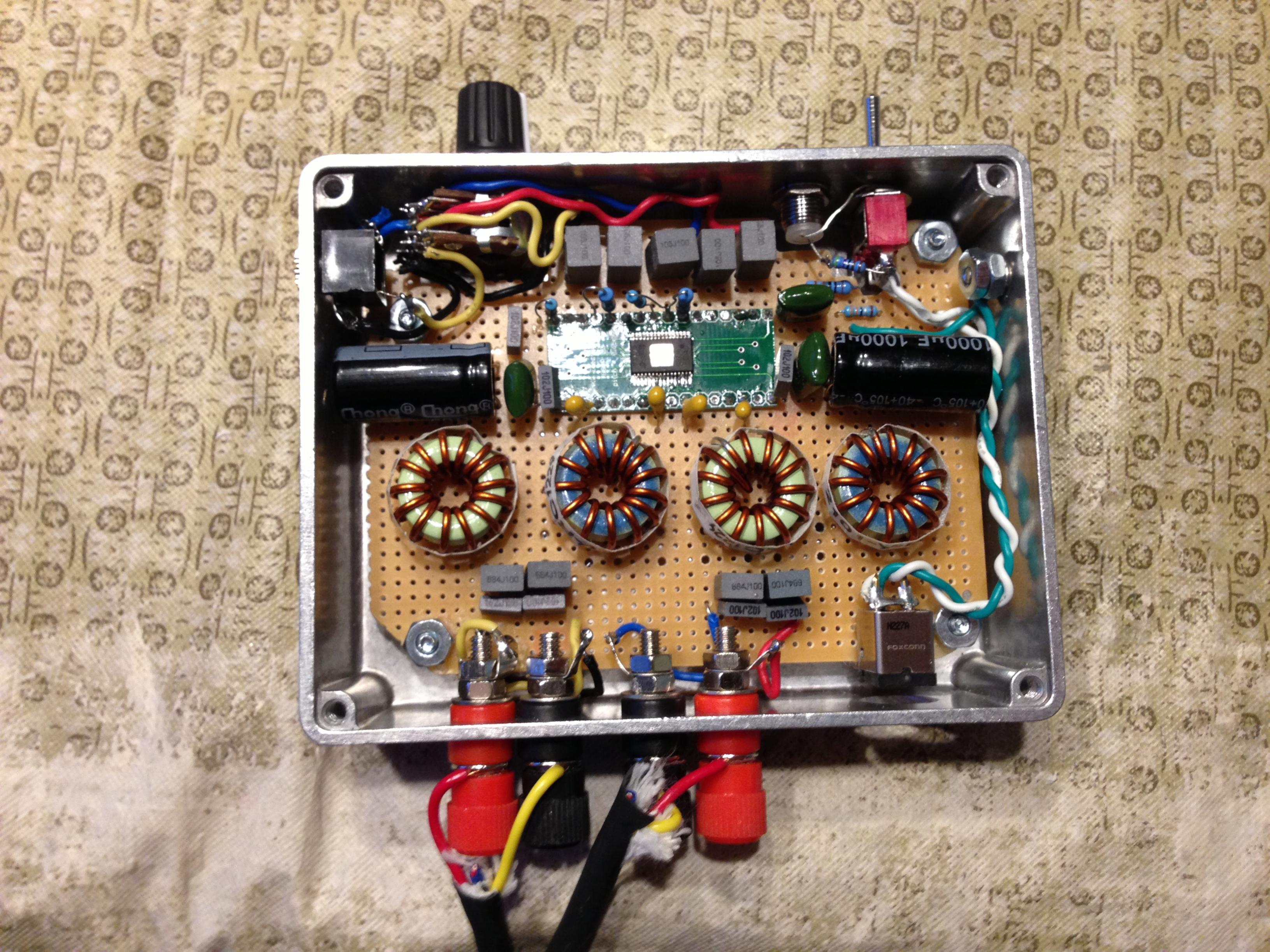

Well, I somehow managed to build my first solid state amp, based on the TPA3116D2 chip. I used the schematic from the data sheet and it works and sounds great. The power supply is a 130 watt Dell laptop power brick putting out 19.5V. The chip barely gets hot driving 8 ohm speakers. Thanks to everyone who posts here for their ideas and inspiration, especially xrk971 and his great amp, that thread is what pushed me from building a chip amp to a cheaper, high efficiency class D. I scoped the output and the wave is smooth, into a resistive load you can barely see the switching on top of the sine wave. The purpose of the amp is to have something portable to take with me to the garage, basement, etc and it fits the bill quite nicely.
The only problem I ran into was with the output capacitors, I originally had cheap 50V caps in and they quickly smoked without a speaker load. I replaced them with the square 100V caps and all is well. I don't plan on running it without a load but it has to survive at least for a little while if a speaker wire pulls out or isn't connected.

I am the Audio Apps Manager at TI, and I'd like to congratulate you on a nice looking amplifier!
I suspect the reason that your output caps blew up without a load is due to a high voltage oscillation that will occur with an LC filter with no load. The load is part of the filter response, so when you remove it, you can get huge oscillations. See this app note for more info on LC filters: http://www.ti.com/lit/an/sloa119a/sloa119a.pdf
I noticed that you didn't use a heat sink... Under heavy load, this will result in thermal shutdown. You can easily add some metal to heat sink it, or you can switch to the TPA3118D2 which has a PowerPAD(tm) which allows you to solder the thermal pad on the bottom to your PCB so the PCB acts as a heat sink. But, with your design, the PCB is pretty small, so I'd probably just add an external heat sink.

Thanks for the comments! I was wondering about the heat sink, the chip doesn't run hot or go into thermal shut down, even after extended use. My speakers are 8 ohm so that limits the power output. After two hours of loud running the stomp box is barely warm to the touch.
I wasn't comfortable soldering directly to the chip and because I was worried the heat required to get the solder to melt to a heat sink might damage the chip. I was also worried the heat would melt the contacts with the board.
Due to the tight layout and didn't see a good way to clamp a heat sink to the chip. In retrospect it would have been easier to solder the heat sink on the chip first, then mount it. The thing to do would be as you suggested to mount an aluminum or copper piece to the bottom plate that would contact the top of the chip. I like your idea of using copper pipe section. I'll get right on that.
The funny thing is, soldering the chip to the board was by far the easiest part of the build. The board came pre tinned, all I had to do was put some jell flux on the legs and a half second touch with a chisel tip soldering iron, it was over in 10 minutes. The board was very reasonably priced.

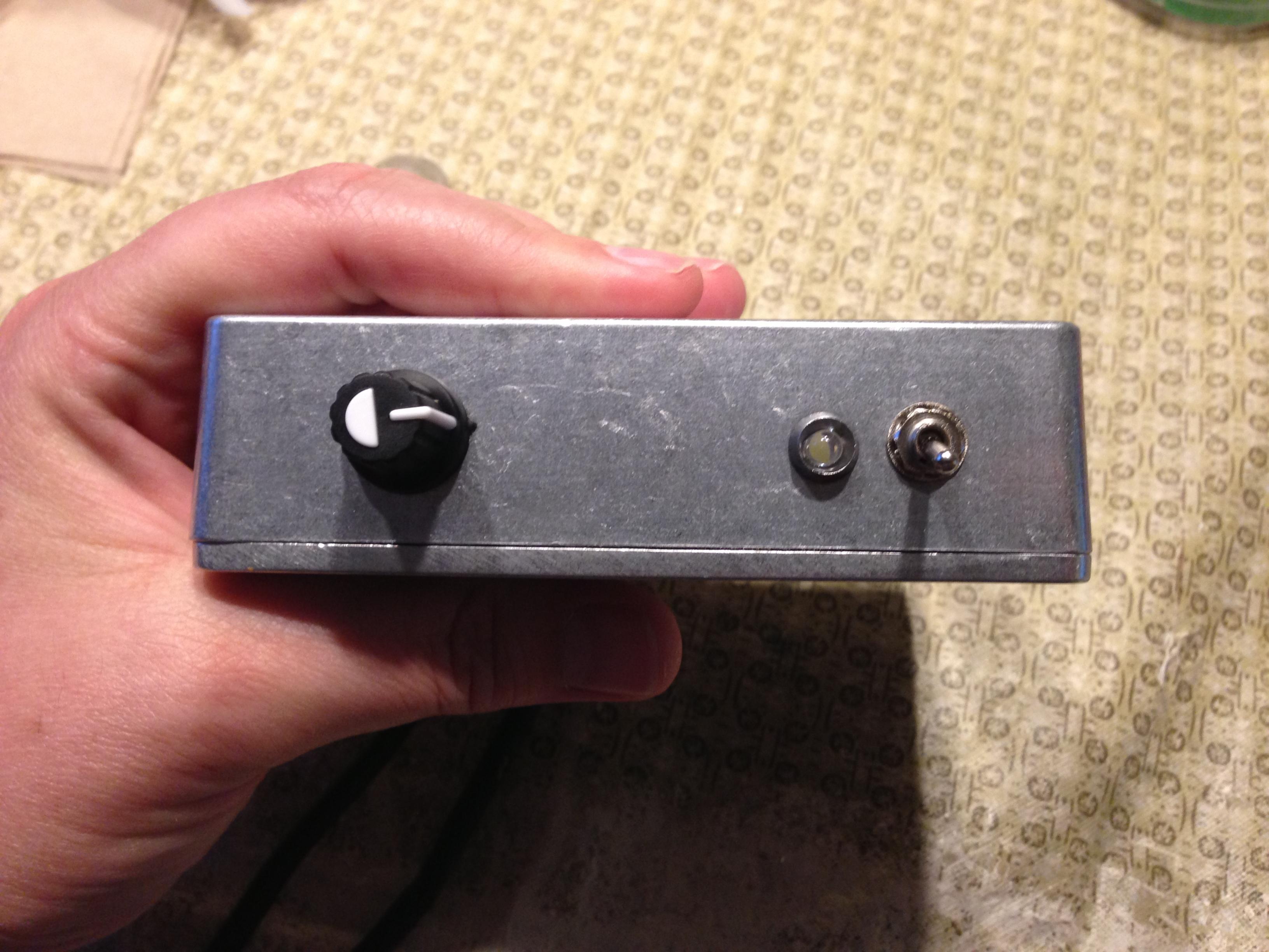

The hardest part of the build was getting everything to fit into a stomp box case. I was looking for the lowest cost and got most of my components from Tayda Electronics.
I did go with upgraded inductors. That seemed like a place you didn't want to scrimp.

When I was working on the output section I was going to add a C-RC filter, I added a 1nF snubb to the 680nF on the LC and liked what it did to the output. I stopped there because I'm happy with the sound.
I was afraid the cheap laptop power supply would be saggy so I added the biggest capacitors that would fit. At 100 Hz full power I was seeing almost no effect on the power supply voltage. The bass thumps, again tight, so I stopped there.

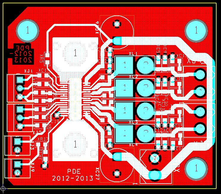

I was fortunate that I designed a pcb for the 3116 and it had a good ground plane under it. I know that xrk971 built his first one "in air" and got good results with it but IMHO class d needs a good ground plane. Just a thought for your oscillation issue.
