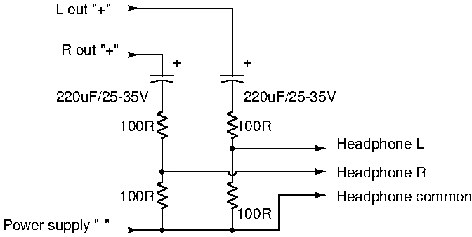

Can a head phone jack be connected to the board ?

You can connect a head phone jack BUT you then need to use two dummy loads (6 Ohm or so) at the output terminals. You may ruin a class D amplifier by operating it without a normal impedance at the output. The output impedance serves as damping of the output filter resonance.

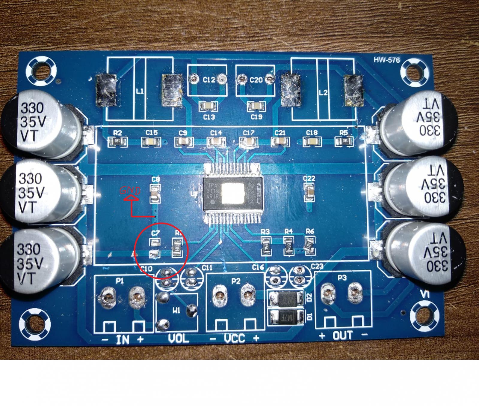

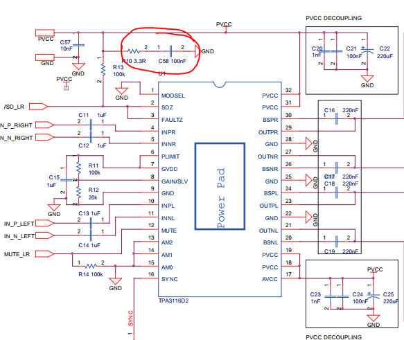

While prying off the heatsink I ripped an smd capacitor off.
The capacitor connects to ground on one side and through a 100k resistor to pin 2 and 3 on the other.
I believe it must be C58 in the datasheet schematic. Can anyone confirm that this is indeed so?
My impression is that it rather corresponds to C20, C21 or C57 on the schematic. A power rail decoupling capacitor.
I believe that C8/C22 on my board are supposed to be the PVCC decoupling blocks on the schematic.
It could very well be C57 in the schematic though.
It might worth a try to add all the decoupling caps according to the schematic to this board
Yes but it's not critical to operation. It would be good if you could replace it. It's there to filter noise on the power rail for pins 2/3.

Could you show me a schematic as how to connect a head phone jack to the board please ?? And do I need to rewire the head phone to have a 4 wire input plug ?
Can safely ignore it.

Thankyou for the schematic, it is NEVER too late, my friend.
Do I connect the speakers to the same board the same ?
Can I use the schematic on my T amp ( TA 2024 ) ?
You need to connect two dummy power resistors (proposed 6 Ohm) at the two regular speaker outputs when you use the headphone.
This headphone schematic can be used on any class D amplifier with BTL output and a single supply voltage. The voltage rating of the 220uF capacitors needs to be at least the supply voltage. For TA2024, you can use 16V or higher.
