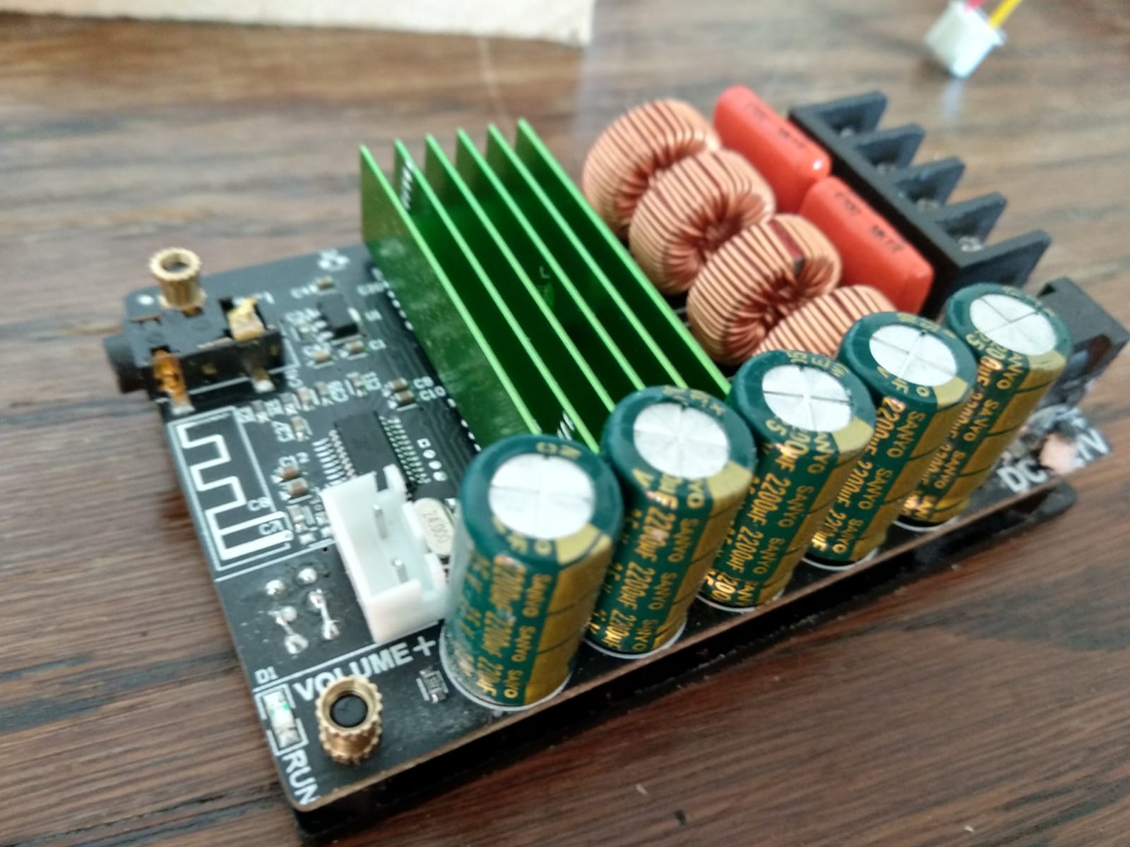

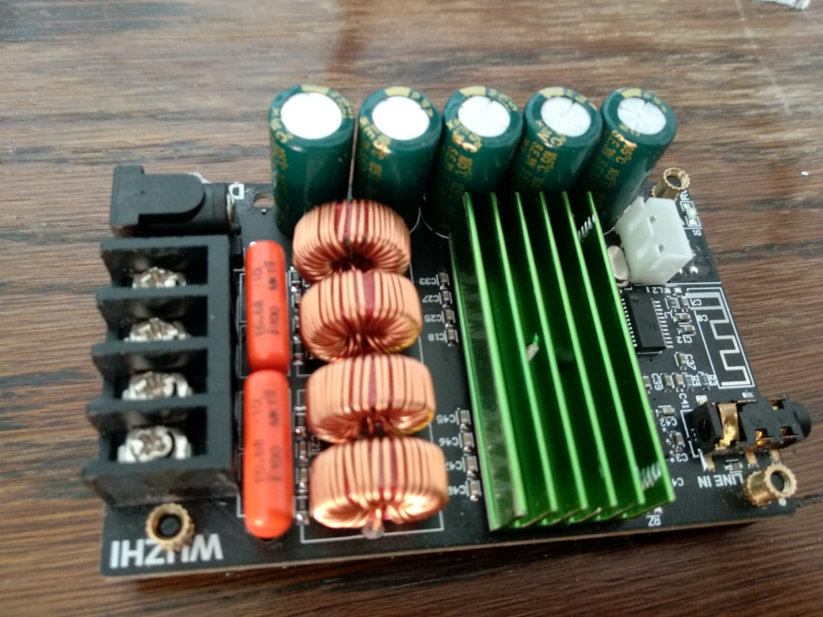

Quoting myself because I've found the solution, and implemented some changes that make this amp sound very good. Even the bluetooth doesn't degrade the sound quality as far as I can hear!

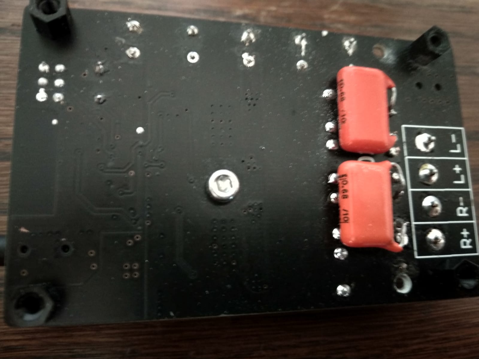

The problem with the volume knob is that it is too close to the bluetooth antenna. Also it is a shitty pot, so I removed it and shorted the pot input/output pins on the board. Because the pot also doubles as on/off switch, so I made a connector socket it's place and wired a connector to a switch.
I swapped out the 470uF power supply filter capacitors for 35v 2200uF ones. That made an enormous improvement in sound quality!
I also changed the output filter caps for locally sourced MKT ones. They are way too big to fit so I had to put 2 on the bottom side. Next time I'll take 68v rated caps with a lead spacing of 5mm.
I've have yet to find a decent way of wiring a volume pot external from the board. I think it'll need a NE5532 buffer or at least some bigger input capacitors for that. Right now it is of no concern for me.
There is no on/off plop. There is a little hiss when I connect my phone through the aux port. I have tried the 4k7 resistors to ground but that made no difference.
Using bluetooth the amp has no hiss at all.
It's not the best module around the 10eu point but I haven't had one with bluetooth that sounded good for that price
