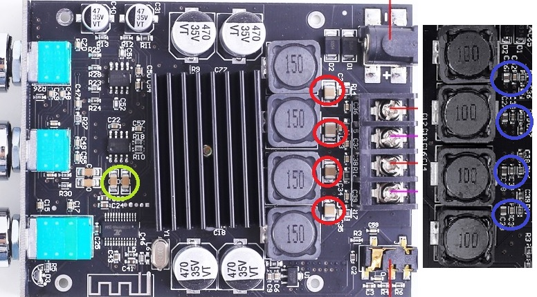

from my board exists a dual TPA3116 version, that has 15mH coils and much bigger caps on output filter (at least the physical size is bigger)
are these just bigger because of 15mH coils?
red one the "big" output caps
green one some "smaller" input caps i replaced by 1µf foil caps
blue one the output caps on my board.
how do i know (how does it sound) when the output caps are to "small"?
im using 6 ohm speakers (if that matters) and the board has 10mH coils
the TI datasheet says 0.68µf for 10mH coils
and just in case they are to small, could i just add some 0.33µf foil caps (which could fit there) in parallel to increase the capacity a bit?

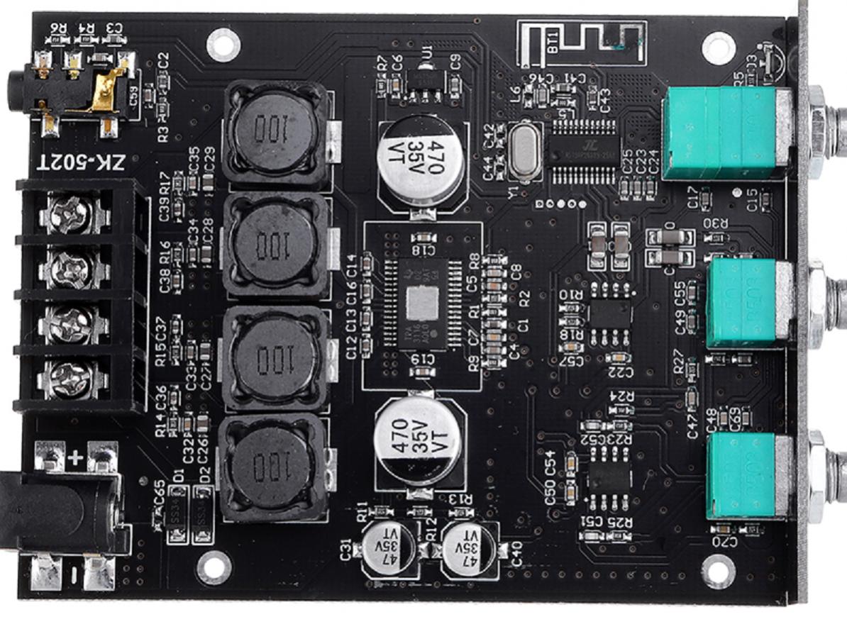

I think that is not related to bluetooth. I have the ZK-502T and i can turn the volume pot without any noise or speaker "movement" but i think that is related to the 2 opamps i have onboard which are missing on the ZK without bass/treble pots

Since you have two channels, you need to add two capacitors, one for each channel negative input to ground (for tpa3116 chip).

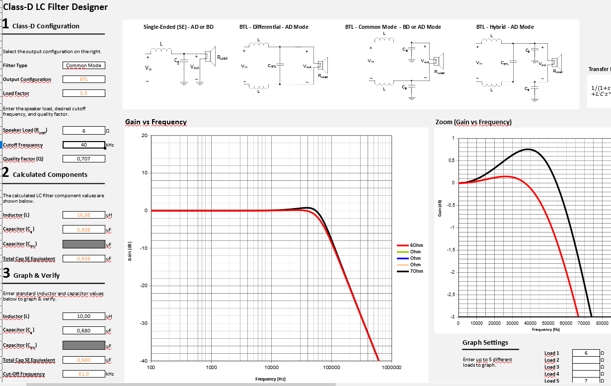

You need to measure both left/right channels traces to each cap, and be sure what cap is what channel, and if on positive or negative inputs. Space seems pretty tight there and you risk shorting stuff out to the heatsink. Hope you can pull it off if you want to replace them.
Input capacitors make a high pass filter with the input impedance. For 20db gain the tpa3116 chip has a 60Kohm input impedance. 1uF should be fine to not loose bass.
Output inductors + capacitors make a low pass filter, and if the values are not right, you can loose some of the highs.
Here's a simulation for a 6 ohm speaker with 10uH and 15uH inductors. Variable capacitance. Lower right you can see the best value for the most linear response. I put the cursor on the most linear trace (value for output capacitor).
10uH inductors is around 674nF so 680nF value is perfect.
For 15uH inductors you need around 1uF output capacitance:

Also for reference the simulation has 8 steps with values from 470nF to 1.3uF or so, to get an idea on how it varies.
I also made a sim for 33uH output inductors since many of the cheaper boards (including the ones I got) come with 33uH inductors. They really eat into your highs. 1.3uF is the highest trace and 470nF is the lowest one. So 33uH + 680nF on a 8ohm speaker is not so great. On lower impedance speakers it's even worse.

I measured r from the speakers (but i guess that is variable when they are used) which gives me roundabout 7ohm...but the sticker on Speakers say 6Ohm.
i was playing around with these TI filter calc sheet ( https://www.ti.com/tool/LCFILTER-CALC-TOOL )
but im not sure what filter type i need to choose (i choosed BTL-Common Mode BD or AD Mode)

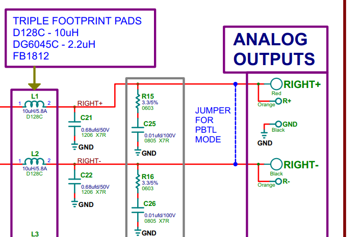

on my board the cap stuff around the coils look also more "complicated" than on TI 3116 evaluation board.

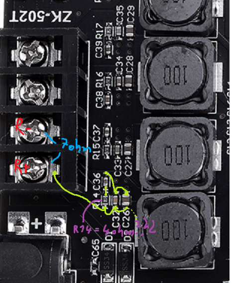

But im not 100% sure that i correctly measured all traces cos my multimeter say the batteries need to be charged and im currently not able to reach the "-" caps cos there is some DC filtering caps glued

i don't understand what the R14 is doing there? (cant find that in TI Datasheets - edith says: ok i've found it 😛 )
hm most likely that is R15 from evaluation board 😎
but why are there 3 caps used?
so my conclusion is to have to low caps will start eliminating the treble from 10khz (on 6 Ohm load and 10µH coils).
To have to "high" coils will move that point below 10khz (e.g. in case coils are 33µH for 6 Ohm).
To have to "low" (or even no) coils will leave HF signal with your speaker wires as antenna (and probably speakers wont like that???).
To have to high caps (e.g. >=1µf) will bump up amplification of hearable treble slightly but the one >=20khz by a bunch of DB.

I used Simetrix. You can also play with LTSpice.
Here's the official schematic, it checks out.
I suspect the larger one closest to the inductor is the capacitor of interest:
