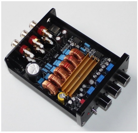

Recommendation for 2.1 speaker system.
Dear All,
First of all, I wish you a Happy New Year!
Some of you could follow my procedure to trying to fix my 2.1 amplifier board that was not successful .
So, I decided to buy another board but I would like to be more careful. I looked for recommendations in this thread but I found only stereo boards: XH-M590 by FauxFrench. In his descriptions and other recommendations, I found an interesting guideline: the simple, basic boards are better than complicated boards with BT functions and/or 2.1 channels, because there are less parts on the simple boards, so easier to fix any problem and there is less chance of failure – this statement is logical and I agree with it. BUT I have a 2.1 speaker system and I want to use it. I think I have two (+1) options:
1) This 2.1 “final” amplifier without BT. This board seems to Breeze 2.1 on the board page. I can imagine it will be OK.

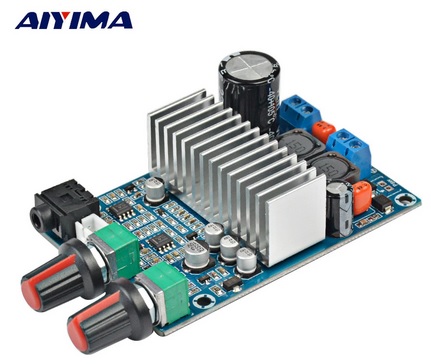

2) XH-M590 + AIYIMA TPA3116 Subwoofer board + I build a common case (3d print).
3) +1: What is your recommendation for 2.1 speaker system?
What is your opinion?

Hi GSC73,1) This 2.1 “final” amplifier without BT. This board seems to Breeze 2.1 on the board page. I can imagine it will be OK.
gsc73
1) has a fixed frequency for the subwoofer, depending on how high that is (usually around 150Hz) it could make the position of the subwoofer audible.
2) you'll need an additional stereo sub for L&R, but you'll have the benefit of being able to adjust the volume of the sub and satellites to make them blend.
3) I've recently assembled this one: Aiyima Gemonteerd Hifi Digitale Versterker TPA3116D2 2.1 High Power Board 12 24V Subwoofer Bass Board|bass board|power amplifiertpa3116d2 2.1 - AliExpress
It works (and sounds!) really well, due to the separate controls for the sub crossover frequency, volume and separate master volume.
Regards, Jan.
